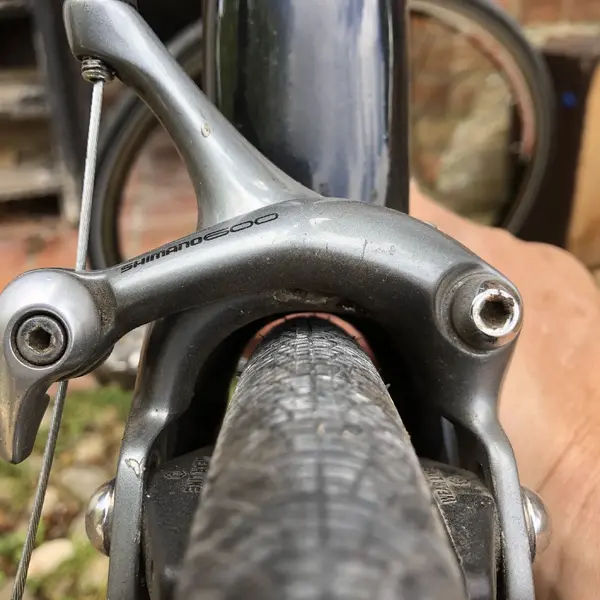

Brakes are Shimano 600 callipers pulled by late 90’s Shimano LX levers.

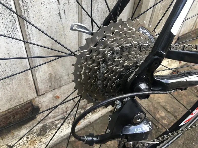

Shimano Sora crankset and rear derailleur original to the bike & useful enough.
Lost the front mech, not needed imo for what I’m using it for, the cassette is 12-36 so lots of range and a nice mid sized 40t stronglight up front.

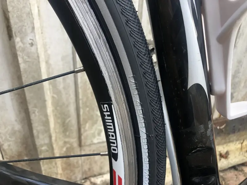

28mm commuter tyres running at 50psi for some more give and grip, run pretty close with about 3mm clearance!

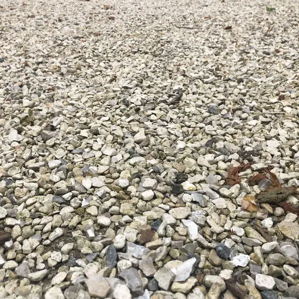

Large gravel

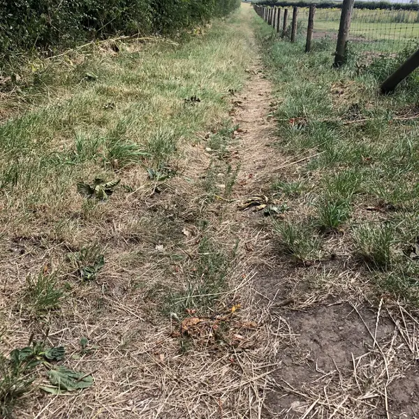

Green lane

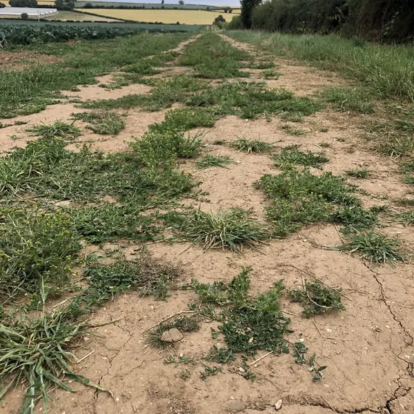

Dirt field apron

Actually, I find that a very interesting build, especially if you're riding over all those different surfaces without too much discomfort on 28 mm tyres. I've just switched back from 28 mm to 32 mm on my road bike because the ride was too rough on the local roads on the 28 mm, so I'm intrigued. (Admittedly, though, the roads are pretty awful around here—quite like that one in your final photo—and I was running 65 PSI or so.)
The stem, for instance: how well does that work? 50 PSI: are the tyres not deforming badly when you're pedalling out of the saddle? Is the frame compliant in the right places or just damn stiff? I haven't got any questions about the 1x set up but I thought Yorkshire was pretty hilly so I guess I find it surprising. I don't think I'd be using that set up here on the Kent Downs: I'm usually thankful for every last gear ratio I've got!

Besides 36t cog to 40t chain ring is a ratio of 1.111r on a bike weighing under 20lbs I don’t think I need anything lower.
The stem? Yeah it works well. I’ve used this on my road bike and although when you first use it you don’t really notice it, that is until you swap it out again and then you really do!

No because of the fag paper tire clearances - any stones or even grit will tear into the tires after being rolled by the frame/ fork
No again because you are using v-brake levers for road brakes (jumpers for goal posts), the cable pull is the same as cantilever, v-brakes will pull too much and the brakes will be wooden
and a final nail in the coffin no for that chain ring - any bouncy bits will throw off the chain mid shift, needs some sort of guide or roller or narrow-widenessnessness
