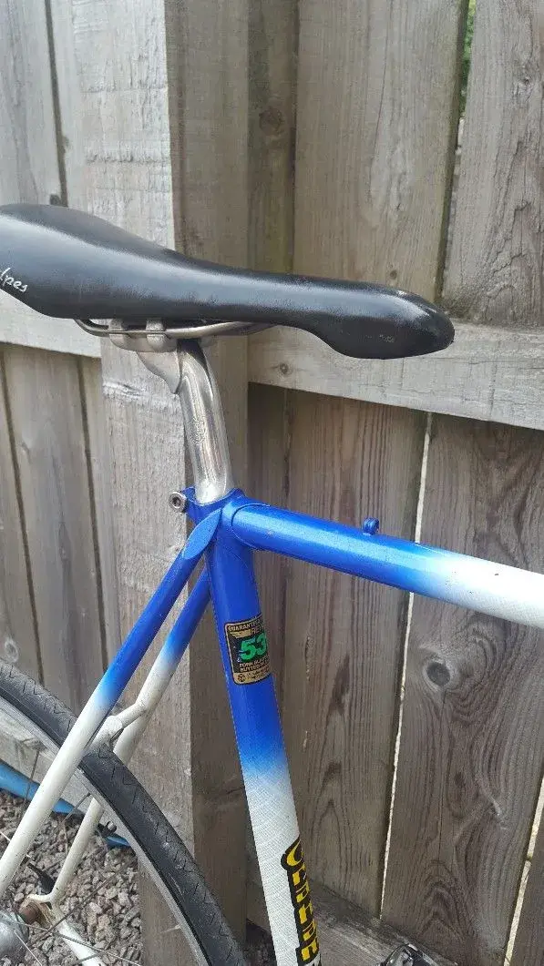

This has just arrived in my shed, a Graham Weigh 531c frame & forks with Campagnolo headset, seat post & rear mech, Stronglight chainset, and Modolo America brakes.
Quite surprised at how light it is for "only" 531c, needs a good clean & polish, and some wheels. I'm actually thinking of turning it into a fixie/single speed.

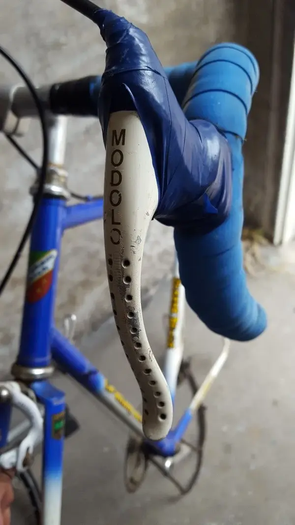

I think it'll look ok once cleaned up, however the brake hoods have been taped up with blue leccy tape, which suggests to me that the rubber hoods are trashed :lol: a quick search hasn't turned up much in the way of replacements... any ideas??
As for dating the frame?? I'll have a look for a serial number, but us anyone able to guesstimate it's age by the decals or components? I'm not overly familiar with road bike bits & pieces.

That's lovely! Same decals as mine, so likely late 80's / early 90's onwards.
531c's terrific, Reynolds decals from that era also. Have two bikes built from it.
Ashley at Graham Weigh will likely advise on the dates (was dead helpful when I was asking).
There are some Modolo levers f/s on here recently I recall.

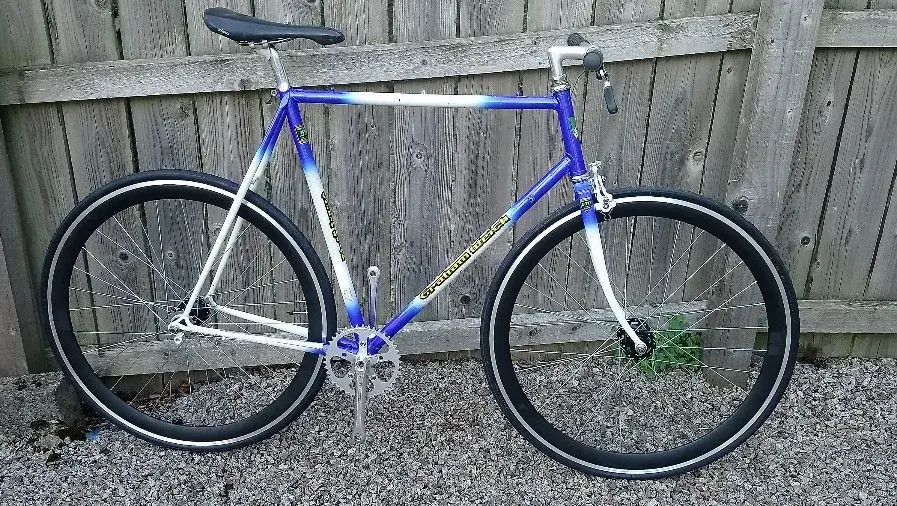

Hmm... flat bar fixie looks like a possibility. Chucked a few parts on it to check the fit and aesthetics.
Bench vise at work made short work of the stuck seatpost :)
Gave it a quick wipe down, looking better, needs some further work on the paint though, the camera makes it look better than it is in real life.
Still not sure about the frame size. Sat on the bike with the seat as per the photo seems fine, reach to the bars and pedals is good, it's just that when I've my feet on the ground the top tube is "danger close" to ones "undercarriage" :lol:
The guy I bought the frame from said he bought it new 20-odd years ago, and he was about the same height as me, certainly no taller.
Is this just how retro road bikes are? Maybe I'm just usrd to the more modern compact road frames :?

Spent a bit of time touching up the paintwork this evening.
Also under the grime is a Campag bottom bracket, in need of a strip down, so I'll do that another day.
Tried my fixed gear wheels on it, I think I like it. It's not a true retro rebuild, more giving an old frame a new lease of life.
