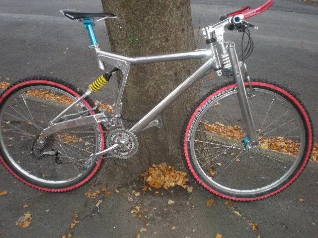

affter much searching for parts for this build and the easy to find ones being the xt shifters the panaracer tyres, specialized body geometry seat, the red chainring bolts and the dmr v12 pedals, the harder to find were the x lite expert bars in blue and the x lite bar ends in red being new and harder to find, the nightmare was the the front elastomers so going down the route of finding a spring to fit and finaly finding a 750lb spring with the aid of the old elastomers as a temporary solution to making the spring fit snug, it actualy works quite well, im 17 stone and there was no bobbing and bouncing i thought may happen and the owner is 12 stone ish so i guess with the new shims to be made instead of the old elastomer shims this bike is going to ride real nice for him, added a couple of pics of the bike as it is now just requiring some new decals to finish.
