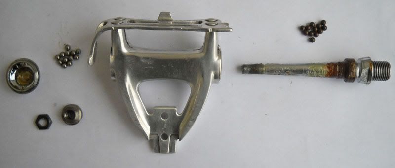

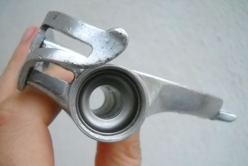

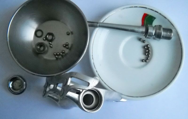

The right pedal had some play do I decided to open it up, clean, re-grease and set those cones right.
You can see how the bearing on the inside are a little dull compared to the ones on the outside. It was in need of readjustment.
You should've seen the mess that came out of this. :lol:

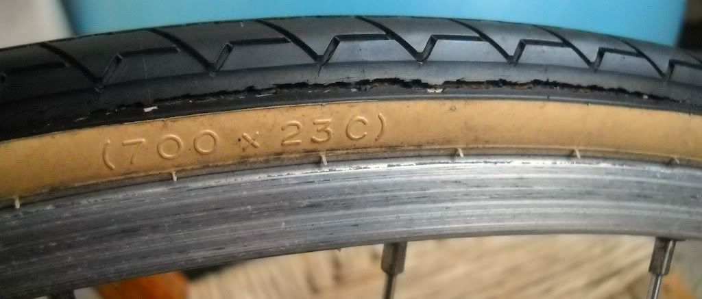

Today I inspected at the front wheel. Campagnolo Lambda Strada rim with a Campagnolo hub.
I was under the impression that the tires were in like new condition but on closer inspection I found this 3 big "cuts". Here's one:
Can it be glued back and still be safe to ride? Probably should just get a new one.

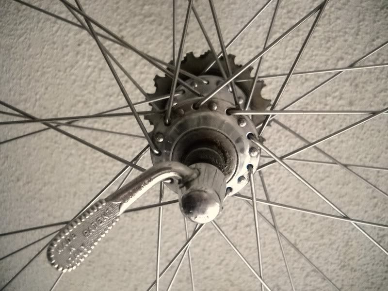

The other surprise was the skewer. Not the proper one but a shimano replacement.
If anyone has a front Campagnolo Athena skewer for sale please let me know. It should look like this:
It's been two weeks of cold and rain. Hardly any natural light to work with. :-p
Did the back wheel this morning. The tire has the same cuts. Apart from a strange noise coming from the hub (have to open it) the rest seems ok. Correct skewer this time and Sachs free wheel.

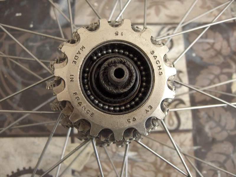

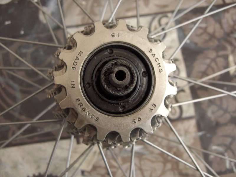

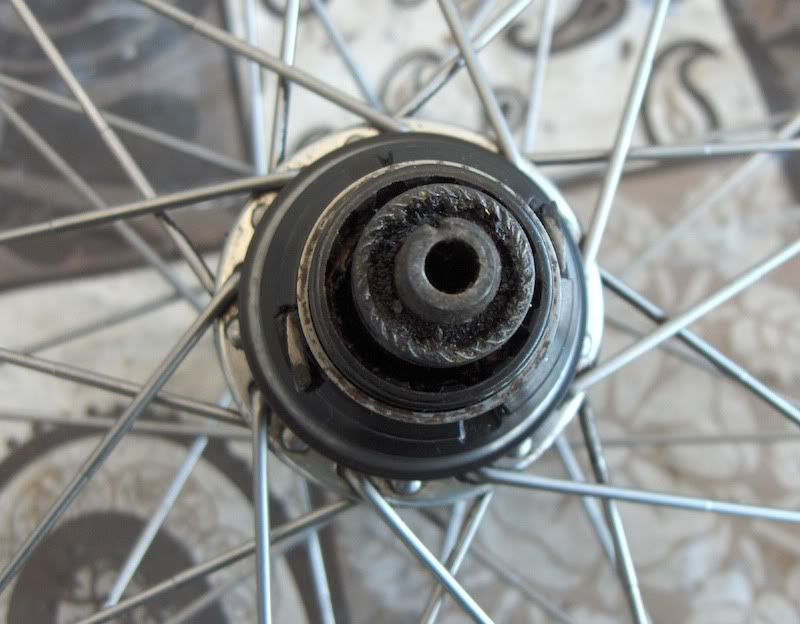

This morning I did the free-wheel. It had some play so I decided to open and check it out.
Carefully removed all those bearings. Put a soft cloth underneath because when you lift the cogs there's going to be a bearings shower.
While I was cleaning the cogs another surprise. This one has 19-18-17-16-16-15. Yes that's right, two 16 tooth cogs... never seen that one before. LOL!!!

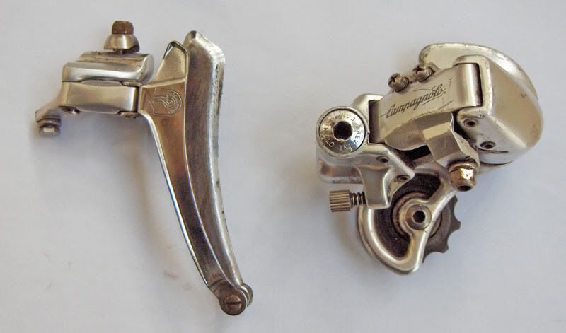

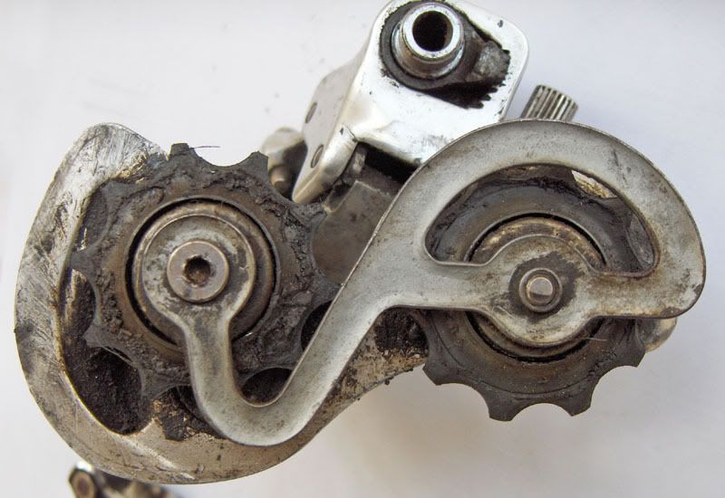

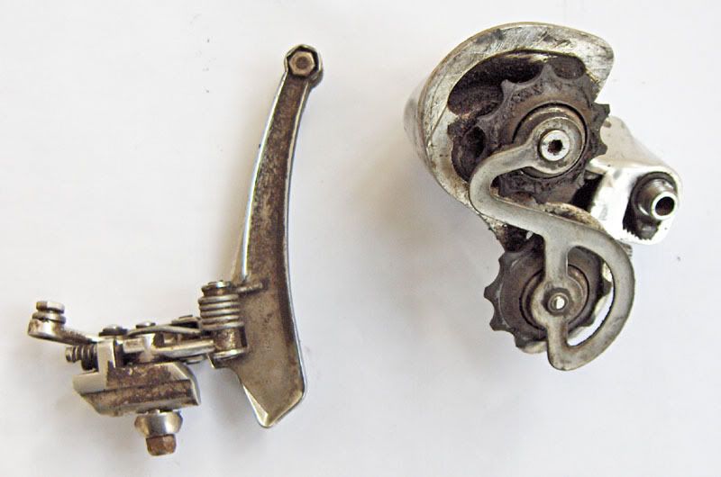

This morning I took the derailleurs off the frame. They seem to be in good condition except for the jockey wheels.
Probably will have to replace those jockeys...

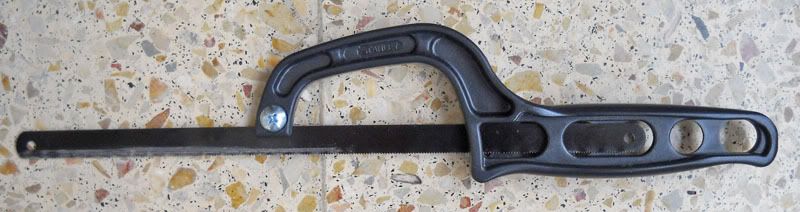

Last try before doing the chemical assault. Got this saw and I'm cutting the stem remains in four parts.
Two cuts done two more to go...
