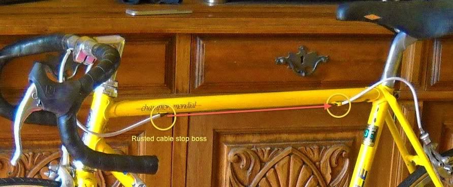

The serial indicates 1986. The Athena is later, so maybe it came on after a refinishing one could think. The graphic style on your bike was issued around the time your frame is from, so that doesn't give a real clue. I am still puzzled by that cable routing however. I looks like it is internal is it?
Here's a close up:

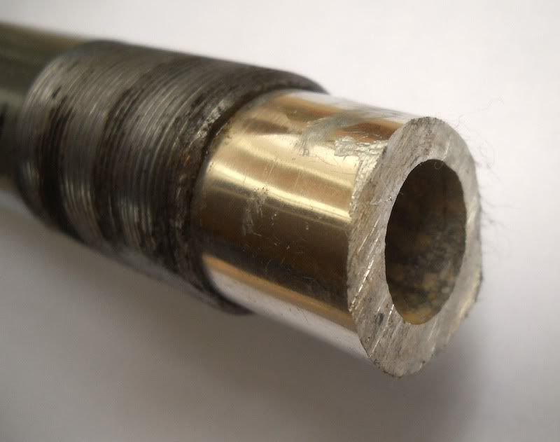

This morning I finally decided to cut the stem. The fork is out and I started cleaning the headset. Lost of solid old grease here.
The steerer seems in good condition.

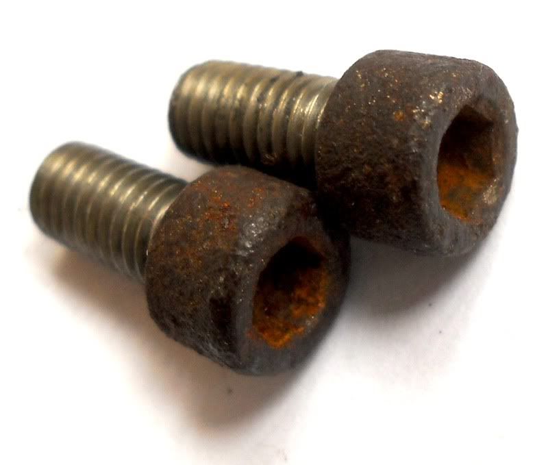

Bottle cage bolts are out for a clean but maybe I'll just get new ones.

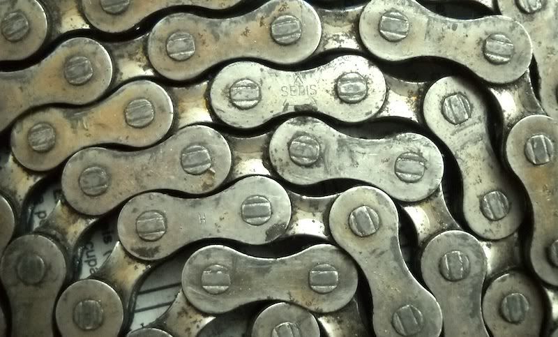

The old chain is out too as it was already too stretched.

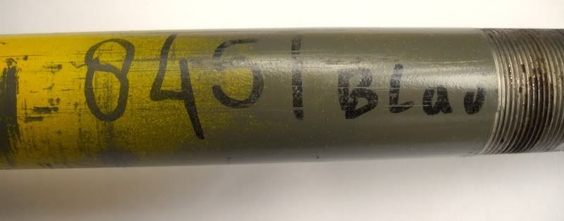

I'm thinking of getting some caustic soda to get me rid of this.
Maybe cut it shorter first but as I never done it before I'm getting some second thoughts. Will it "eat" the steerer paint along with the aluminum? Can I leave the caustic soda with the forks in a plastic bottle or will it "eat" the plastic too? Afterwards what should I do the remaining solution? Flush it down the toilet? Doesn't seem very environment friendly...
