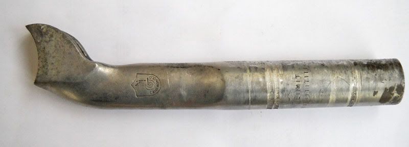

Here's the rest of the seat post. Why would someone do that? :shock:
Trying to make it fit into a smaller tube?
Yes, that doesn't look tidy anymore. You put quite some effort to get everything back to nice condition so far, but with that post you face a new challenge. Good luck :)

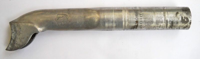

Got read a bit more about aluminum polishing . I think this one can still be saved. :D

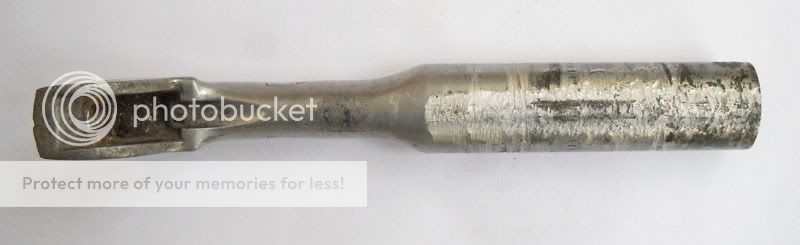

I'm thinking of getting some caustic soda to get me rid of this.
Maybe cut it shorter first but as I never done it before I'm getting some second thoughts. Will it "eat" the steerer paint along with the aluminum? Can I leave the caustic soda with the forks in a plastic bottle or will it "eat" the plastic too? Afterwards what should I do the remaining solution? Flush it down the toilet? Doesn't seem very environment friendly...
I have never had this problem but maybe leave enough alloy stem so you can grip it with "multis" or maybe even grind/file a "flat" on it for a large spanner (if there is enough wall thickness?). If you block that hole off you will be able to pour(penetrating) liquid of some type from the bottom of the quill now
latman" If you block that hole off you will be able to pour(penetrating) liquid of some type from the bottom of the quill now[/quote said:
I did that while the stem was still in one piece but with no results... I'll try the 1st idea. Thanks! 8)
jCymbal":1n5r5pah said:
Back in the old days I've read a tip that you could use a hacksawblade, put the end through the tube and cut it lengthwise, possibly twice at different places. Then first take the smallest part out (presumably with some force) and then the larger part.
