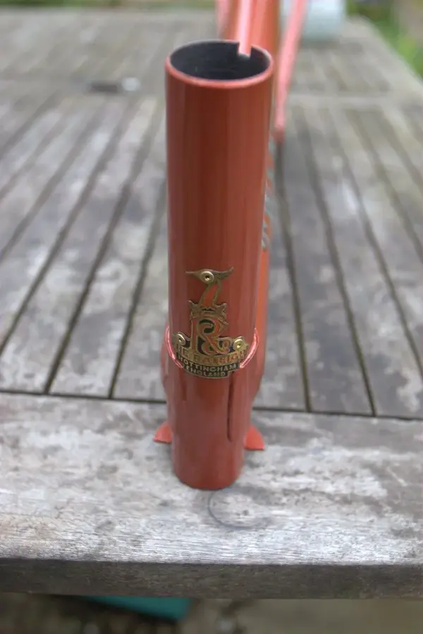

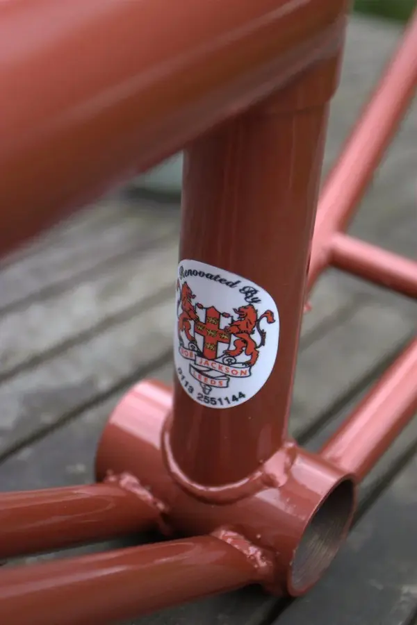

Collected the frame from Bob Jacksons. They agreed with me that they don't get too many Twentys through the door but still a smashing job. I can't capture the metallic in this light very well - a bit early '70s

Love it. Great finish, although I think i would have gone for a really bright red flamboyant, as I remember them in the 70s...

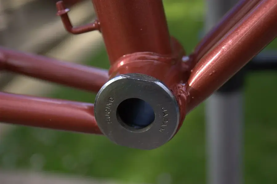

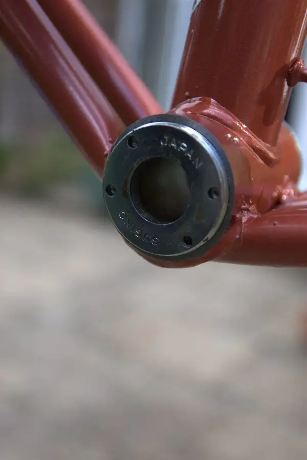

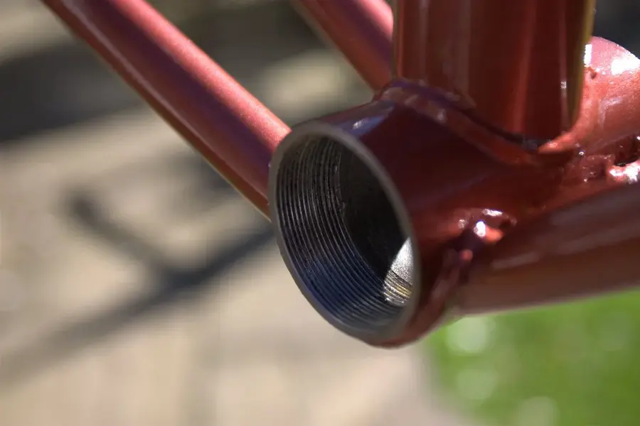

So re-tapping the tricky old bottom bracket shell. Bought a set of taps and cracked on with the job. The Cyclus comes with both British and Italian cutters - easy :wink: 24 tpi threads here we come...
And then to face - I hadn't left these very even with the file. Cyclus facing tool now shows up how uneven the file job was :oops:
Job's a good-un though. The threads certainly look strong enough to me and go in quite a bit further than the old thread. Facing left the shell slightly short but a small spacer behind the fixed cup will do the job just fine.
Big relief :D

Don't get many!? Ha! I'm guessing that this is their first (and maybe last :D )
Looks lovely Gav, nice new shiney paint. Loving the colour too, nice choice.
Good job on the bb shell too, I've seen many discussions regarding what to do about that 'problem' your's almost seems logical.
So how much is that bb tool?
