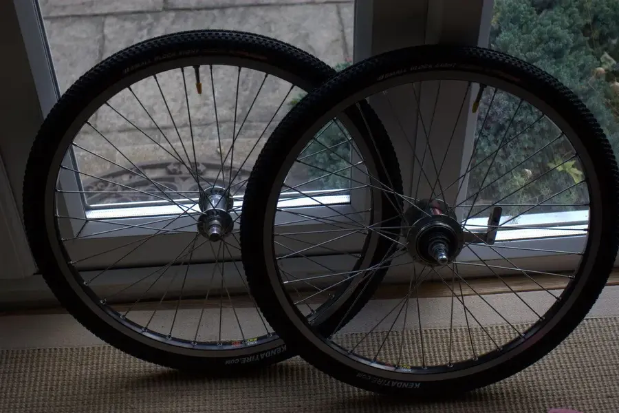

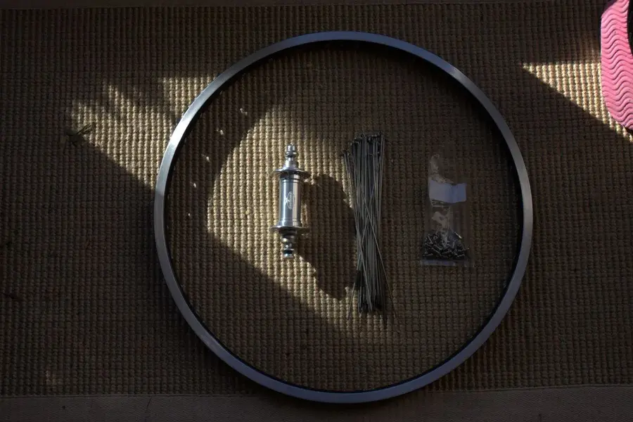

Another wheel update. The front Hope Pro III Mono 36h 2x onto the CR-18. The 208mm spokes were just right but the quality is a bit variable, two spokes in the set had threads that wouldn't take a nipple, one not at all and another very is tight. Fortunately there was an extra in the pack. The wheel is pretty light at a gnats under 800g with the skewer.
Now suited and booted with Continental inner tubes, Presta of course, and Kenda Small Block Eights 20 x 1/38 (37-451). These are light a supposedly pretty fast.
A word of warning I had bought some Conti Contact 2 which are sold as (and marked) 20 x 1 3/8 but are actually 37-406, the Germans don't seem to be bale to do imperial!

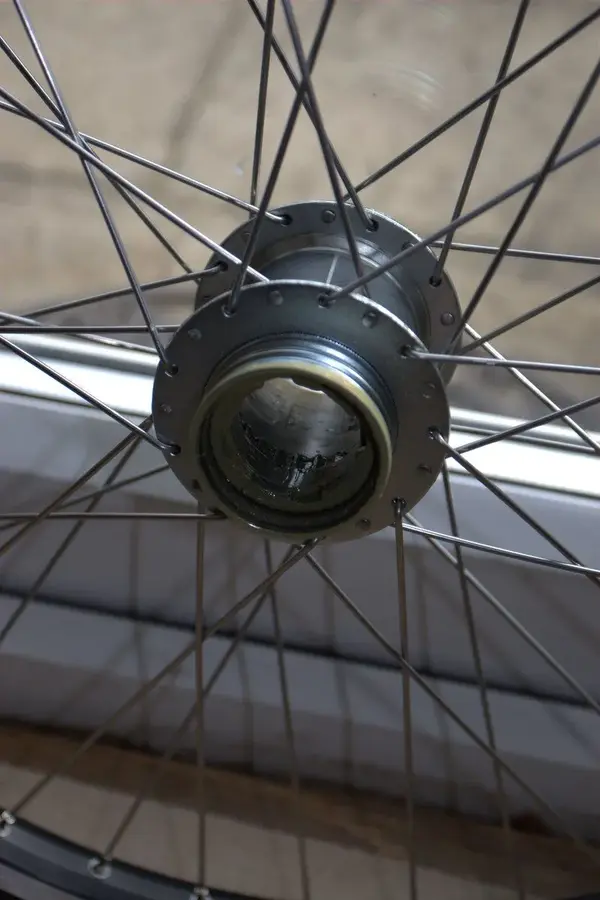

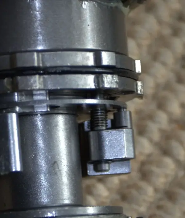

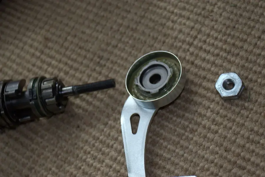

Inside the SRAM Automatix. Unscrewing two 22mm locknuts on the coaster brake side (non-drive side) allows the whole insides to slide out. First thought is that this could be doing with more grease but nice and clean to enable a good look around. Two large pawls in the centre engage the high gear when the spring tension on one of the pawls (zoom) is less than the force exerted by the spinning hub. A beautifully simple design!
As you can see the hub is not sealed so I'll pack some more grease in there to lend a helping hand. I will probably need to adjust the spring tension at some stage but that can wait until the bike is ready.
