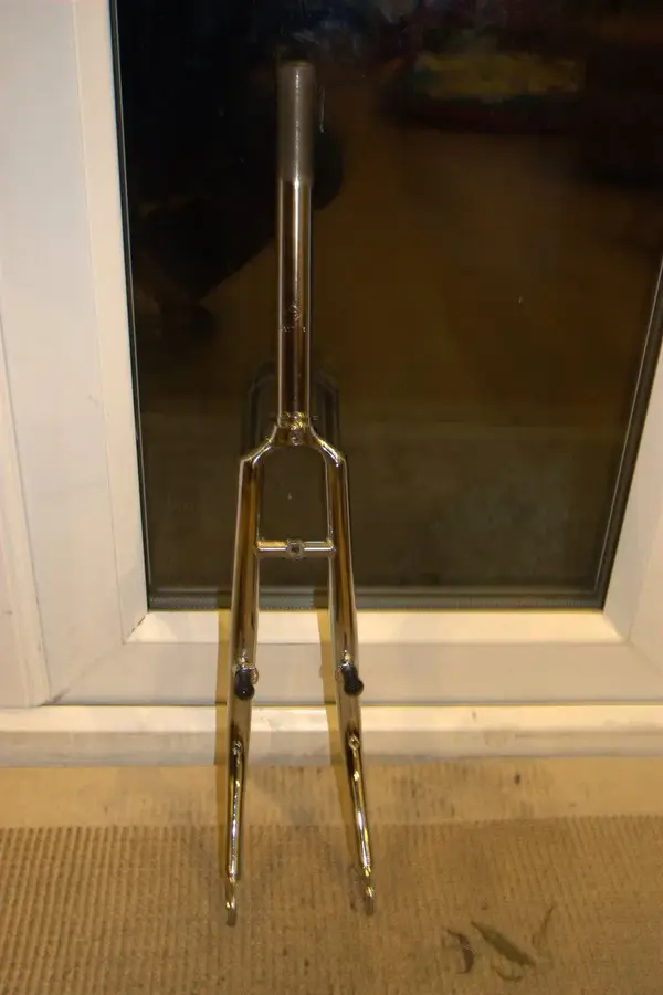

Way hey, just paid the customs charge on the fork today. Hopefully with me later this week - at long, long last. All being well I should have a nice shiny chromed fork that will match perfectly and fit either 451 or 406 rims :D
and on a slow boat from China...
Might even have been worth the wait! Hopefully will get this finished at the weekend now

Great
Looks like the crown race seat is JIS 27.0 mm, not very Californian or even Taiwanese. Luckily I have a spare Shimano 600 headset the right size
Odd but glad you have one.
I had a rummage for those caps and despite not being where I thought they were I did find them.
PM me your address and I'll send them FOC as it's an honour to have them adorn this little beauty!

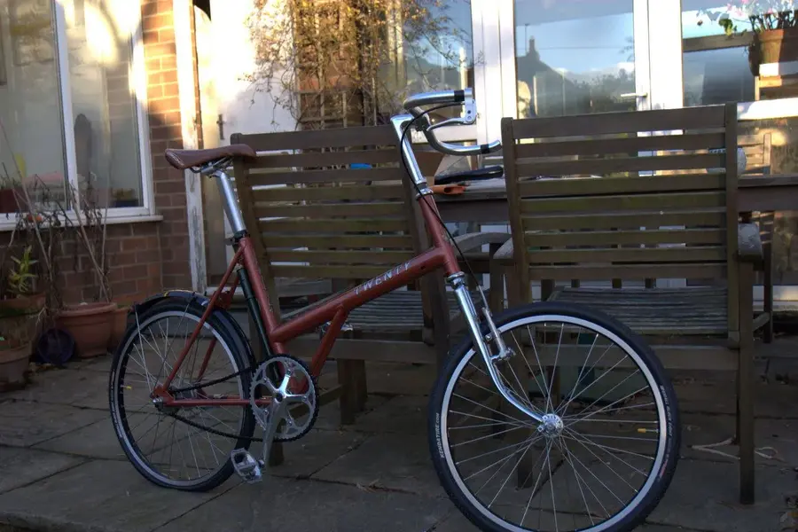

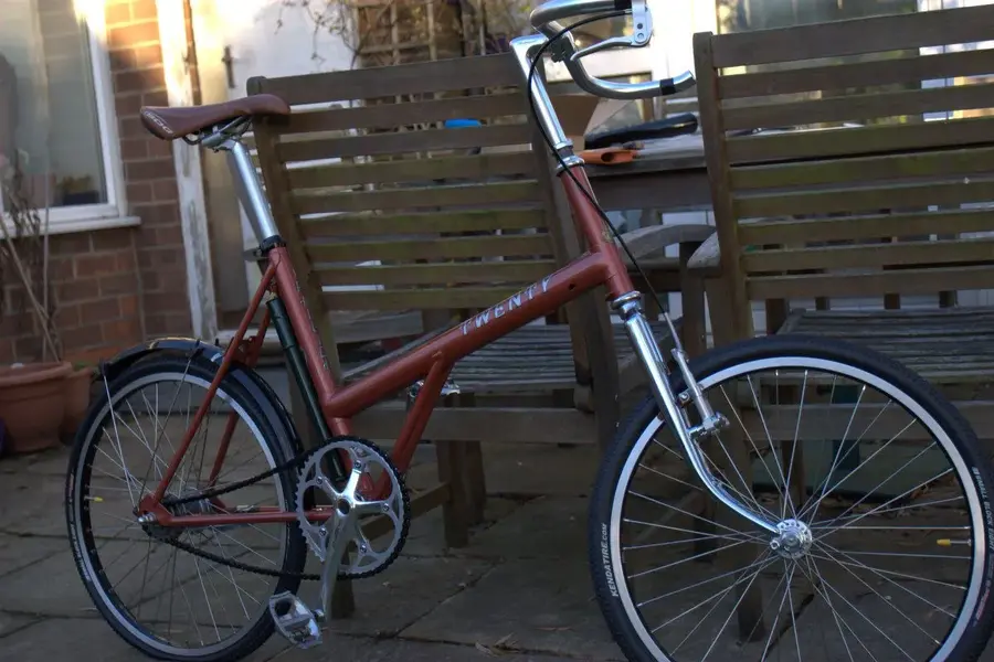

Fork roughly fitted
Something much closer to complete. I still need to cut the steerer tube down by an inch or so. The JIS headset cups are a bit of a loose fit and require shimming or a bit of Loctite. The brake is a Paul motolite V with a Paul Reverse lever. The pump is a bit of a nod to the past. I could also be doing with a half link for the chain if anyone can help me out. Then a few adjustments, front mudguard, perhaps a tool roll, some bar tape and ready to test ride...

Oh, that is so good. It looks properly rapid -no small achievement given that my most recent Raleigh Twenty sighting was of a sturdy old lass pedalling sedately along with a load of shopping in the rear basket.
