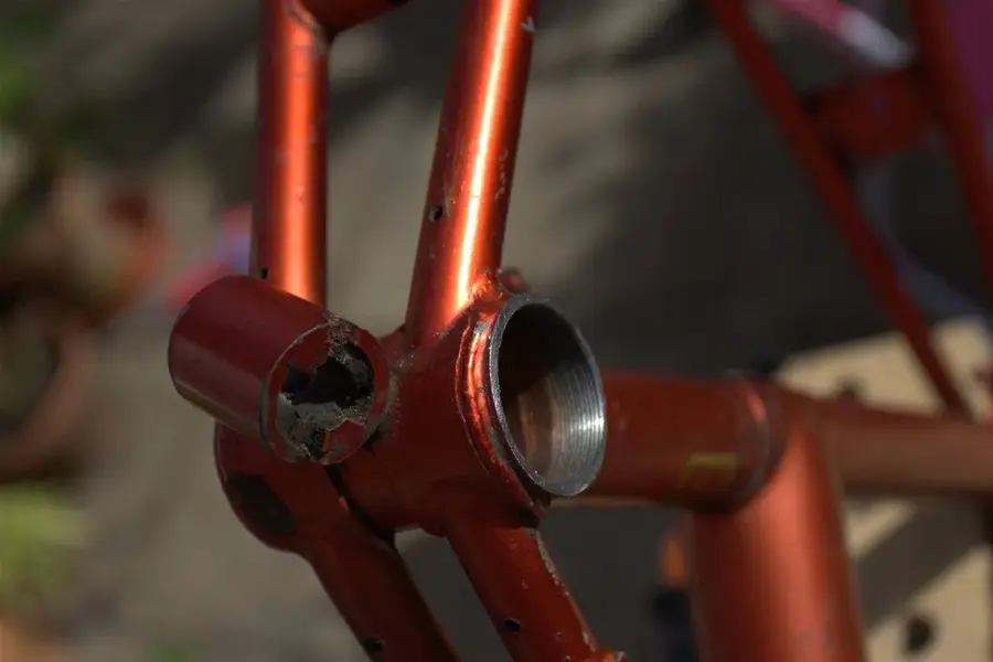

The fixed cup was easier than I expected. A good soak in penetrating oil, a Park HCW-11 held in place with a big nut and bolt and a couple of gentle taps with a heavy hammer
Next the BB shell...
Cool! Hacksaw and file? Before picture? Did you just remove it from one side or an equal amount off both sides?
Hack saw and file job, roughly equal amounts off both sides. Hopefully the shop can face it cause it's not that good. 24 tpi threads next...
