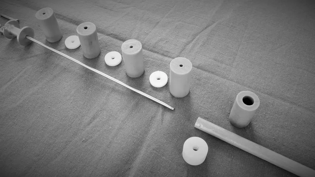

Unscrew the top cap and you lift out a string of elastomers... Is this like any other fork? maxresdefault.jpg IMG_8155 (3).webp IMG_8158 (3).webp
Manitou III maybe as I don't remember my Manitou II's working like that. It was a long time ago though!

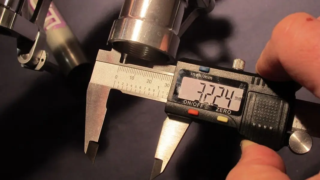

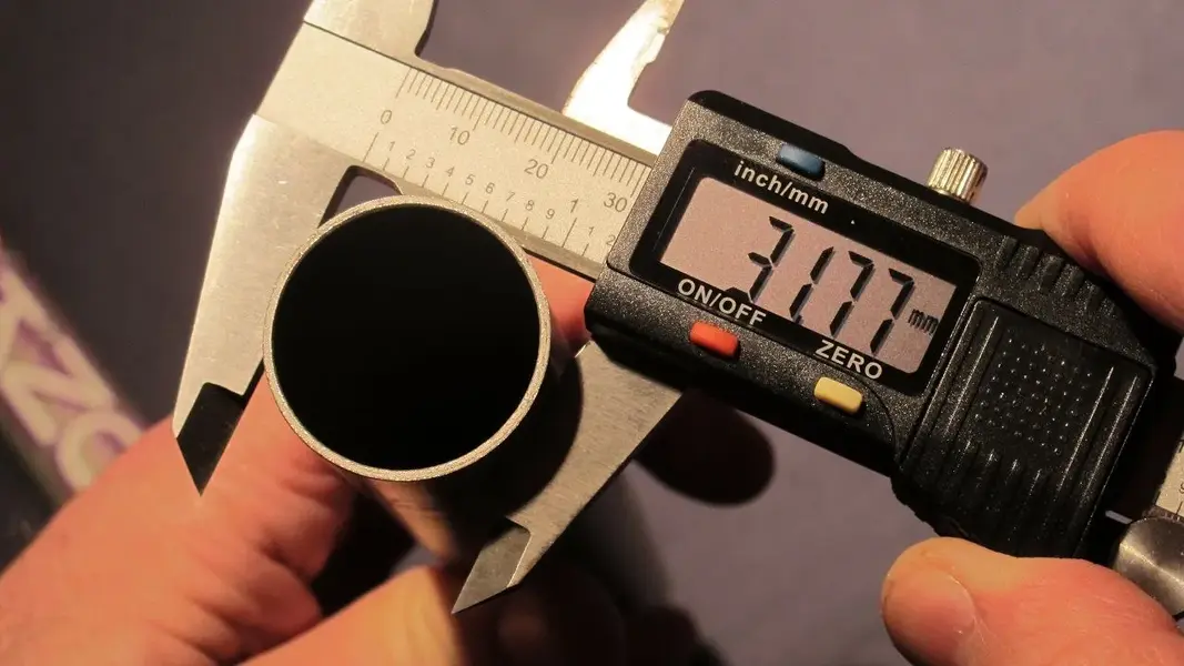

So the issue is the gap (0.5mm) between the stanchions and the caps? Would an o-ring solve the problem Caspar? Need a pic to better understand I guess.
I see. So that's a tough call since a potential and permanent solution may prohibit easy access to the internals long term. Do you plan on riding/using the fork? I assume so.
