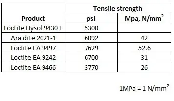

I've had a bit of time to look into the options for bonding the two parts together and there are literally hundreds of options, which makes it very difficult to make the right choice when you're new to this. I've tried calling a few companies that sell this sort of thing and they won't offer any advice/guidance. Understandably, there are too many variables that will affect the final performance and consequently they just refer you back to the technical literature...
You don't seem to be able to buy Loctite 9430 in the UK but I have found a company that sells and number of structural adhesives and I've listed a few below that could be a option.
Is tensile strength the key parameter to look at when selecting the right product? This figure is based on an ISO standard and therefore it's about as good as it gets. I did see some data showing that you achieve lower bonding strengths when sticking anodised parts together (I believe the legs have been hard anodised). 2-pack adhesives.webp

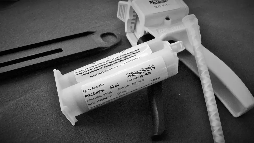

Some more web based research identified a two pack epoxy adhesive with a tensile strength of 60MPa (8720psi) which looked pretty good plus I managed to talk to their technical support team over the phone :D.
After explaining what I was trying to do a very helpful chap at Robnor ResinLab confirmed that PX628HP was a good choice as the aluminium to aluminium lap shear adhesion was exceptionally good and this would be critical for this repair. He also advised that removing the hard anodising would give a better bond strength.

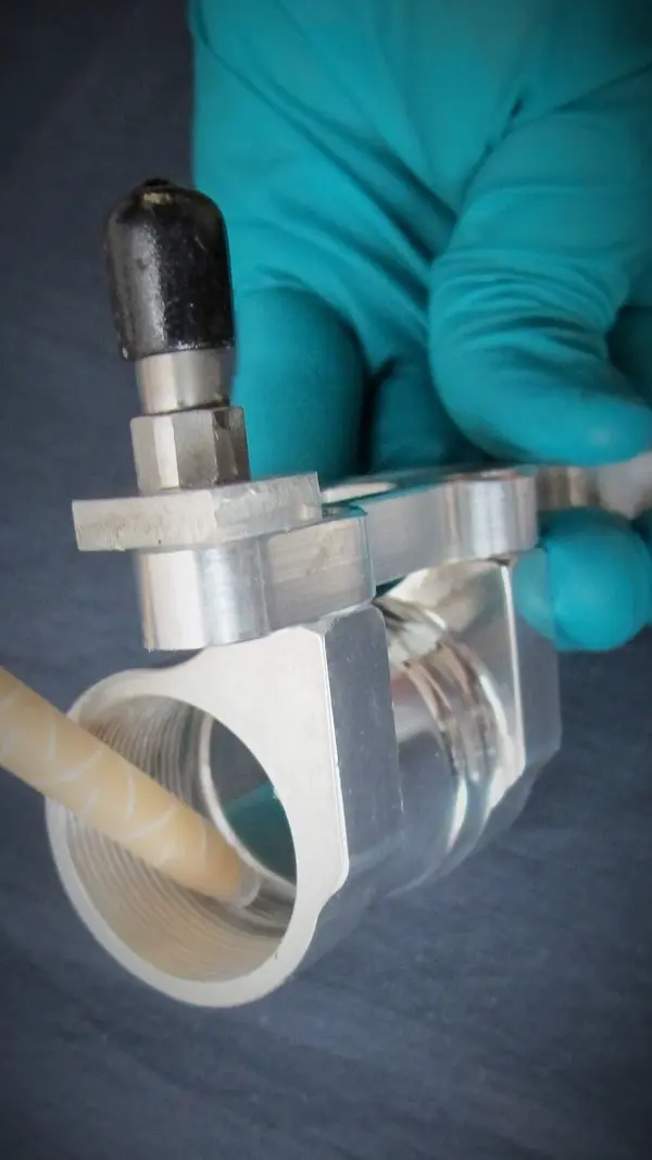

£39 later 🤦 and a few days for postage a 50ml cartridge, dispensing gun and nozzle arrived... Let's get started :cool: IMG_8192 (3).JPG IMG_8187 (3).webp

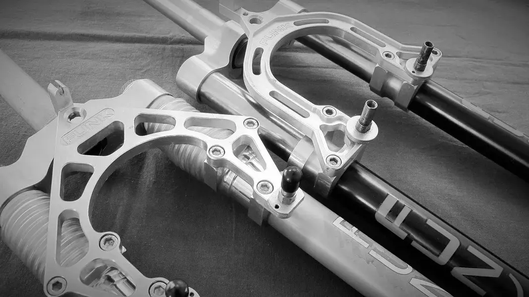

After 48hrs I reassemble the fork and it all seem to be working fine :D :D :D :D :D IMG_8228 (3).webp
