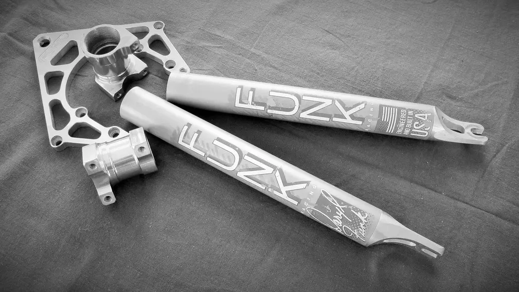

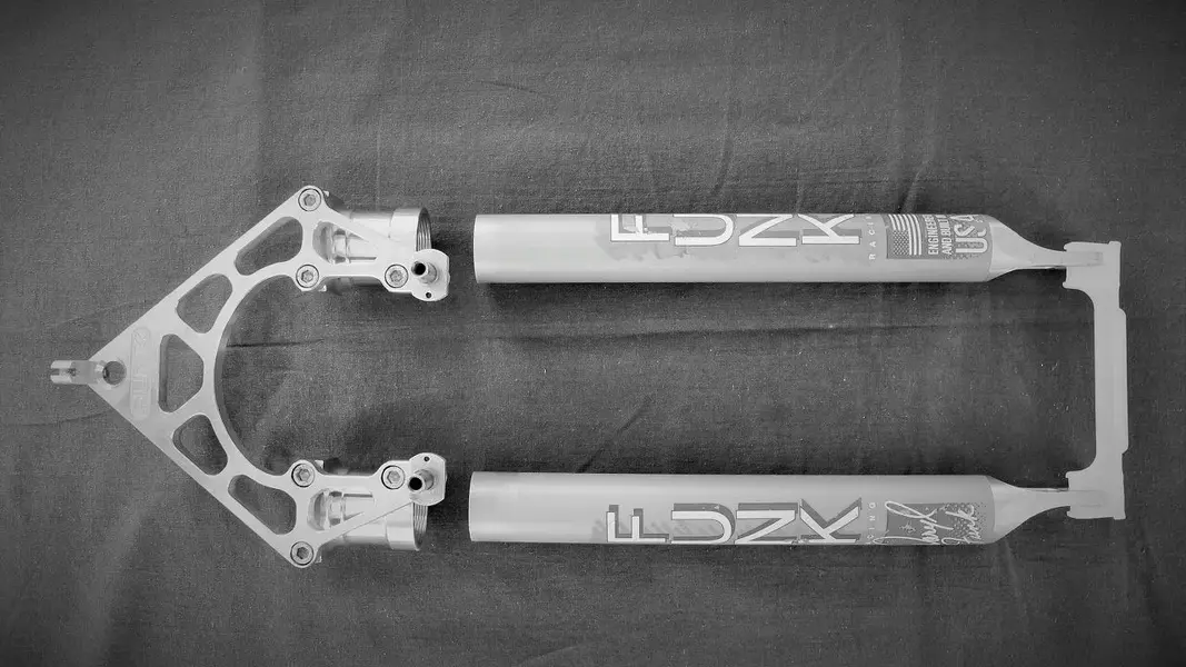

It's here... Arrived in this morning's post :cool: :cool:
Spent the evening stripping it down and it's in overall good condition BUT the outer legs have separated from the caps that sit at the top and which are bolted to the brace. I'll put some pics up later but there's a 0.5mm gap between the OD of the leg and the ID of the cap. I've spent most of the evening chipping off old Araldite, so it looks like it's been repaired (badly) in the past. Any suggestions on suitable metal adhesives?

I had a look at the price and it quite expensive. What about JB Weld?
5ml tube on Amazon for under a tenner!
EDIT: although postage is about £13 unless you can fit it locally! :roll:
Personally, I wouldn't use JB Weld... it's messy! :|
Only saw the 35ml bottles which are £49. I had a quick look at the spec and says it’s good for gaps up to 0.15mm and I think I’m at 0.25 (if I half the figure that I measured). I suspect it didn’t start like that but has been worn due to the two parts rubbing/moving. Is there another Loctite product that might work or would this one be okay?

Here's the first problem that needs fixing. I've cleaned out all the old Araldite(?) which clearly hadn't worked but if I'm to repair them I need a better solution... IMG_8176 (4).JPG IMG_8164 (3).JPG
