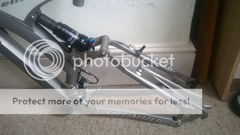

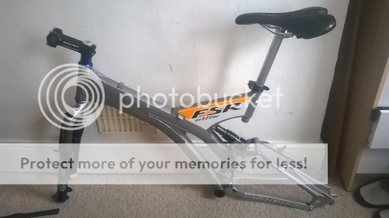

short story is - not being able to make the bushes for my diy version, ive ended up shelling out for the top of seat stay and original shock linkage bearings.
since i already installed needle bearings and seals in the frame already, i just used the bushes and nylon washers from the sets which slipped in no problem.
i've got 2 x sealed bearings in each a-link with the original bush
2 x 2000RS bearings in the main pivot with 2 x metal washers and 2 x nylon washers
all put back together waiting to be fully assembled...
incase you are wondering, that is an original sharkfin disc adapter, but i removed the anodising (with oven cleaner) as i didnt like the blueish finish. think this matches the frame nicely now :) will probably finish off properly with a silver matt spray (got some exhaust spray paint somewhere)...

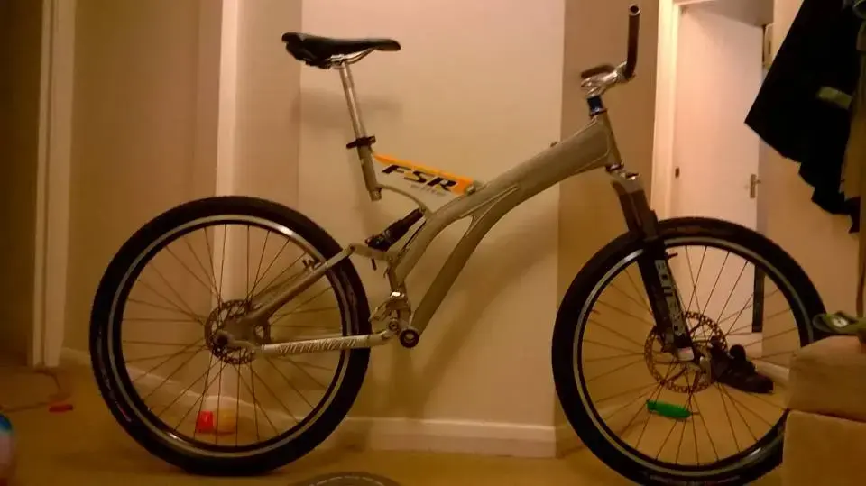

got a rolling frame now....
slowly adding transmission.
got grips on their way
need to sort out my disc brakes then ill be just cabling up the gears with a view to a test ride :)
not sure on the handle bars - the sweep and rise is a bit too much for me....not wide enough either...
sorry for the shoddy pic!
spec so far:
XT M770 cranks (not in image)
Race Face turbine BB
XT M770 rear mech (not in image)
XT M770 shifters (9x3) (not in image)
Marzocchi Bomber air
Hope stem
Club Roost bars
CK headset
spesh saddle
unknown seatpost - want to replace with ritchey later
Fox Float (RP2) rear shock with gonzo valve (means i dont have to take shock off frame to top up/let down)
XTM739 front mech (is the only one i've found that will fit without fouling the main pivot housing)
Alexrims (black with black spokes)
Novatec hubs
203mm front rotor (hope)
shimano 160mm rear rotor
Conti Race King tyres (i think)
