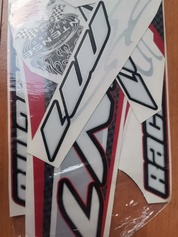

Mine is a 97 and had it since the day I bought it, raced local in the NW of USA for about 4 years. Then after I have just kept it stored away wherever, always dry tho. Then about 2 months ago I pulled it out and began pulling it apart. I had retrodecals make the new decals and I had to take the pictures abd measure because Gil was unable to locate my stickers by sight of the pictures I sent him. Don't remember what he found different now.
