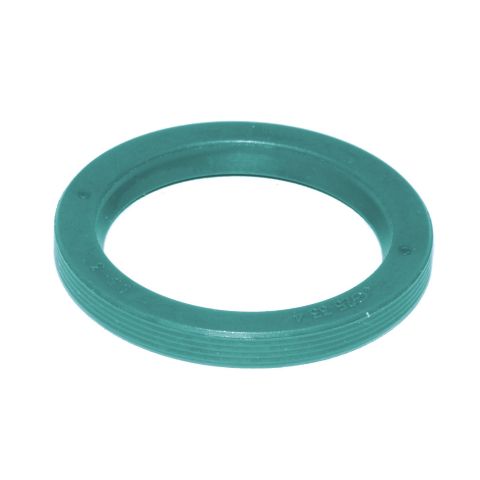

found these today for the shock linkage setup - needle roller bearing seals:
exact ones i need here: (12mm ID x 16mm OD x 3mm wide)
http://www.wychbearings.co.uk/g12x16x3_skf.html
most expensive part yet at just under £8 posted for 2......
