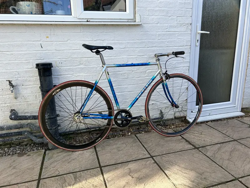

This will be a thread for the rebuild of my 1982 Alan Richards which has a very spangle-y paint job.
I’ve built the bike up in a few different ways since I picked up the f+f awhile back. It’s currently sat in a box in the loft awaiting a suitable donor.. Cue this (sorry looking) Peugeot which I found at my local waste transfer/steel stockholders this morning:

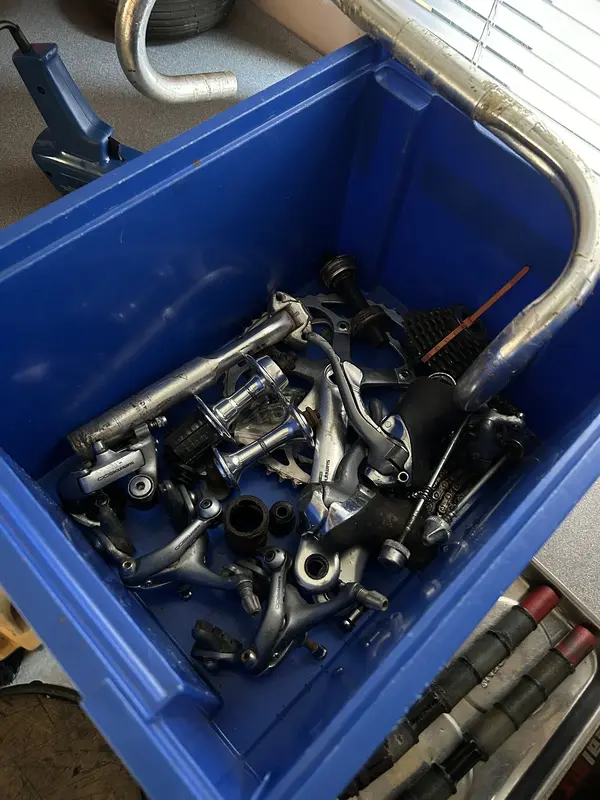

But the Shimano 600 group is mostly save-able. The headset top cup was split and the sti’s may be beyond repair from whatever crash it had, otherwise all ok with just scratches and general wear. I can live with that for what I paid for it..

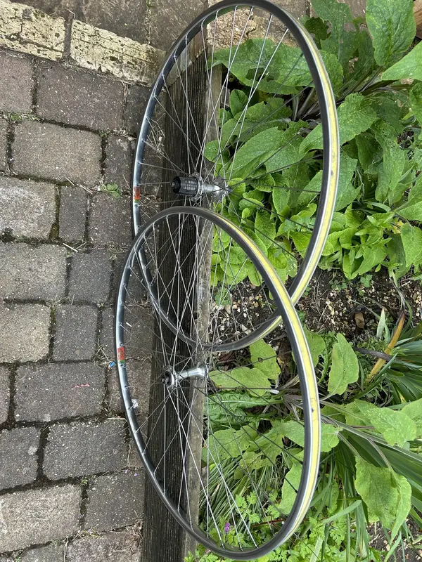

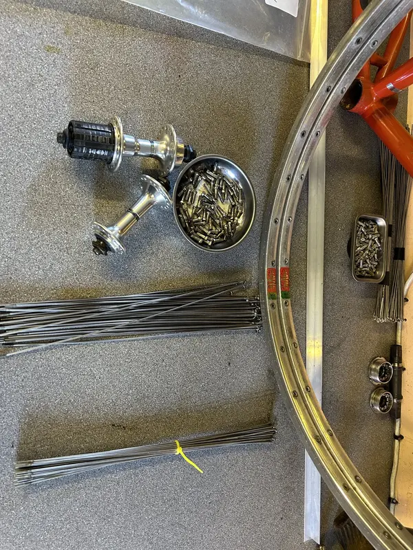

Box of components awaiting cleaning and fettling, I have some nice Mavic MA rims to lace onto the hubs. Lots to do but it’s a good start. :)

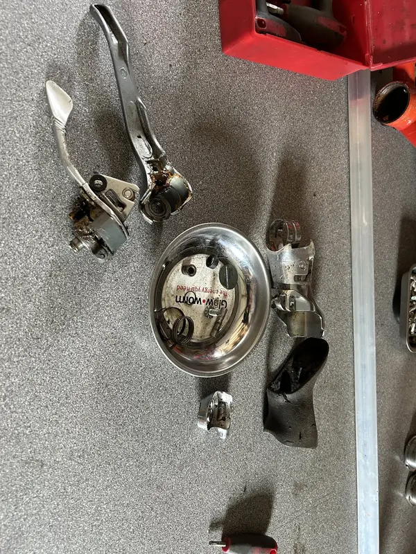

Thanks so much for posting up that link @Jonny69, it inspired me to get the brifters stripped and investigate.

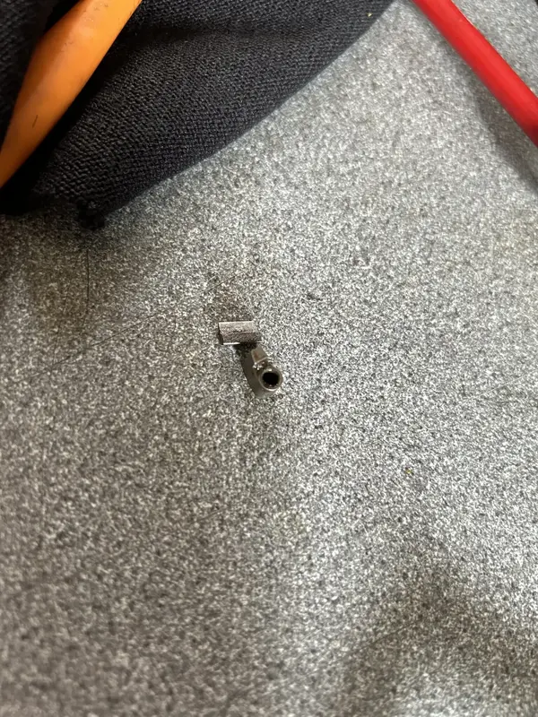

They really aren’t too bad when you get in to them, both were hella gunked up with old grease but the left hand one had a broken pawl:
To be fair that one was the worst cosmetically, the lever didn’t return fully home when at rest - it was sitting sort of at the 1 o’clock position. Fair to say that one suffered an impact at some point. Good news is that the right hand unit cleaned up and reassembled perfect and works a treat so I might only need one replacement if I can find one. 👍
Don’t know if it’ll be any help identifying that part number in case you can find another one, but it looks like Shimano still have exploded views of those shifters on their website:
https://www.bikeforums.net/classic-...0-ultegra-tricolor-105-hood-compatibilty.html
https://si.shimano.com/en/manual/search?input_model=st-6400&model=ST-6400
https://si.shimano.com/en/pdfs/ev/ST-6400-1226/EV-ST-6400-1226A.pdf
Might be worth putting a post in the wanted section on here in case anyone has a scrap shifter you can pinch that part out.
Good advice, I actually managed to scoop another pair of these sti’s off eBay yesterday afternoon. They were listed as parts/not working and described as ‘not ratcheting’ - I’m hoping I can make one good one out of the parts I have. In the meantime I might strip down some of the spare shifter units I’ve got in my ‘knackered but might be useful for parts’ drawer and see if there’s a spare pawl I can use in the sti I have? You never know..
