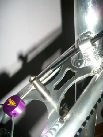

Thanks guys! It has been good to have a few days off work to fettle with this steed and sort some issues. Due to the frame being of 96 vintage, the rear cable guide on the seat tube is designed for a V-brake ie; the cable does not leave the guide centrally. As I am running Cantilevers this was a big problem. However, after having a think, I managed to utilize a threaded brake post to good effect. I simply drilled a 2mm hole through it at the appropriate cable position and bolted it through the existing hole in the rear bridge, with a M6 stainless hex bolt. The result ended up far cleaner and subtle than first imagined - and it works a treat too. Happy dayz 8)
Sorry for the crap shots...

the brake stop mod is awesome! that really does solve a problem. how does the brake feel? must be reasonably solid.
mine is 95, the cable guide is very similar though, and indeed when GT put cantilvers on it, they simply just ran a short piece of outer through that loop, with no real definitive stop.
Hey Merckx the brake feels waaay better now, although I have not ridden it yet. Lever is solid with minimal spongeness. Cannot wait to try it!
