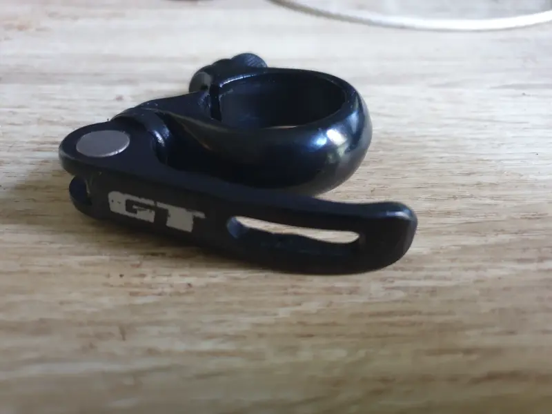

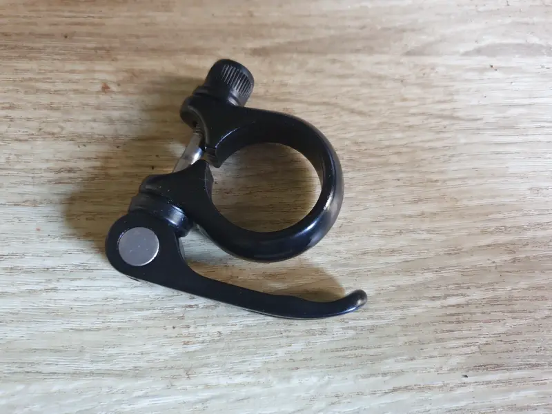

This arrived in the post today, though I did have a seat post clamp that did fit correctly, the quick release lever was a later model which didn't really look right for my Zaskar.
I think this new arrival is a better fit and look to finish it off. 😁
