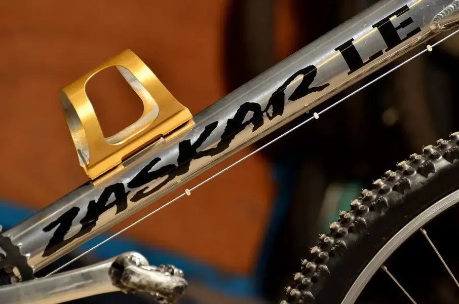

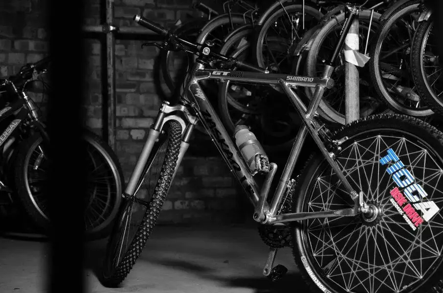

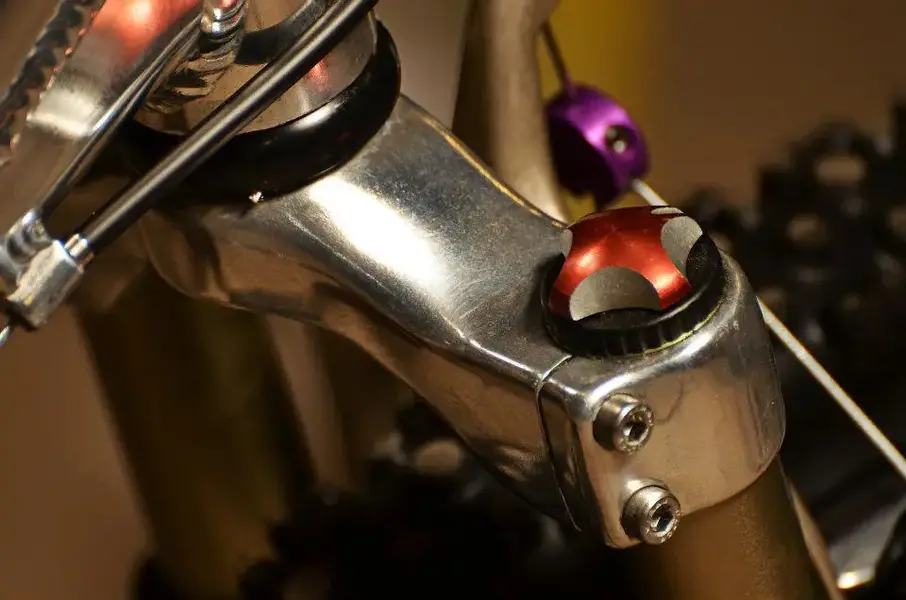

It is done and I am WAY HAPPY! The spec at present is as follows;
Frame: 20 inch 1996 Zaskar LE with 1992 Decals by Gil M. NOS Shimano, Onza frame decals and chainstay protecter from Cali.
Fork: 1995 Rockshox Judy XC rebuilt with Metal Oil Cartridge, Stainless crown bolts and Kronos Springs installed.
Headset: NOS Tioga Alchemy 1 1/8th
Stem: Syncros Cattleprod Ahead painted black with repro-decals
Handlebar: Stock GT
Grips: NOS ODI Attacks
Barends: Onza Aluminium L-Bends
Brakes: Deore LX Cantis
Brake Pads: Shimano
Brake Cables: Fibrax with Shimano outers
Cantilever cable hangers: Onza Chill Pills
Brake Levers: Shimano Deore DX SLR
Shifters: Deore DX STI
Front Derailleur: Deore DX
Rear Derailleur: Deore DX Short Cage
Derailleur Cables: Shimano
Cassette: 12-28 HG70
Chain: Shimano HG-40
Cranks: Deore DX 175mm (Black anodizing stripped and polished)
Crank Bolts: Stock Shimano
Chainrings: Deore DX
Chainring bolts: Stock Shimano
Bottom Bracket: Shimano UN 53 122.5 x 73mm
Pedals: Shimano Deore XT M737 Spd
Hub Skewers: 1995 Ringle Twister
Rims: Tioga disk drive on 36h Ritchey Vantage / front; Black ano Wolber
Hubs: Shimano XTR 950 / Deore DX
Nipples: Brass
Spokes: Stainless DB
Tyres: NOS Onza Porcupine (re-issues)
Tubes: Specialized Shraeder
Saddle: Selle Italia Flite Titanium
Seatpost: Tioga
Seatpost Binder: Unbranded
Weight: Approx 26.5lbs
Enjoy the pics peeps... 8)

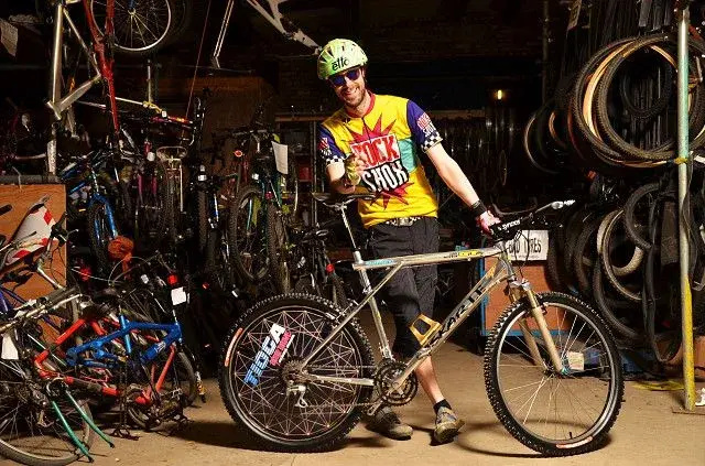

Looks a lovely bike mate wowwwww .
That your man cave?? Or that work??
