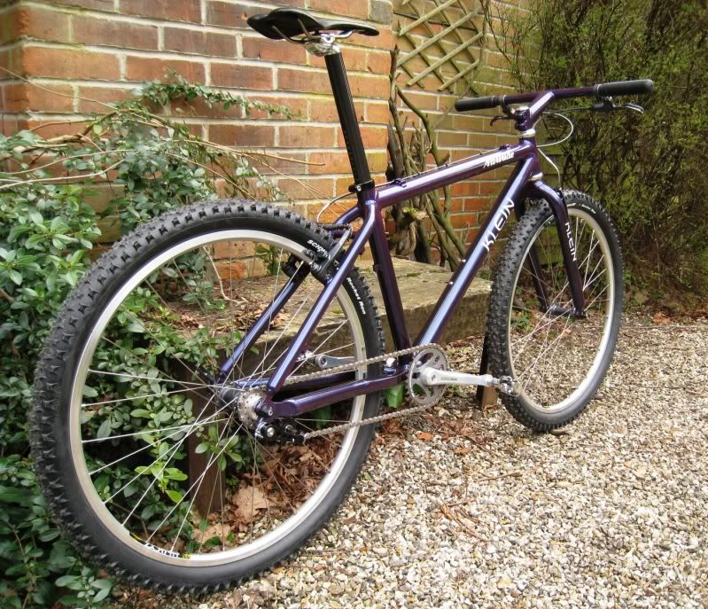

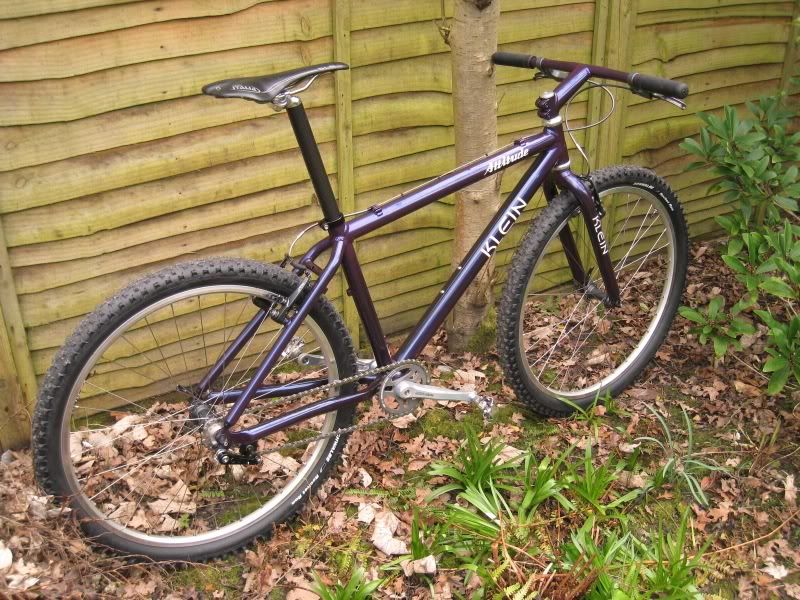

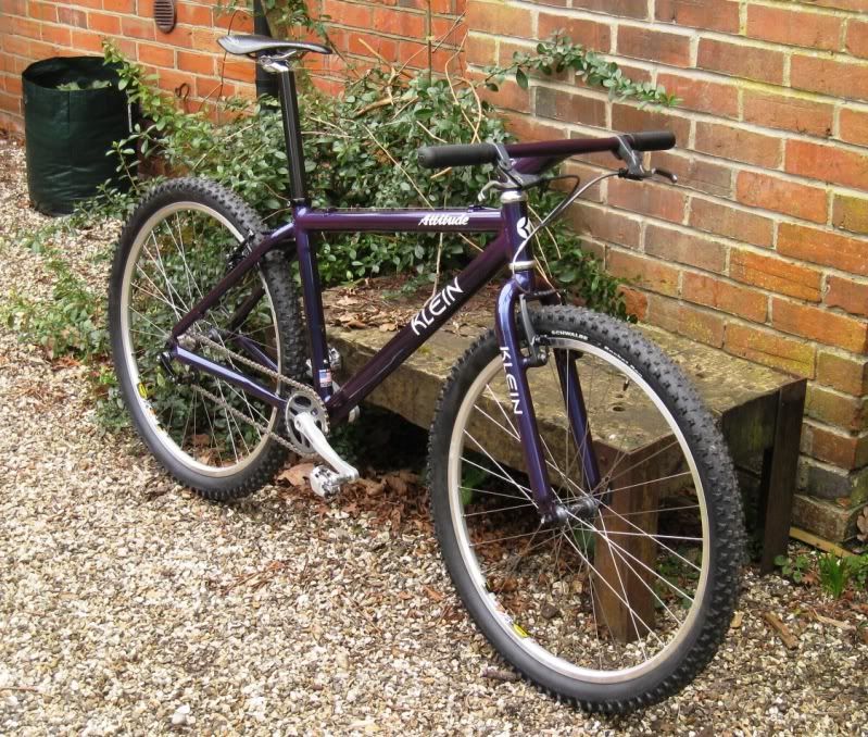

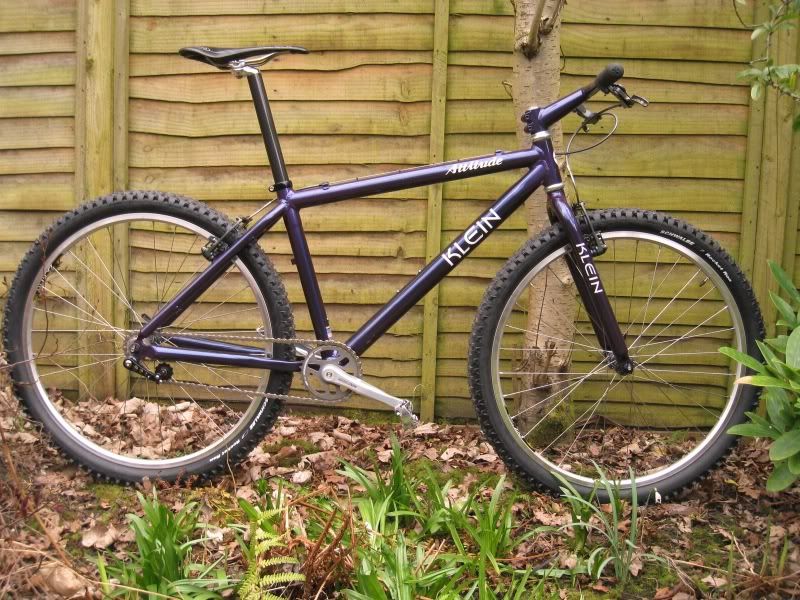

Well folks i have just finished my first retrobike project so please be kind. i will pop the full spec sheet up a bit later and Wadsy said he will pop up some pictures for me as i am a computer mong.
in short it is a klein pulse frame (not an attitude before anyone says anything) with cannondale forks and its single speed and a bit of xtr thrown at it for good measure.
i hear screams of despare
its light, weighing about 20lb
ideal for going to the shops and back,
hope you like it
stubbsy :D
i must also put a big thank you to wadsy for all his help in sourcing bits and building skills, he is a bit of a spanner ninja.
A few pics for you :D .....

well folks heres the full low down, i could make it a few pounds lighter but it would cost an arm and a leg.
Frame: 1997 pulse pro
Fork: cannondale p bone
Headset: chris king
Stem/handlebar combo: fred salmon
Grips: odi attacks
Brakes: xtr m951
Brake Pads:xtr
Brake Cables: xtr
Brake Levers:xr m950
Rear Derailleur:single speed chain tensioner
cassette: onza single speed converter kit
Chain:kmc single speed chain
Cranks:middleburn rs-8
Crank Bolts: middleburn self extractor
Chainrings:middleburn uno 32 tooth
Bottom Bracket:shimano un 54 73x113
Pedals:xt spuds
Hub Skewers:xtr m950
Rims: mavic 717
Hubs:xtr m950
Nipples:silver
Spokes:silver
Tyres:rocket rons
Tubes:specialized
Saddle:selle italia slr
Seatpost:carbon 31.6 mm (no brand)
Seatpost Binder:klein
Weight:20lb
and once again thanks to wadsy who has been a fantastic help and guided me throught the fine art of spinning spanners (best left to the experts)
now onto my next project a proflex 955 (if i can get the crack in the swing arm welded :cry: )
cheers
stubbsy :D
