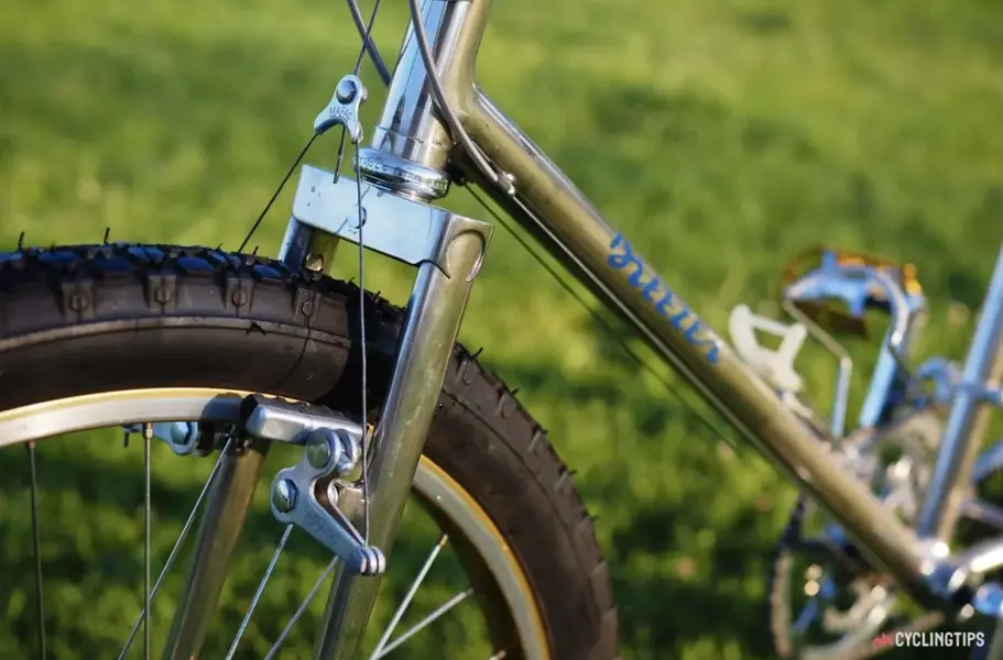

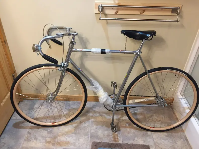

A good powder coated can do it. They use chrome powder, which looks more like nickel. They have to use two coats of clear or it will look more like silver paint. It should be clear coated with 2K rattle can clear or grease and sweat will turn the clear powder blackish. The blackish tinge looks good as a patina on some bikes. This frame and fork cost me $100 USD to be blasted and coated. Like you I could find no one that would nickel plate a bicycle frame.
Thanks for this. Looks good enough to consider as an option :)
