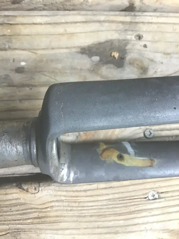

Man, this bike has crazy construction, I just cleaned up the fork and put phosphoric acid on it. The acid etch is drying. Originally the bike was nickel plated, but only the frame was painted. Why plate everything? Perhaps to detour rust but galvanizing would make more sense. The fork had no paint so that was just nickel. Now that it’s clean and the remaining nickel is mostly scrubbed off you can see the construction. Talk about craftsmanship. The fork blades were brazed shut, looks like fine stitching. The fork crown is also finely brazed to the legs with brazed pins just to make sure. How they did this is a mystery to me. 94FD7098-D5B6-4740-86E5-36E710142576.webp C8A7E7BD-7A23-43E7-9F71-98896F8584F6.webp

I’m wondering if the fork is made out of the same steel as the frame, honeycomb dents on the inside? Perhaps back then tapering curved fork legs had to be handmade? Anyway, it’s amazing, lost art now.
My god this is amazing ....that fork....wow.
Safe to say that's most likely made of the same stuff!

I look at the forks above, and I'm bolded over. A dove-tail like joint in steel? Pressed recesses internal in the tubing?
Why the hell would you apply such techniques if you didn't have a queue of extremely wealthy customers to ride a bike?
Something else is happening I think.
