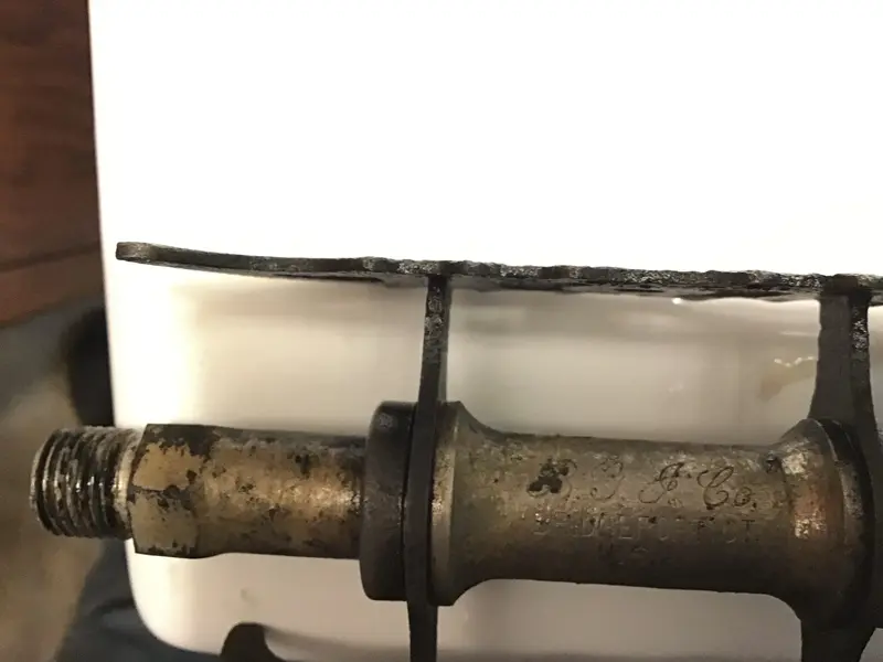

One of the pedals has a chipped race so NOS period pedals in 1/2 inch instead of the more standard 5/16 will be substituted. Looks like it’s embossed BGJ Company, Bridgeport, Connecticut. B926288E-14D5-4596-9830-2F28BEDBA34B.jpeg 4EDB2C1F-D625-4B91-97CF-722E0DBD0C76.jpeg

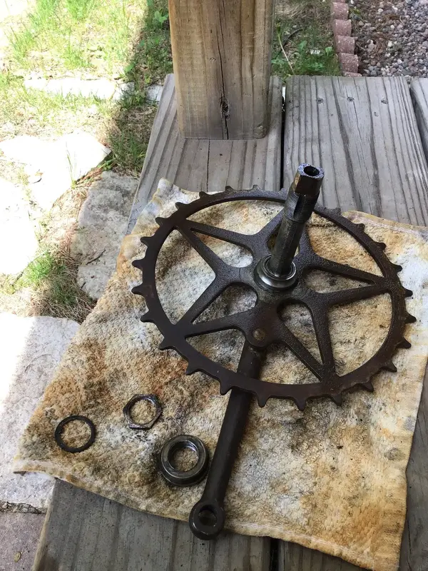

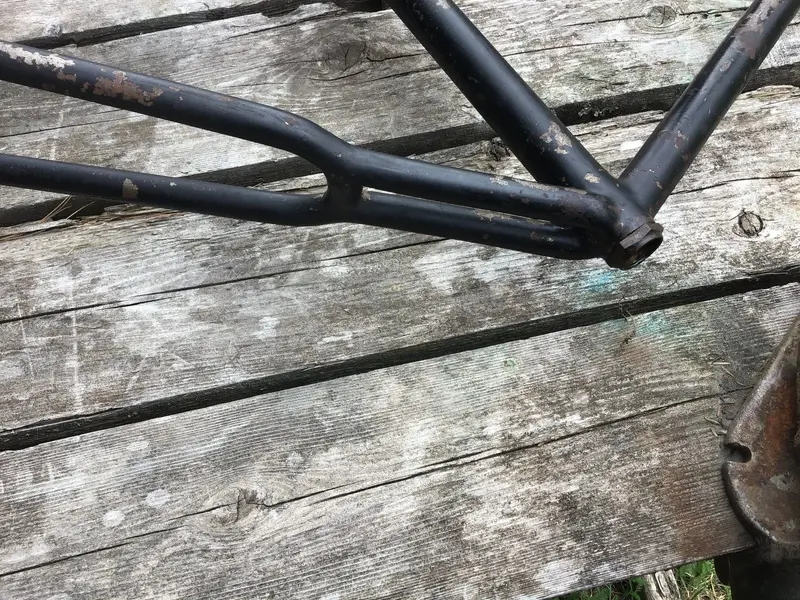

The bottom bracket is sealed with a leather washer. A”C” internal lock ring holds the large 3/8 inch bearings in place. 32BFE579-2CA2-41C3-8C27-74865862ED68.jpeg

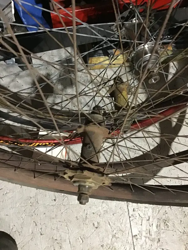

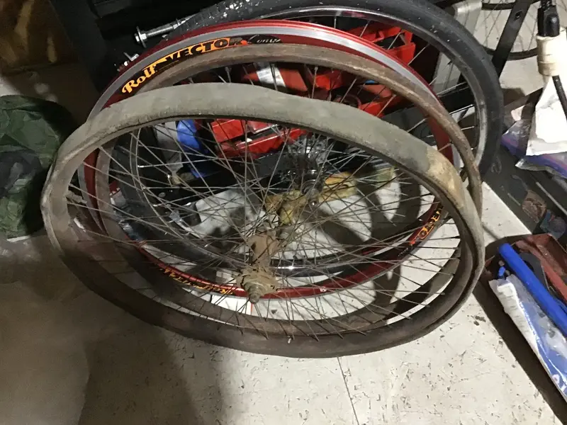

The wheels are dry rot wood with pretty bad, made by Monarch, hubs. The rear one inch pitch 9 tooth sprocket is worn to points. I’ve never seen a 9 tooth inch pitch for sale, their usually 6 rarely 7. I’m not sure if a later inch pitch track cog would fit on the original hub so a substitute is called for. It has a block chain, no rollers. It’s usable, but not great. FA836DB8-3B90-4401-B7A5-EDEE95A8D514.jpeg E07287B9-8011-42ED-839F-D80F2E3CABB9.jpeg

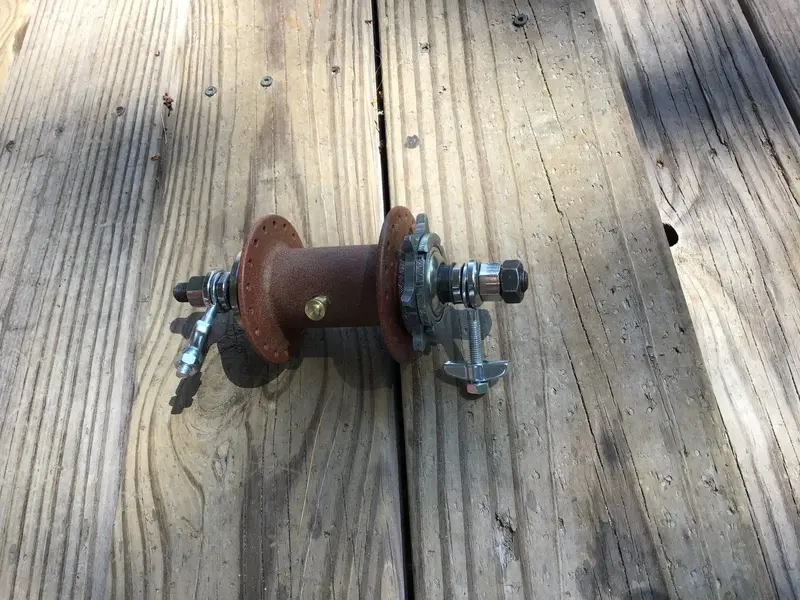

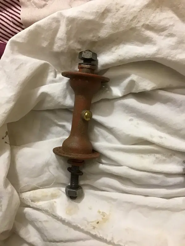

Fake old hubs. Front is vintage, rear is a new flip flop 120 mm (this bike has 4 5/8 spacing) that’s a few mm bigger than the original spacing. The flip flop has thin wall tubing welded into the center. Non functioning oilers were installed on both hubs. Fake patina. D9CA93FD-EB76-42E6-9FAA-F9ACDEC92390.jpeg 388F882C-639A-4B24-8523-497B23EF0E6E.jpeg
Rear hub with an 18 tooth track cog converted to 9 so it’s one inch pitch. modern cogs are thinner than the originals so that will wear the old chain a little faster. The non drive side has a non functional thread stripped inch pitch installed for looks. I had the stuff so why not. F266FDFC-60D9-47CD-BEDC-FE88EF4EDF93.jpeg

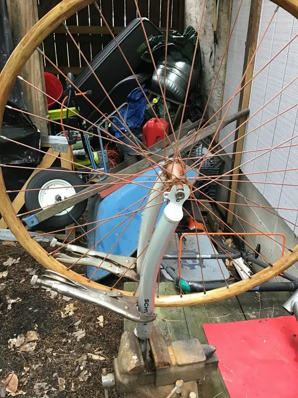

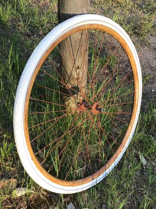

Wheels are fake wood. Made from layers of flexable marine epoxy and outdoor flexible epoxy wood filler that has wood flower in it. I’ve had tires on and off a few times and nothing chipped. I have four other bicycles with wood wheels and they need constant truing and spoke tightening as the spoke head washer sink into the wood. I don’t want another bike that needs this, so faux wood rims. 7A28C435-A0DB-44B7-94B8-5CB6073DF104.jpeg 73745BC7-6361-4B7C-B374-EF4129CCE3C6.jpeg

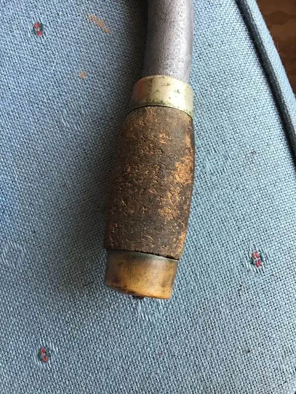

Bars and stem that has no expansion wedge. It’s got an external clamp, which doesn’t hold as well as an expansion wedge. The bars were bent but straightened. They were treated with phosphoric acid. The cork grips were originally placed by screwing a brass cap into a wood dowel in the bars. Hide glue was used and is reversible by soaking in hot water but the cork was rotten and disintegrated when I tried this. 8DB70EA0-58B3-47D3-816D-C25A6D9A85A1.jpeg C2228863-A5BF-4D35-9A70-5F5DA350AEA4.jpeg 14E360CF-9AAA-4755-99A6-4459C3EA4A3F.jpeg
