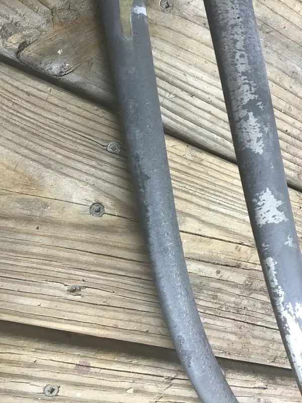

I can't see the forks being formed to a curve after being made into a tube....I reckon that would cause way too much stress to those toothed joints...the braze wouldn't let go but the steel would.
Does the joint size between main tubes,forks and stays vary much or is it all consistent and the same?
