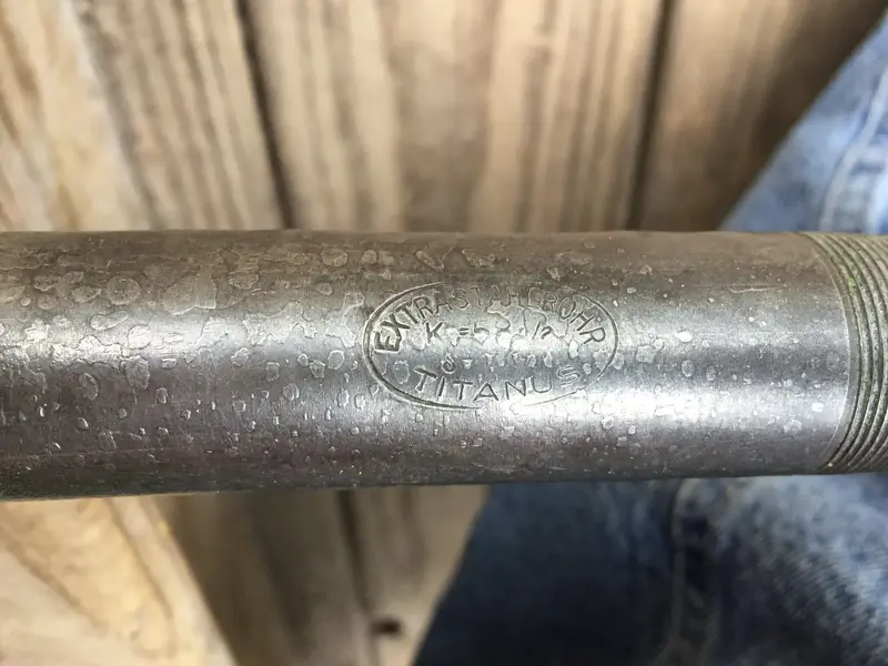

I have a late 1920s Gloria. It has Italian high quality tubing made under a German patent. It was also bent and worn out, but not as bad as this current project. I have a set of reamers, threaders and facers for bicycles. I tried to fix it myself but the steel was so brittle that I made a mess. I sent it to a frame maker and he couldn’t fix it as it was brittle. He replaced two tubes and the drops. He removed dents, did a track alignment and spread the drops from 114 to 120 mm. He thought it might have been furnace brazed but because of the steel brittleness I’m now thinking it may have been brazed with a blowtorch. The net info indicates that a blowtorch had a wide flame. Interesting. Here is the Gloria tubing stamp. I can’t find much about this tubing. 700C2A88-D18F-4FAD-83CE-CD9169BD6AA9.webp

I have a late 1920s Gloria. It has Italian high quality tubing made under a German patent. It was also bent and worn out, but not as bad as this current project. I have a set of reamers, threaders and facers for bicycles. I tried to fix it myself but the steel was so brittle that I made a mess. I sent it to a frame maker and he couldn’t fix it as it was brittle. He replaced two tubes and the drops. He removed dents, did a track alignment and spread the drops from 114 to 120 mm. He thought it might have been furnace brazed but because of the steel brittleness I’m now thinking it may have been brazed with a blowtorch. The net info indicates that a blowtorch had a wide flame. Interesting. Here is the Gloria tubing stamp. I can’t find much about this tubing.View attachment 636429

And now I've got to look into titanus tubing....going to be a long night between this and woz's de Dion bouton thread...oh dear...best get some liquid refreshment in!
