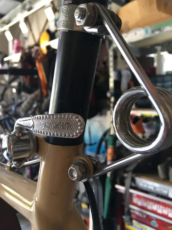

I like that - braze-ons galore. My money is on Lee Cooper/Orbit: sleeved seat tube cluster and forward facing clamp. It does looks a bit Robertsy but maybe the fillet filing doesn’t quite fit?
Lee Cooper for me too. People tell stories about frames from the midlands being delivered to Overburys, no one has said so but I have always been under the impression that Lee Cooper was the mystery builder.🥸
Seems like an odd choice of Hite Rite braze on. Most I've seen are quite a narrow tab, so the Hite Rite can site pretty much central on the back of the post. Could it be for something else?
Its not quite right, is it, the other option would be for a rack, but the frame isn’t that small, and it already has eyelets at the top of the seatstays!
Surely Hite Rites are designed to affix to any rear facing seat tube clamp fitting, and this braze on seems to match the dimensions of the original seat tube fitting.
Perhaps the more elegant slim fitting was something that came later, and recreating the seat clamp fitting was the more obvious solution at that time.
Surely Hite Rites are designed to affix to any standard rear facing seat tube clamp fitting, and this braze on seems to match the dimensions of the original seat tube fitting.
Oh it will absolutely work; it's just a bit of overkill for a dedicated Hite Rite braze on. I wonder if RBG is on to something with his suggestion
