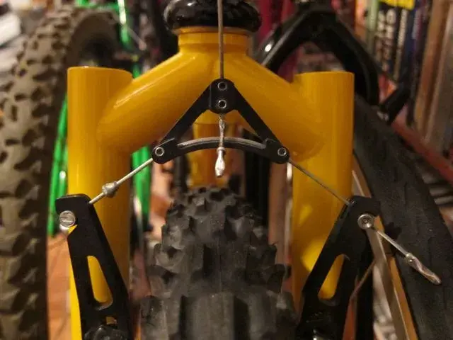

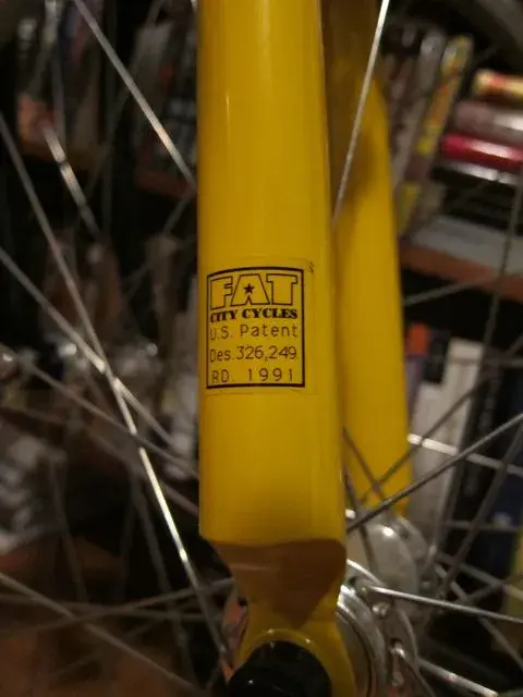

All the dimensions from the sunset fork you've already got, but I can add my '93 to the mix. My sister is mailing out my '91 fork wreckage soon, so I can measure along the twisted metal in a week or so and add it too.
This fork is original to the frame, both '93, both suspension corrected. It is a medium. My '91 and '92 had the same general dimensions, but on the '93 the length of the fork is made up having a shorter head tube. The result is that the '93's down tube and top tube nearly touch as they converge at the head tube, while there is an inch or so between them on headtubes of the '91 and '92.
Axle-crown is approx 16 inches, from the axle to the tops of the legs is 15.25 inches. Here are some pics to give an idea of clearance, etc. Diameter of the legs is 1.125.
