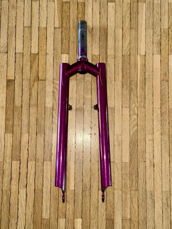

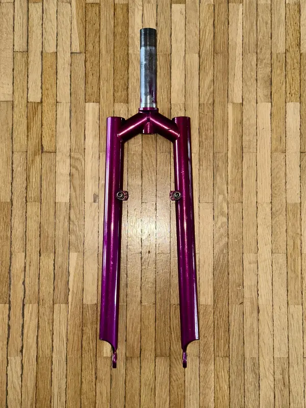

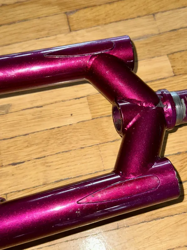

I was going to list this on eBay about five minutes ago and have been deep diving into what exactly I am holding to accurately convey the information to potential buyers in the Item Description area. But if this is what I think it is, then well...I guess I am shopping for a frame!
About three years ago I inquired with ya'll and the answer wasn't quite clear. After finding this thread through a general online search as well as others made by Scott Bengston (your appeal to authority) elsewhere online, I am almost certain this fork is rarer still than the BOI, I thought I had a BOI, but I do not. If anyone can argue one way or the other, I am very happy to update this post with corrected information!
I am the second owner of the fork. The fork was pulled off of an early 90's Stumpjumper Team (which I have since sold) that the original owner bought new along with the YO Eddy! fork and where he raced in the Swiss circuit for some years. When I picked up the bike he made it clear several times that the fork 'cost him a lot of money'. He was in love with this fork like saying goodbye to an old girlfriend. Additionally, I had no idea what a YO Eddy! even was let a lone a magical fork. I even asked if he still had the original fork! At any rate...
The lengths/measurements, weight and appearance puts this fork as a pre-BOI, YO Eddy! fork that has the correction for short suspension as outlined above by @OldFatTi.

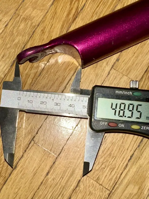

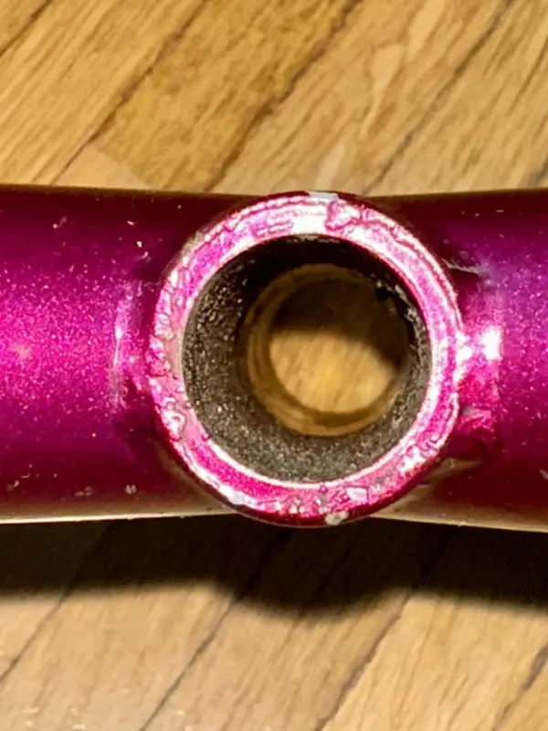

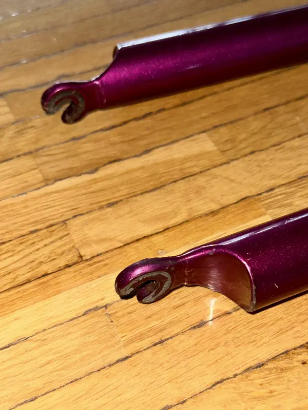

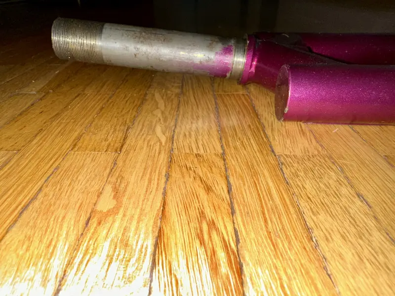

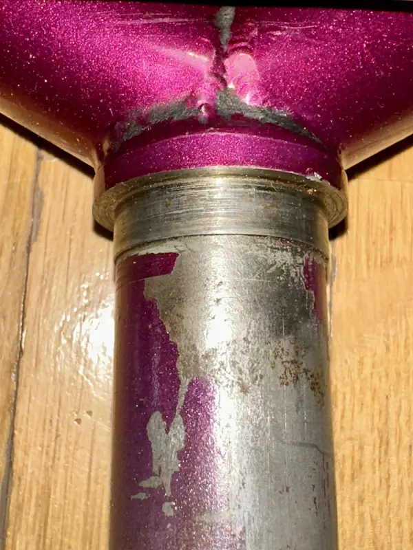

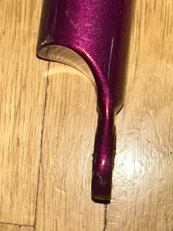

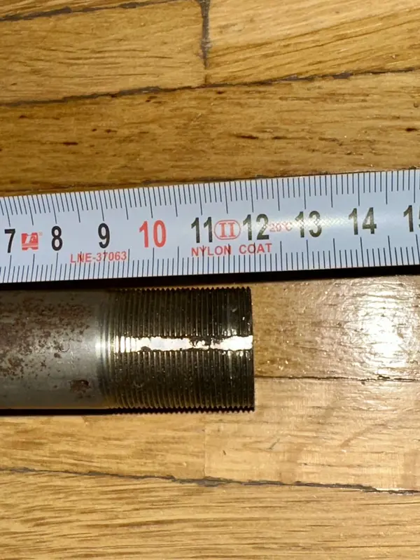

Utilizing information from this thread and measuring myself I have come up with:
Threaded steer tube: 1" dia
Thread length: 30 mm
Steer tube length: 130 mm (to bottom of crown)
Inner diameter of steerer tube at the bottom: 18.7 mm (approx.)
steerer tube thickness at the bottom: 3.8 mm (approx.)
Axle to crown: 390 mm
Blade length: 375 mm (axle to top of leg)
Blade diameter: 1 1/8"
Bottom of dropout to bottom of crown: 405 mm
Total length: 515 mm
Stress Gusset (tear drop material welded to upper portion of the blades) length: 54 mm
Width of blades overall highest point: 132 mm
Top of blade to center of brake post: 123 mm (approx.)
Weight: 780 grams
If this is indeed real, then I need a frame to go with the fork. Thank you!
3B47FB7F-C925-4F22-8FD1-22414155EB6C.webp 6BECA3FD-4903-4236-AD7E-A2F97570EFE0.webp
Its a lovely original Yo Eddy fork but not as rare or valuable as an original factory BOI. I would definitely recommend waiting for the right Yo Eddy frame to turn up to fit it. Depending on the condition, it might be nice to repaint in Grello or some OG FCC fade. FCC invented this style of segmented fork and patented it, since copied countless times by modern bike designers. Enjoy 😎
Thank you, sir! Does this one pre-date the BOI? I was under the impression this fork came first, phased out, and replaced by the BOI?
Yes, this Yo Eddy fork predates (90-92) the BOI (92 -10th Anniversary BOI only but from 93 onwards BOI forks were suspension corrected unless custom ) Factory BOI forks are actually very very rare as most new FAT owners were speccing suspension forks by 1993. Plenty of reproduction BOI ones about now but they never ride as nice ad the originals. FAT made a huge effort to fine tuning their frame and forks design/builds to create the right handling and ‘feel for each model’. The tubing they used was all custom spec at the time and is no longer available. Eg you cant find 29.4mm new seat tubing in their custom spec any more, which means seat tube replacement repairs dont ride as nice as originals. 👍
Provided the color if this fork I have is original (Candy Wild Cherry), then this is from 1991?
