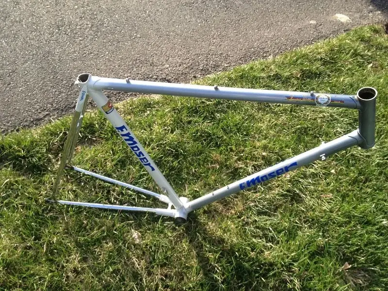

Hello All,
I'm another sick maniac who can't stop building project bikes. this is the first i've posted here, so please be gentle! the frame is currently being repainted in a classical italian blue with white panels. i've been collecting parts since april, and will be building it with a full 2006 campy record group, and some other pretty light italian parts from around 2006. almost entirely NOS, and with some bolt tuning. this'll be my new winter bike starting this year. i'm hoping it'll come in under 16 pounds with 25mm tubulars.

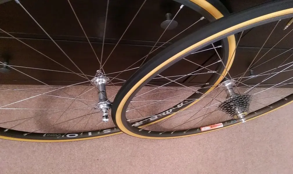

Here's my parts list and a photo of the wheels which i just finished.

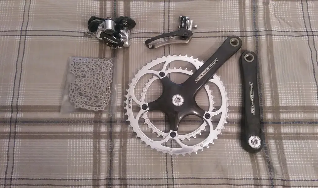

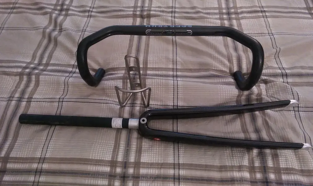

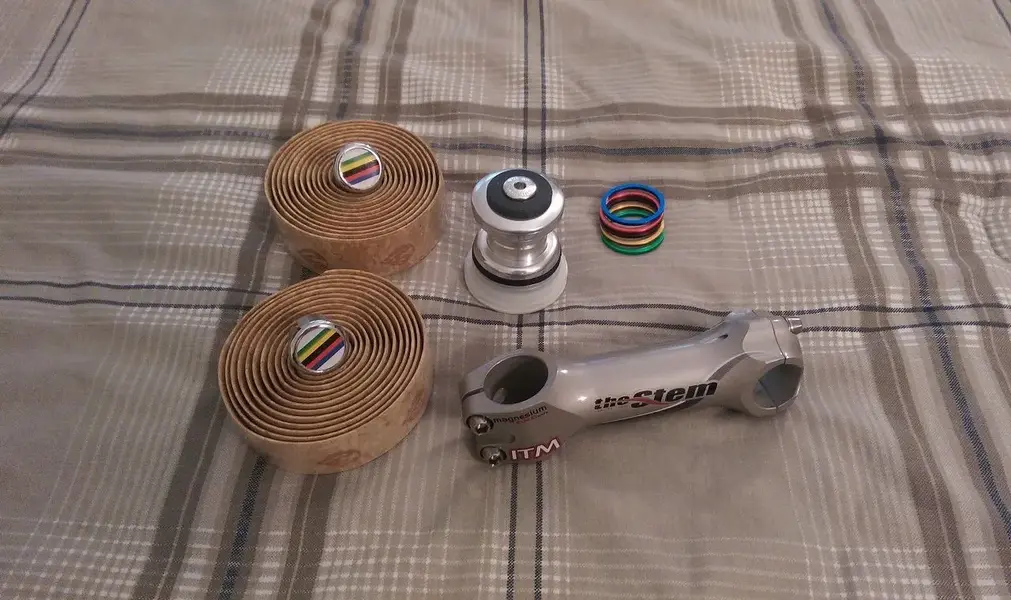

I took some photos of the parts as they are now. There's still a little more tuning to do, but this is pretty much it.
