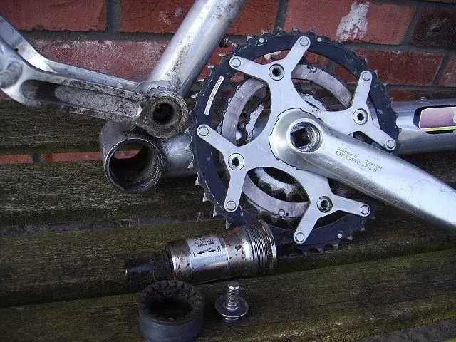

Gardening today for my old boss, who has a work shop full of left over tools from when we had the bike shop. Sure he will be able to get that stuck crank bolt out, plus he's stronger than me and hasn't got a bad back...yet...
No doubt the BB will be a bar steward too so he can deal with that as well :mrgreen:

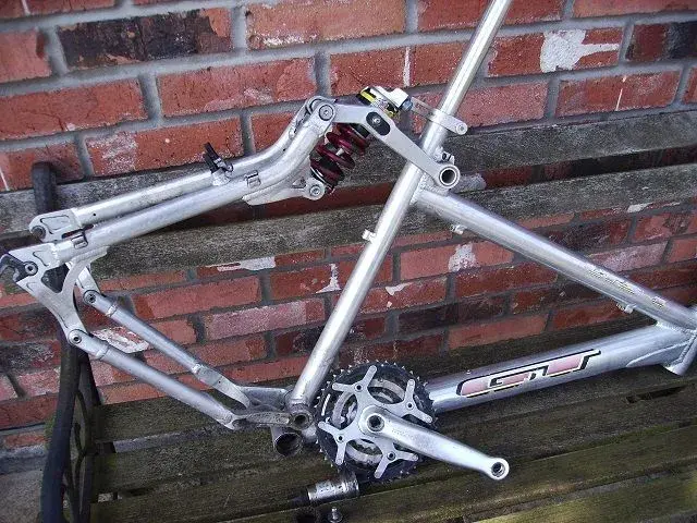

Any ideas on how to get the top mount bolts for the shock undone, I noticed yesterday that it's held on by two tiny allen head bolts that look as it they're already rounded off??
Try the correct size Allen key, ensure it goes in fully then turn with pressure but ensure it doesn't slip. If they are rounded try a torx bit, sometimes you can get them to bite. Do not reuse the bolts though.
The black travel chips can be tight. Use something that won't damage the plastic to drift them out of the frame from behind.

Result!! :mrgreen:
Apparently the crank bolt was 'quite stuck' but the BB practically fell out.... Lots of cleaning to now do.
What's the chances of me getting new rings/spider for the chainset? (Had one up until recently and pretty much gave it away :facepalm: )
And possibly a rough idea of value on the forks for spares? I won't be keeping them for this build, just not my scene being triple clamps.
