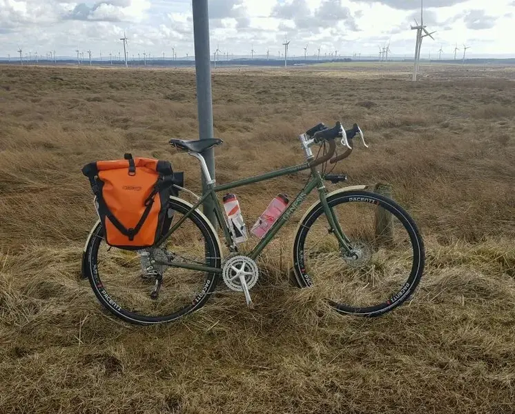

Grabbed four 2 litre bottles of sparkling water, whatever tools were lying about, half a dozen inner tubes, a hoodie and a bag full of bar tape to create both weight and bulk and flung it all into two rear panniers. Just over 14kg in total between the two bags
Deliberately put all the weight at the back to test handling, which it seemed to cope with nicely. I have a bar bag to go on which will help balance things. A tool bottle will take some of the heavier tools I'm taking and will go on a third cage mount on the underside of the downtube, so weight distribution on the ride itself should be pretty good.
Did 20 miles with 350m of climbing up and over Eaglesham Moor in the harder direction. Almost all of the climbing was into the wind, so I'm quite happy with the 13mph average.
I have 7 weeks of training time left thanks to injury and weather... 40 miler tomorrow.

What a hoot today... this thing just rolls and rolls! Added a nice orangey-coloured Altura rack pack that I got for less than half price from Merlin - I figured that would be great for stashing the waterproofs
Hauling 15kg of water and hoodies (on what is not a light bike anyway) up 9 & 10% inclines ain't easy, but once I remembered to use the 36 at the back, it got very easy!
Would have been nice to dodge the icy showers, but I guess the more my character gets built in training, the better!

I'm not going to be taking anywhere near 15kg of stuff on the ride itself. The extra weight is just to accelerate training as I'm a bit behind due to a combination of weather and a broken hand.
Last multi-day ride I did saw me take under 9kg of gear and that included stuff to do a days work at the other end.
I'll do a dummy pack in a couple of weeks but Id be surprised if it was much more than 10kg including bags.

No tweaking required other than set up of the rear mech cabling and indexing. It needs no converters, adapters or highly engineered doodahs to work.
I did overhaul the right ergo, but only to improve shifting generally, not to make it work with the SRAM rear mech.
This is the second bike where I've used a SRAMpagnolo drivetrain. As long as you are using 10 speed ergos and a 10 speed SRAM rear mech it just works. NB. SRAM/Shmano cassettes only
