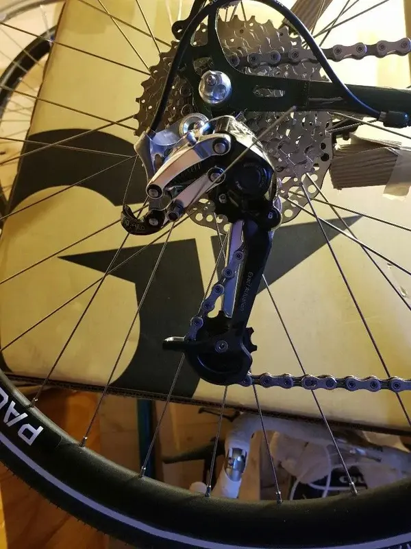

The rear mech took a bit more effort... There's no cable adjuster on the X0 rear derailleur, so I used a Campag inline adjuster to work with the barrel adjuster on the frame stops. A couple of trims to outer were needed until I was happy. At the other end it took about 6 trims of the outer before I was happy... And I'm still not 100%... As you can see from the pic below it's got a fairly steep curve in it.
The reason for this is the cable entry angle on the mech... I'm not used to mountain bike kit, so maybe this is normal, but I've never ever trimmed so much off a rear mech cable outer. Once it was cabled though, it took less than 5 minutes to get it indexed across all gears.

That cable entry is optimised for top tube and seat stay routing, looks good though,

Aha... that makes sense.
I've had a look at images of X0 equipped bikes and those with chainstay cabling were all set up with very little curvature in the cable run at the mech.
I'll trim some more off when I put it back together after the shifter rebuild.

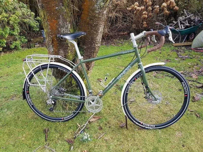

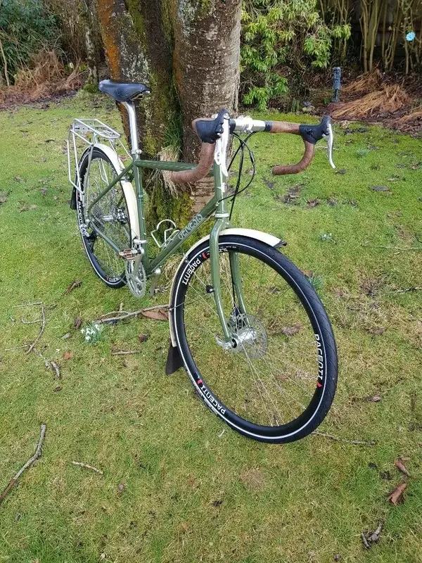

Finished the build this morning, although it wasn't without a few minor traumas...
Transplanting mudguards proved to be extremely frustrating and time consuming as I had to completely refit them and replace more than half the rivets as two months of commuting on salted roads had rotted the originals.
I'll try to get a replacement set in cream, but given I had to import these ones last year, it might need to be silver ones.
Anyway... The finished article...
Saddled up this afternoon with a bunch of flowers in a pannier bag and had a fun if chilly 40 mile round trip to tick the "dutiful son on Mother's Day" box.
Really nice bike to ride. Jumped on and the only sound coming from the wheels was the ratcheting freehub...which is always good to hear when you've built your own wheels.
The SRAMpagnolo mix worked perfectly. No mis-shifts or ghosting, and no trimming required to sort out over or under shifts as none happened.
Not quite dialled in saddle or bar height and position yet and I'm not sure about stem length... But that can be addressed over the next couple of rides.
