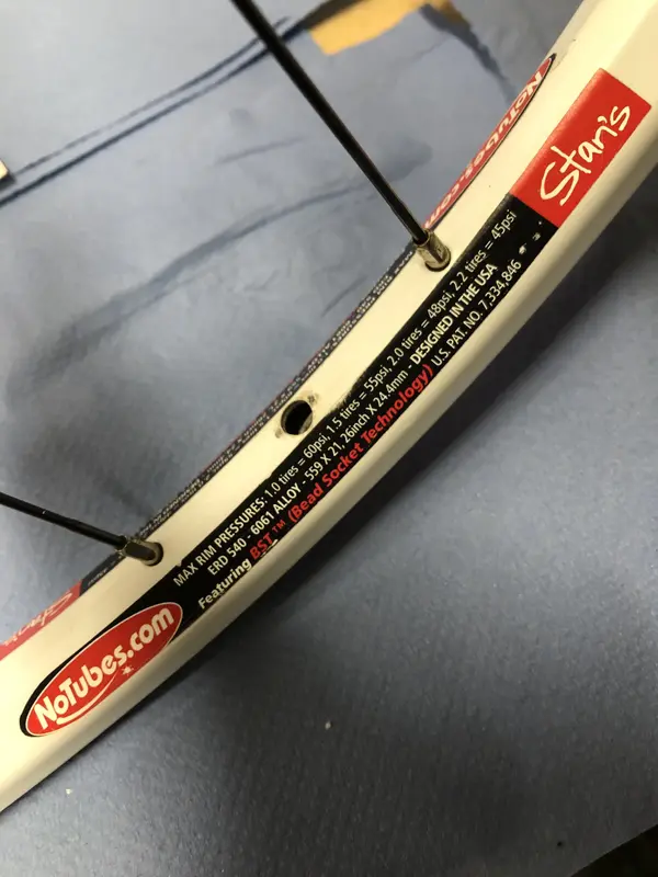

Right now I’m not so much concerned about seating them or even burping. I really just can’t get them on!
So, unless someone knows of a tubeless tyre that fits 26” Stans I’m going to drop the tubeless idea for a while. I don’t mind putting my hand in my pocket, but to go through the hassle of buying & changing rims when I’ve got a plentiful stock of descent 26” boots hanging up seems silly. I’ll pop into Halfords on the way home for some tubes as this build has been stalled for too long now.
Are you sure the rims aren’t 27.5?
I’ve had lots of tubeless tyres inc Ralph’s and yes they can be tighter than a retro tyre but never had to give up.
I've got a couple of sets of ralphs and rons on 26" stans rims (at least one set is TLR, not sure about the others)
As long as they aren't the steel bead ones, they're just tight but not that bad really. (Can you even get steel beaded???)
Certainly no tyre levers needed.
:lol: :lol: :lol: :lol: :lol: :lol: :lol: :lol:
