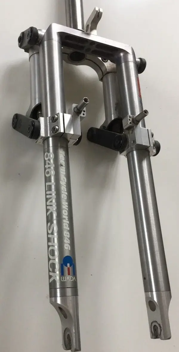

I didn't win these...and at £310 not working, I'm glad I didn't, but I've never seen them before and searches don't seem to dig up much. :evil:
http://www.ebay.co.uk/itm/846-link-shoc ... &rt=nc
This flyer was included in the gallery, but is there any additional information out in RB land?

Interesting. Never seen them either. Looks a if the damper/shock is contained within the rear leg. I assume one side the spring, the other the damper?

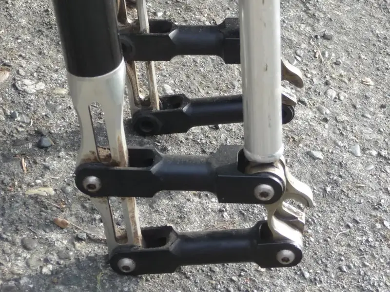

Yes, that's what attracted me. Longer linkages than an AMP fork, but with the crown and rigid fork stiffness of a Lawwill Leader.
The Leader (Above) has matching length linkages which are a bit off parallel, but this 846 looks a whole lot more extreme, so there's a lot more happening horizontally at the dropouts.
