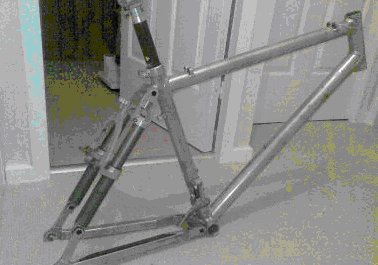

Kase1983 posted up a link in 'Ebay and Marketplace Watch' to an auction for a 'very-rare-doug-bradbury-mountain-bike-race-frame'. It was a poorly listed auction with little in the way of text and even less in the way of photos, just a couple of badly lit cellphone photos of a dirty frame looking very sorry for it's self.
The original cellphone picture
A few of us had a little bit of discussion as to what it was - 'a Marin, maybe'? But having worked in a bike shop that sold Marin I knew it wasn't (this one had gussets on the top and down tube), nor was it a Balance or even an Answer Manitou (rear forks were too old). So out of interest I shot a couple of questions off to the seller and got some promising answers, but then do you believe everything you get told by ebay sellers? He sent me some additional photos but, again, I really couldn't see much from them. Even at this point the thought that this could be a Bradbury Manitou hadn't crossed my mind, no body would be selling such a bike in such a poor way, surely? I just assumed that it was another no name frame being sold by someone keyword spamming. None the less I was intrigued but I convinced myself not to get my hopes up as with the word 'Bradbury' in the listing and its place in 'Ebay and Marketplace Watch' was surely enough to ensure the price would go through my ceiling bid. And when my lowly bid of £150 did actually secure I was then further convinced that I had just bought a cheap copy - surely no one would have let a genuine Bradbury Manitou go that cheap. But hey, I thought, for £150 what's the worst that could happen?

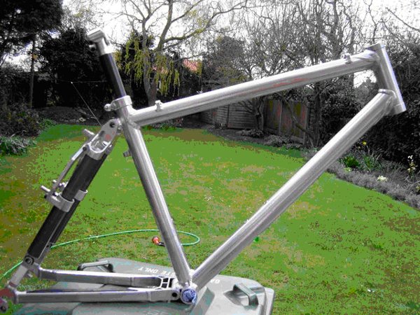

When it arrived and it was filthy, greasy and dirty, but for me, this was where the real fun started. As soon as I had it in my hands I noticed some really interesting features - first was the seatpost, a genuine Ringle head on an oversized shaft. Next was the 1 1/4" headtube and 1 1/2" seat tube, third was the finish of the rear forks (exactly the same as a set of early Manitou forks I had owned many years previously and foolishly sold on).
So I just had to know who made it! Best thing was to post up a thread on here and get the combined wisdom of Retrobike. 'What size is the BB shell' came the first question from Andrewl, our Australian expert - 90mm, 'and the rear drop out?' he retorted - 145mm. Those two unique numbers meant only one thing, this was a Bradbury Manitou FS, this was a Superbike, this was an absolute bargain and it was mine!

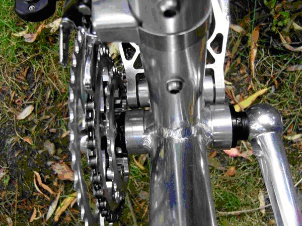

Next up I had to find that BB long enough to cope with a 90mm BB shell and a set of Cooks Cranks - one with at least a 140mm axle! Elite504 came to my rescue here with an axle designed to be used with super old Campag cranks on sealed bearing Bikes. So add this axle to a NOS cooks BB bearing and cupset that I just happened to have lying around and that was problem 2 sorted. The 90mm shell was a radical choice back in the 90s but is now a concept that has been adopted by more and more DH bikes as it offers more room for the rear suspension linkage as well as a stronger platform for your cranks but as with many great ideas Shimano and the like just wait until patents expire before they use technology rather than pay someone else royalties so that riders can benefit (Outboard bearings, hollow axles, 2 piece crank sets? Just think Magic Motorcycles, Sweetwings or Bullseye. Shadow rear mech - EGS thought of that first!)
Manitou BB detail

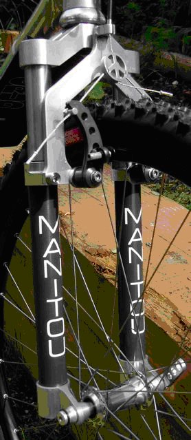

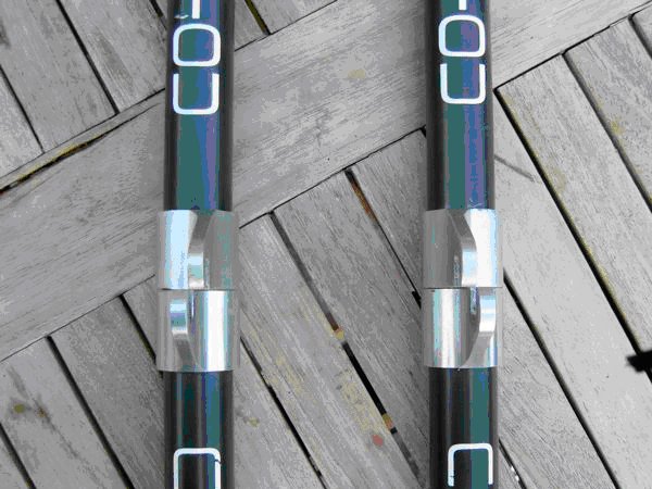

Next up was another real toughie. A set of original Bradbury Manitou forks had to be found. These forks were all made by Doug in his workshop by hand long before the Answer buy-out and again, they were rare. Madcowkev stepped up and kindly offered me his set from his Yeti knowing that my need was the greater. With a set of Gil_M's decals, Slim's elastomers and Jonnyretro's seals the forks at both ends were like new and bouncing their full one inch. Later these 'ordinary' 100mm spaced forks were replaced with a set of even rarer 115mm spaced forks from Scant paired with a 115mm ringle hub. These were the originally specced forks only found on his own bikes rather than the 100mm aftermarket version. These allowed a stronger front wheel to be built to match the rear for little weight gain.
Manitou 115mm fork
I was now in the home strait and the build was really coming together piece by piece. Add in a set of FRO brakes and a Kingsberry headset from Mountainbike-kult.de and some Scott-Mathauser pads from Sidekick and finish off with a full decal kit from Gil_M and this bike was turning into a true Retrobike effort from start to finish!
Manitou Fork detail
