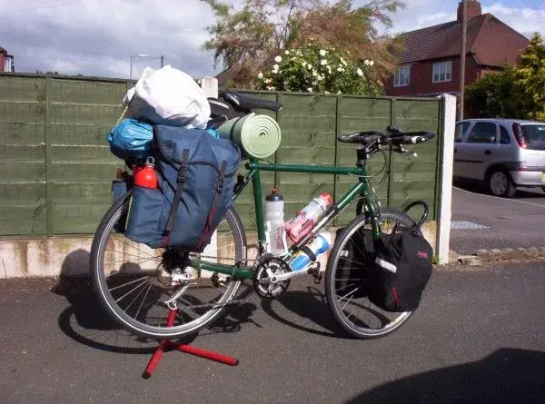

I love this thread. I'm not sure if this bike has featured here before. If it has it won't have been in this guise.
As an aside, my mum was going through her very extensive receits collection and found the one for this bike! I had managed to save some of my student grant by consuming only fresh Welsh air and a little beer all year!
5th January 1991.
Saracen Kili Flier Competition: £749.99
(There was a £50 discount as this was a 1990 bike.)
Cateye CC100 Wireless Computer: £44
I still have that computer and although it is the size of a small television, it still works.

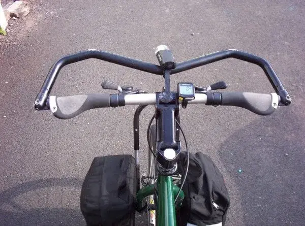

Profile Durangos! Wow!
I had a pair of those, way back when. I then found some amazing grip tubes for them as well. Such great bars for long distance riding!
