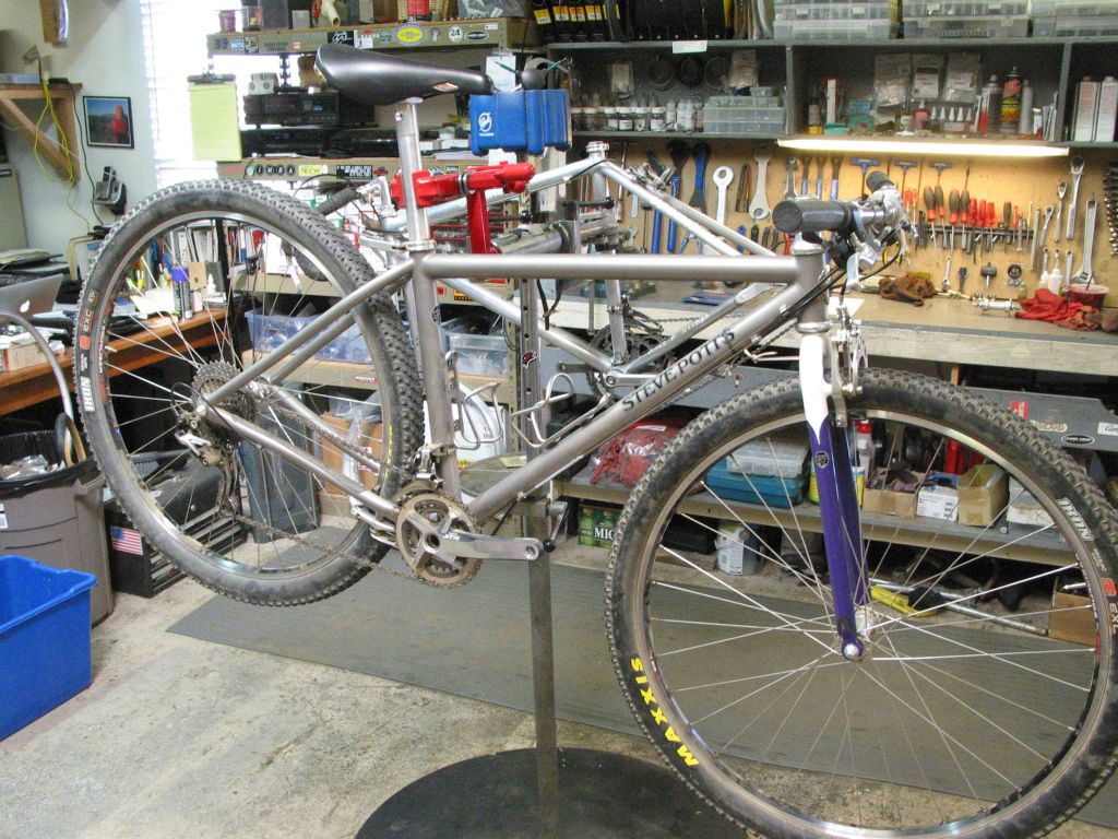

My modernish/retroish Potts 29er - en route to me. It is now in my front hallway waiting for the weather to clean up a bit. I am not quite ready to get this winter muddy.

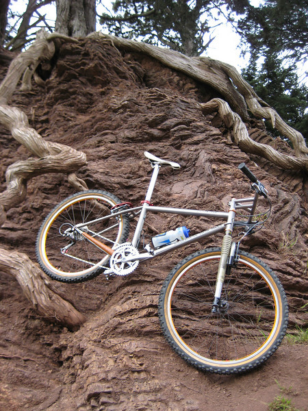

One of my dreams since the very early years was to own a bike made by such a master, that dream did come true one Sunday morning on a swap meet in the middle of San Francisco..
Here is my Ti-Phoenix..
And NO I will never sell it..
