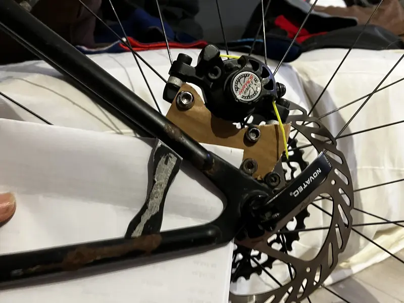

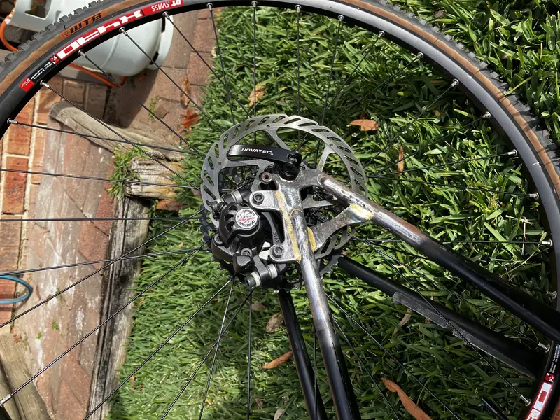

I used a wheel and clamped a cable disc caliper to the rotor, "bolted" some cardboard to the mount to give me a rough template. Also did the same for the support brace to get it roughed in. In the photo below, it's been cut and trimmed to make it a little sexier than a squared piece of steel.

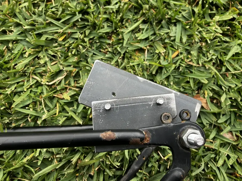

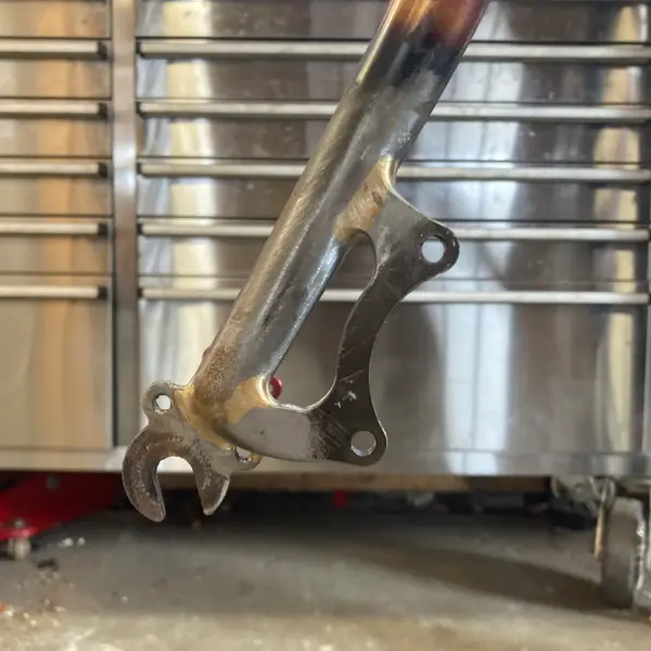

I transferred the cardboard template across to some steel to make the mount, also using some international standard dimensions that you can track down on the interwebs.

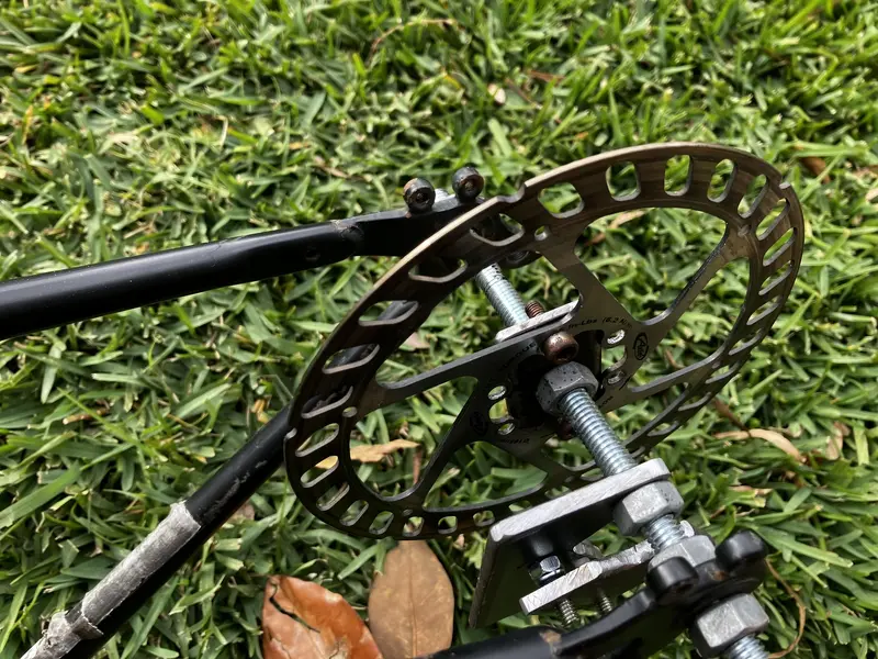

I also made a jig to mount the mount so the mount could be mounted. There are commercially available ones available, but I used threaded rod, nuts and also a rotor to check alignment.

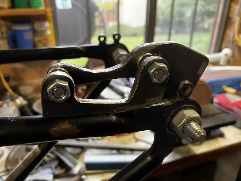

Then comes the marking, trimming, test fitting, trimming, test fitting, trimming... etc. Measure twice, cut once? Bullsh*t. Measure once carefully and trim dozens of times until you get it sitting right. Grind off a little at a time. I should point out that this is all done with fairly basic tools, scribe, rule, angle grinder, bench grinder and vise.

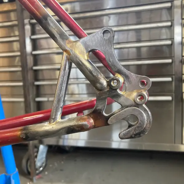

Oh, and a brazing set up. You could also use a TIG welder. You could get away with a MIG if the frame was made out of chunky 4130 - not so anything thin walled. I'd try to avoid using a stick welder.
