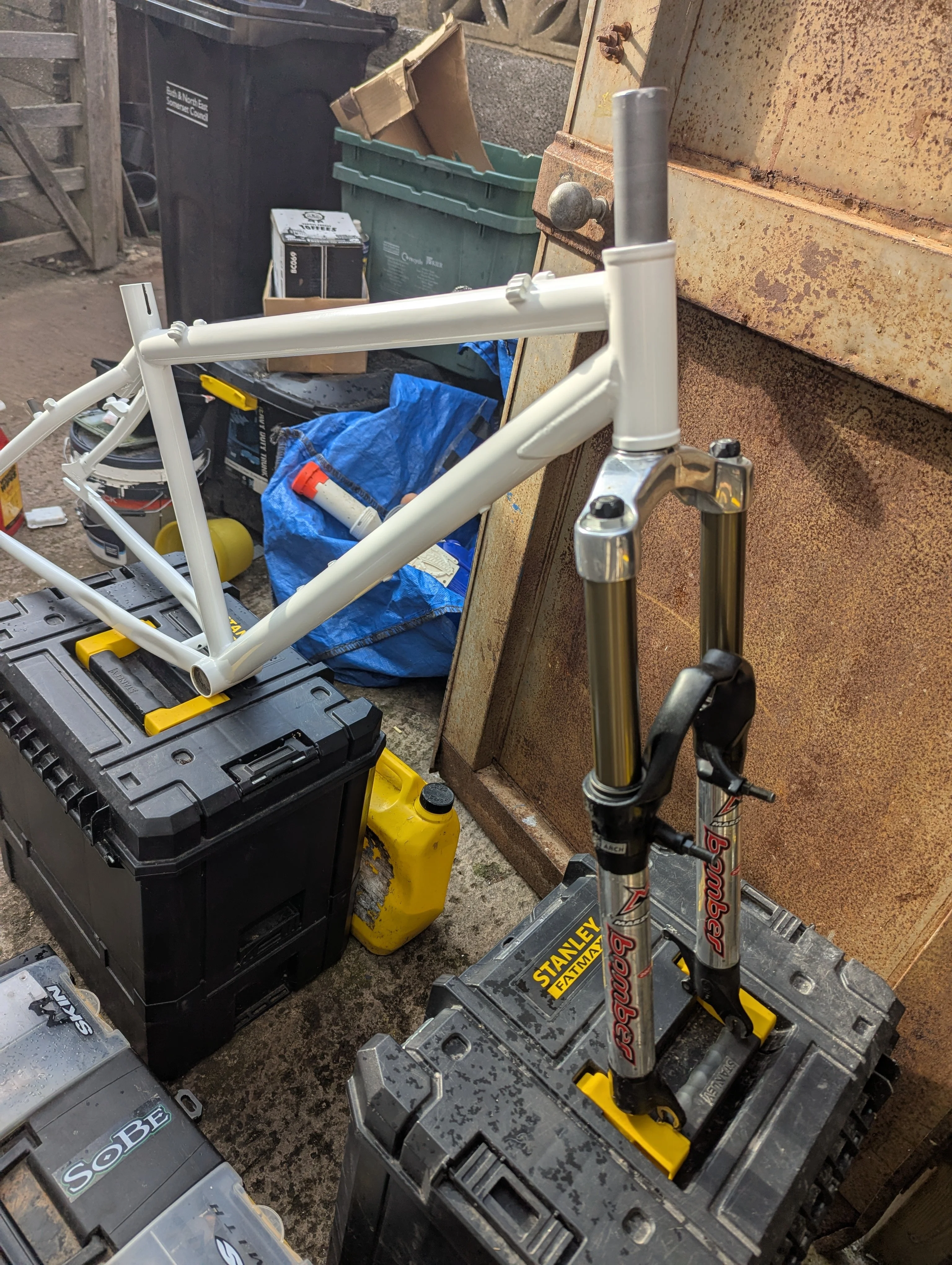

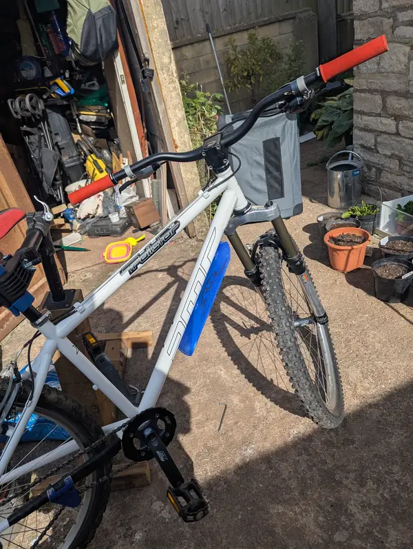

Well after finding my old abandoned project in my parents garage, i decided to take the plunge and do a full restoration/dream spec turn of millennium build.

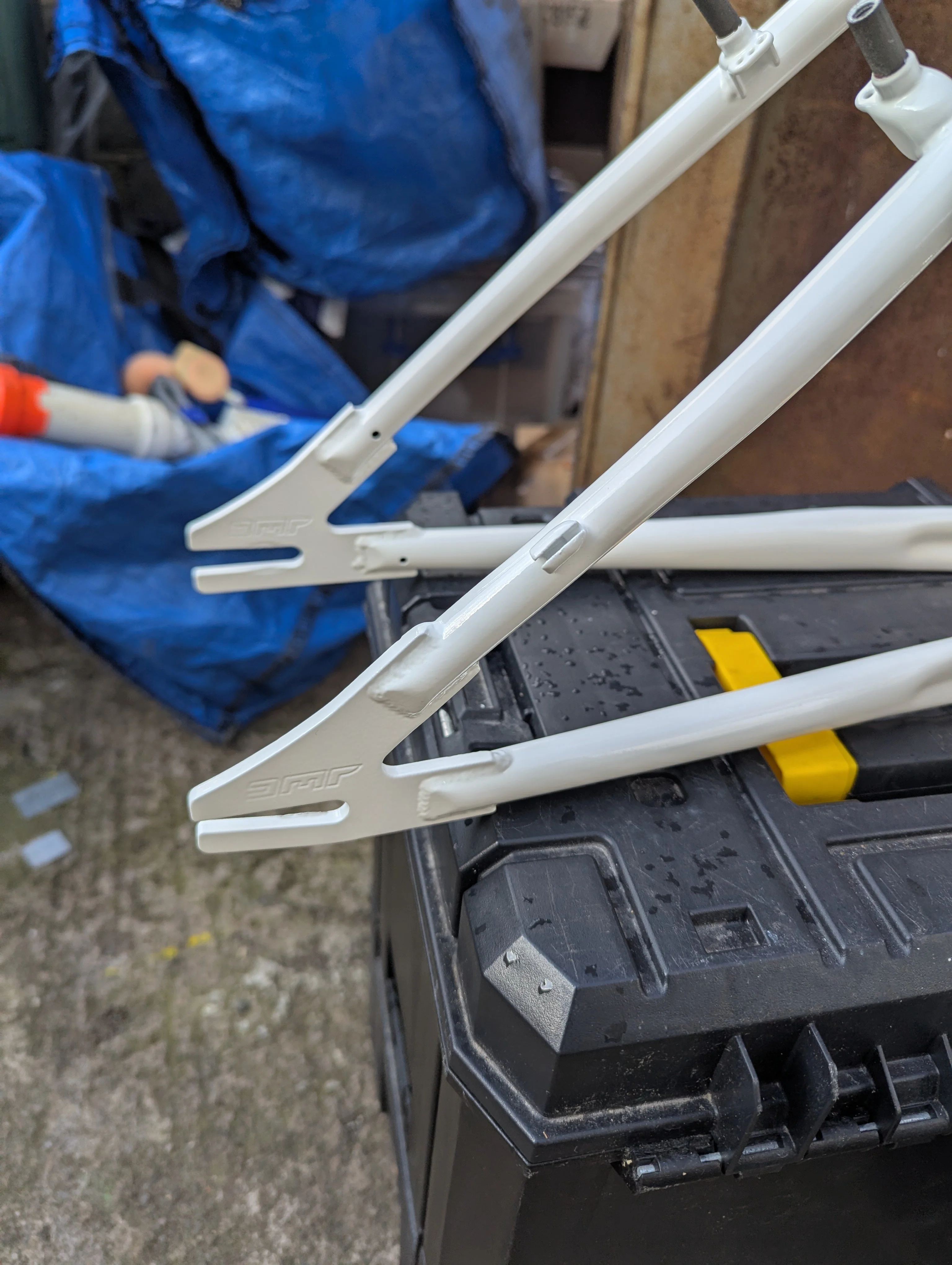

The frame it self is in fair shape, but got moth balled for 20+ years with just a coat of primer on it, so i took it to my local powder coaters and now it looks like this

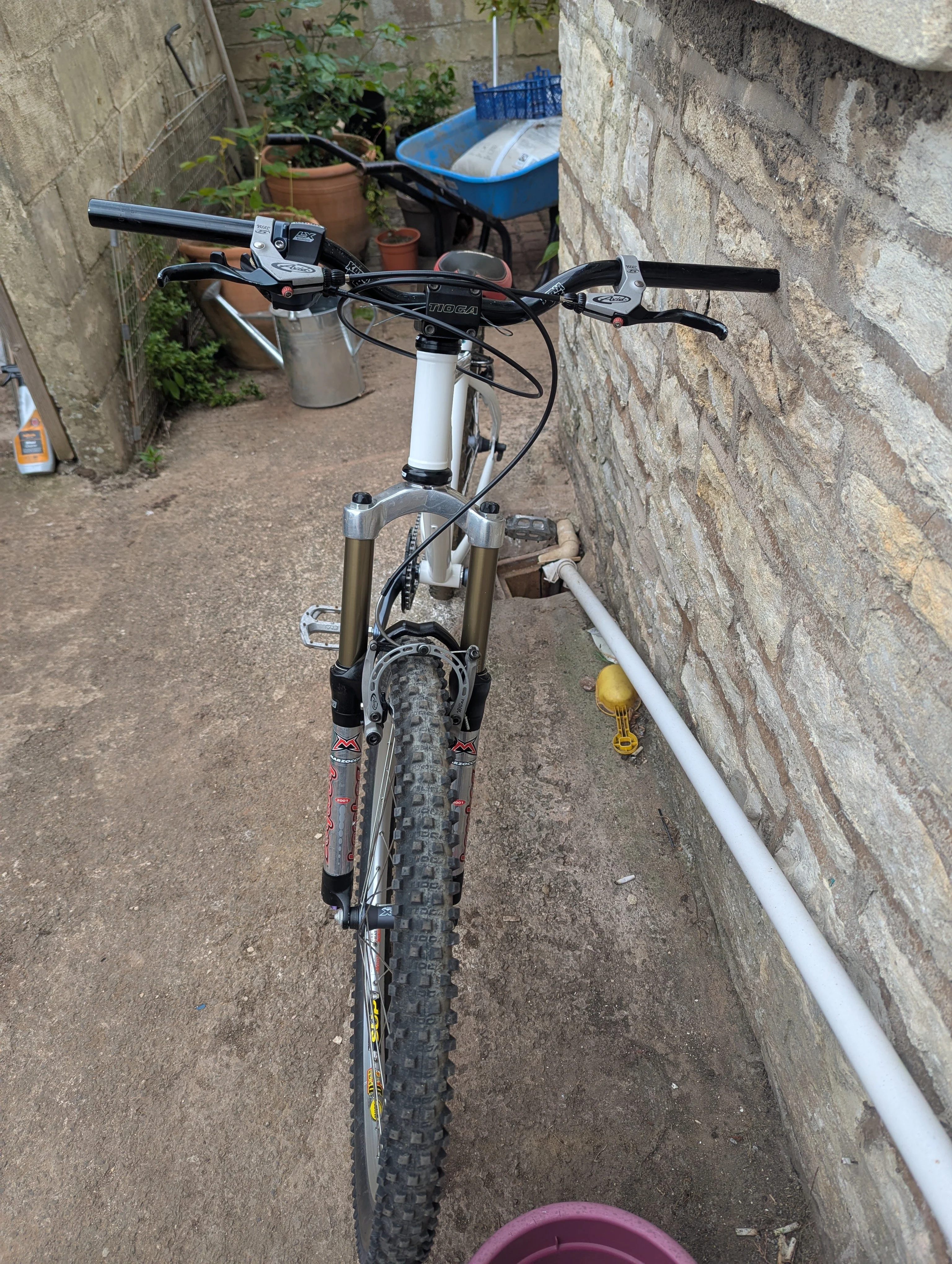

As this is essentially me building my dream bike as a teenager decided a set of '01 z1 dropoffs upfront would be ideal

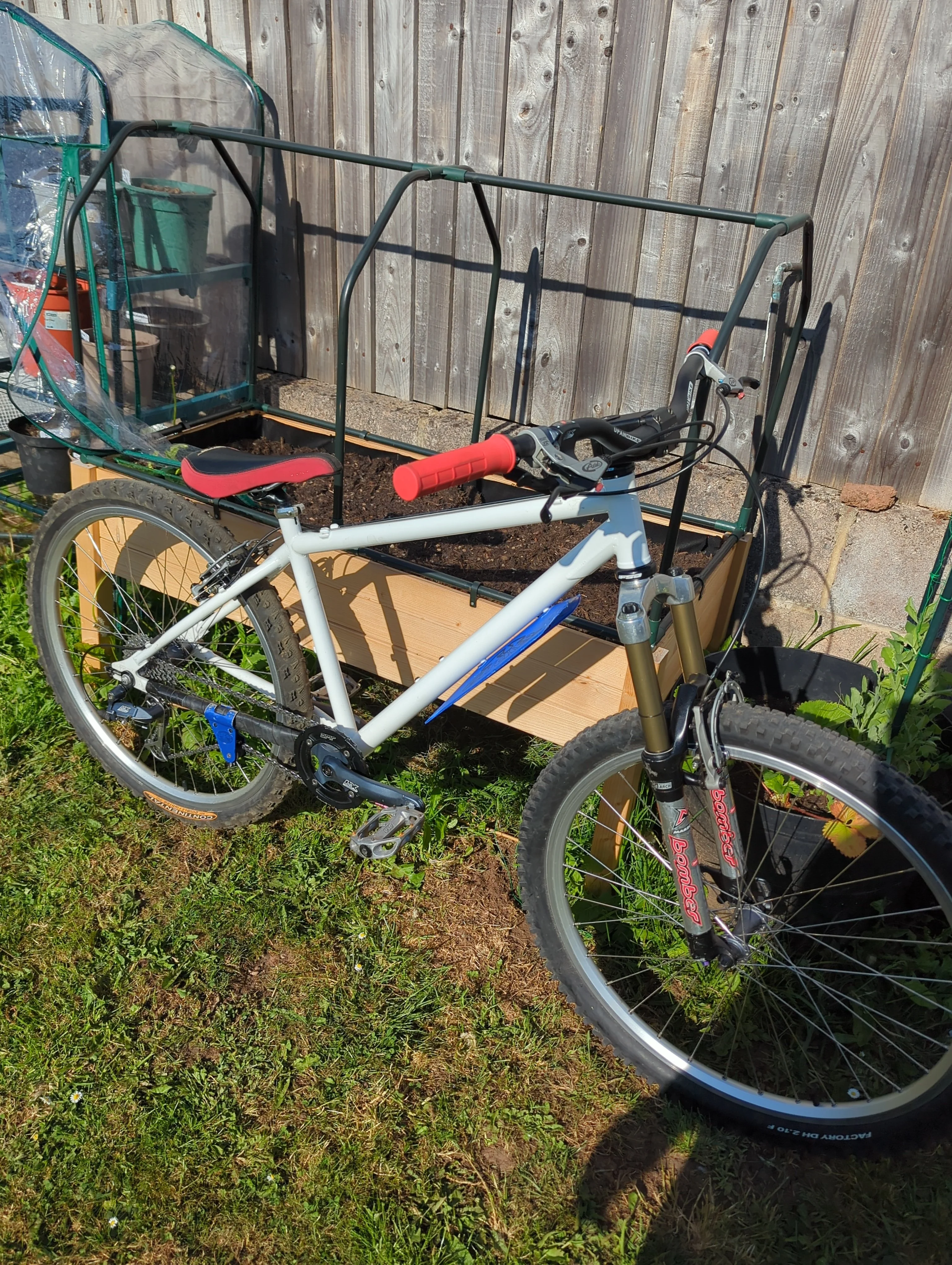

Now the question is how do i finish the build, I have virtually the full M570 ('00 LX) 9 speed groupset, but its the brakes im stuck on, discs are a no due to lack of rear mount, and i was never much of a fan of shimano's v brakes compared to avid's but im also unwilling to spend silly money (like double what they cost back in the day) on a set of arch rivals, so maybe i should go silly and put some maggy hs33's on it instead, any thoughts or suggestions?

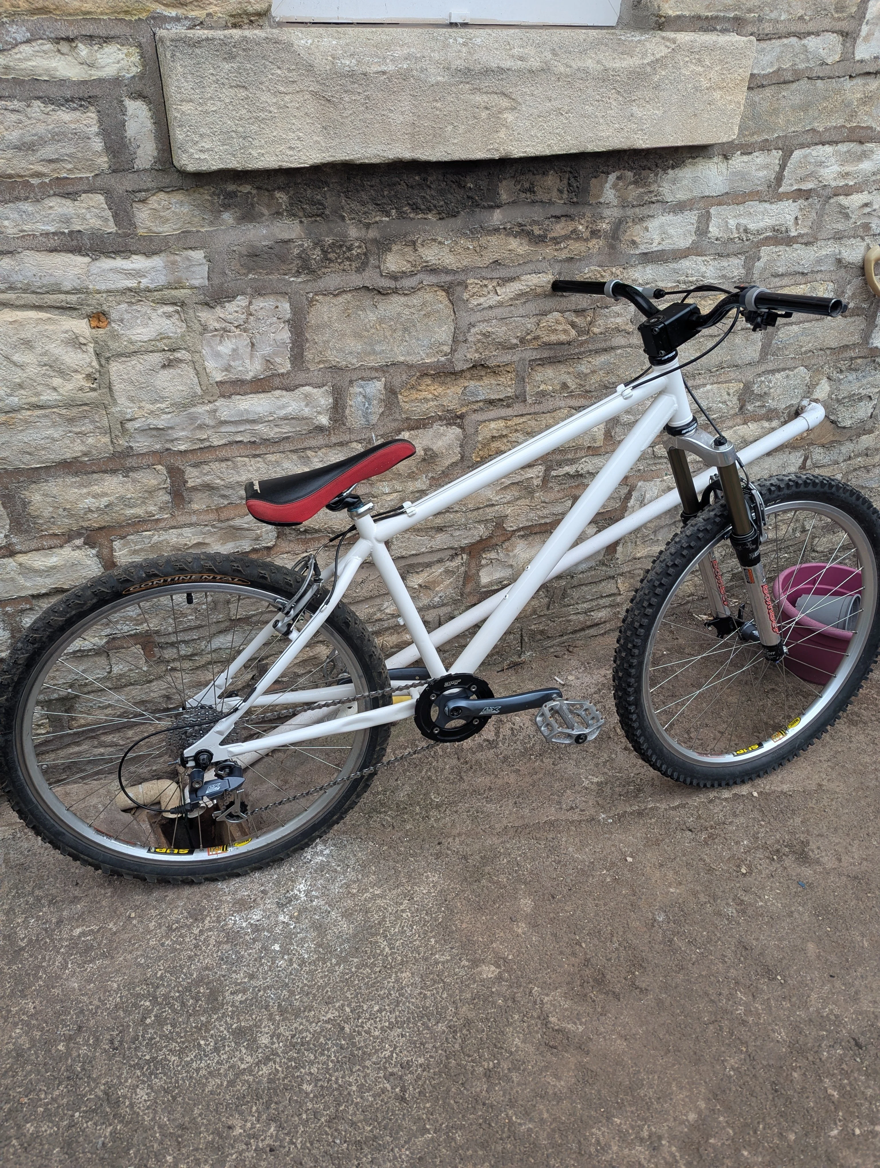

Bit of an update all but assembled just waiting on new, bolts, handle bars and grips, and then it's the decals
As it stands
Frame: mk1 DMR Trailstar
Fork: Marzocchi Bomber Z1 Drop-off (2001)
Front wheel:
Rim: Mavic d521
Hub: Shimano HB-M570 (Deore Lx)
Tyre: Tioga Factory DH 2.1
Front Brake: Avid Arch Rivals
Brake Levers: Avid Speed Dial 5
Rear shifter: SL-M570 (Deore Lx 9 speed)
Stem: Tioga DH Stem
Handlebars: generic 50mm riser
Headset: FSA Pig Pro
Bottom Bracket: Shimano Hollowtech 1 BB

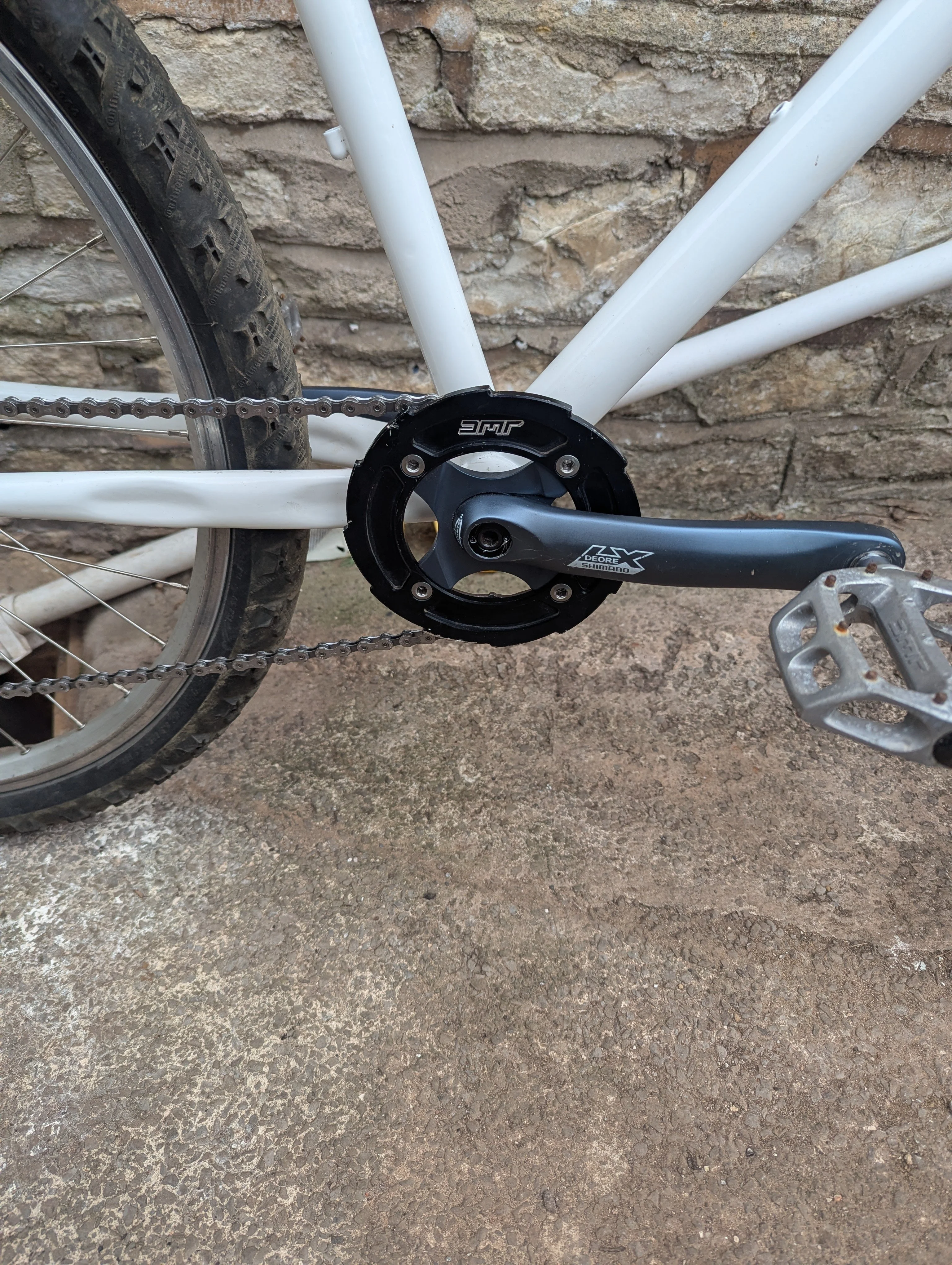

Cranks: Shimano FC-M570 (Deore Lx) standard middle chainring
Bashring: DMR bashring
Peddles: DMR v12
Chain: Shimano HG-53 (9 speed chain)
Saddle: DMR Saddle
Seatpost: Generic seatpost
Rear brakes: Avid Arch Rivals
Rear mech: Shimano Rd-M570 (Deore Lx)
Rear wheel:
Rim: Mavic d521
Hub: Shimano FH-570 (Deore Lx)
Tyre: Continental Double Fighter 2.0

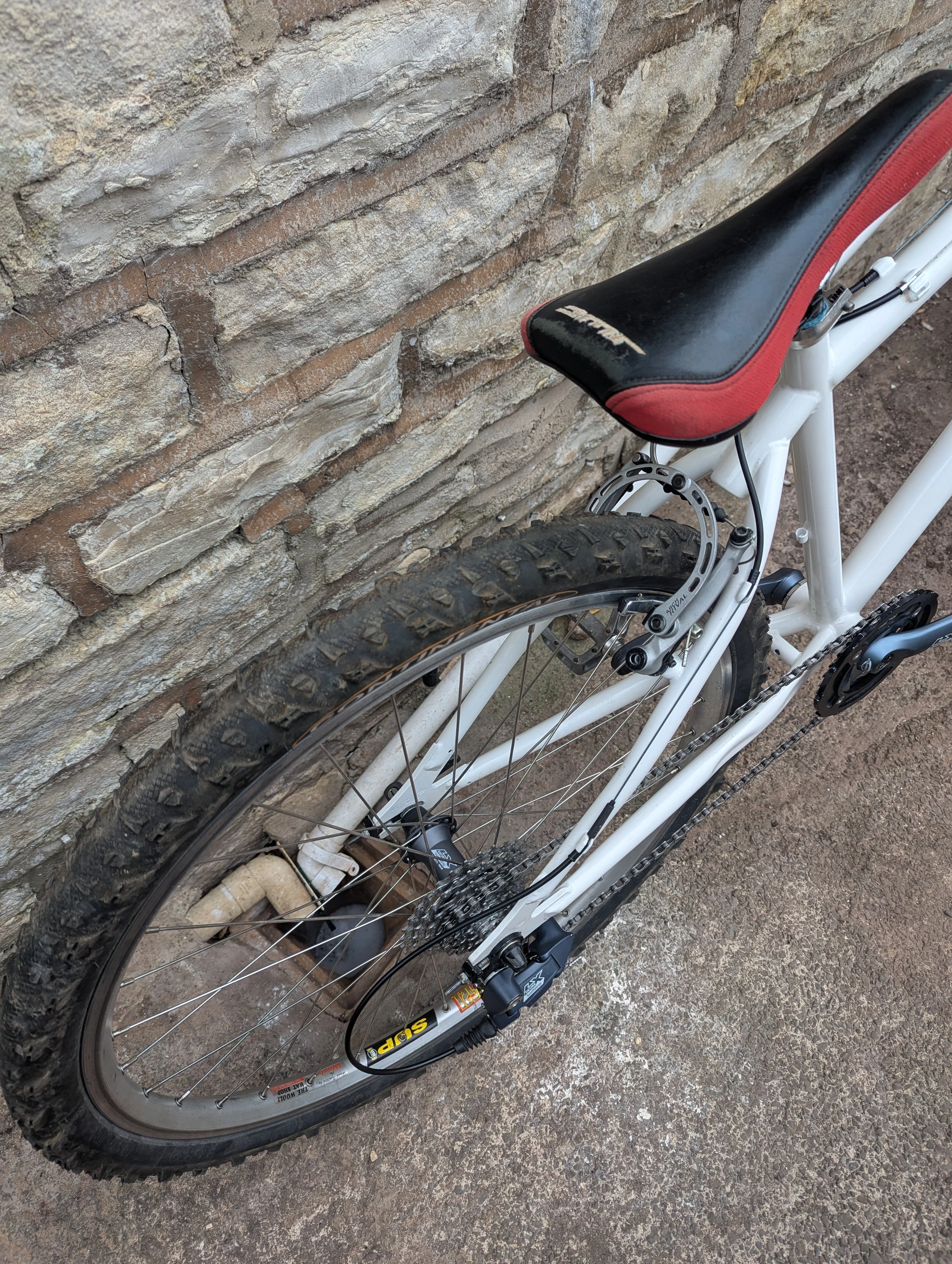

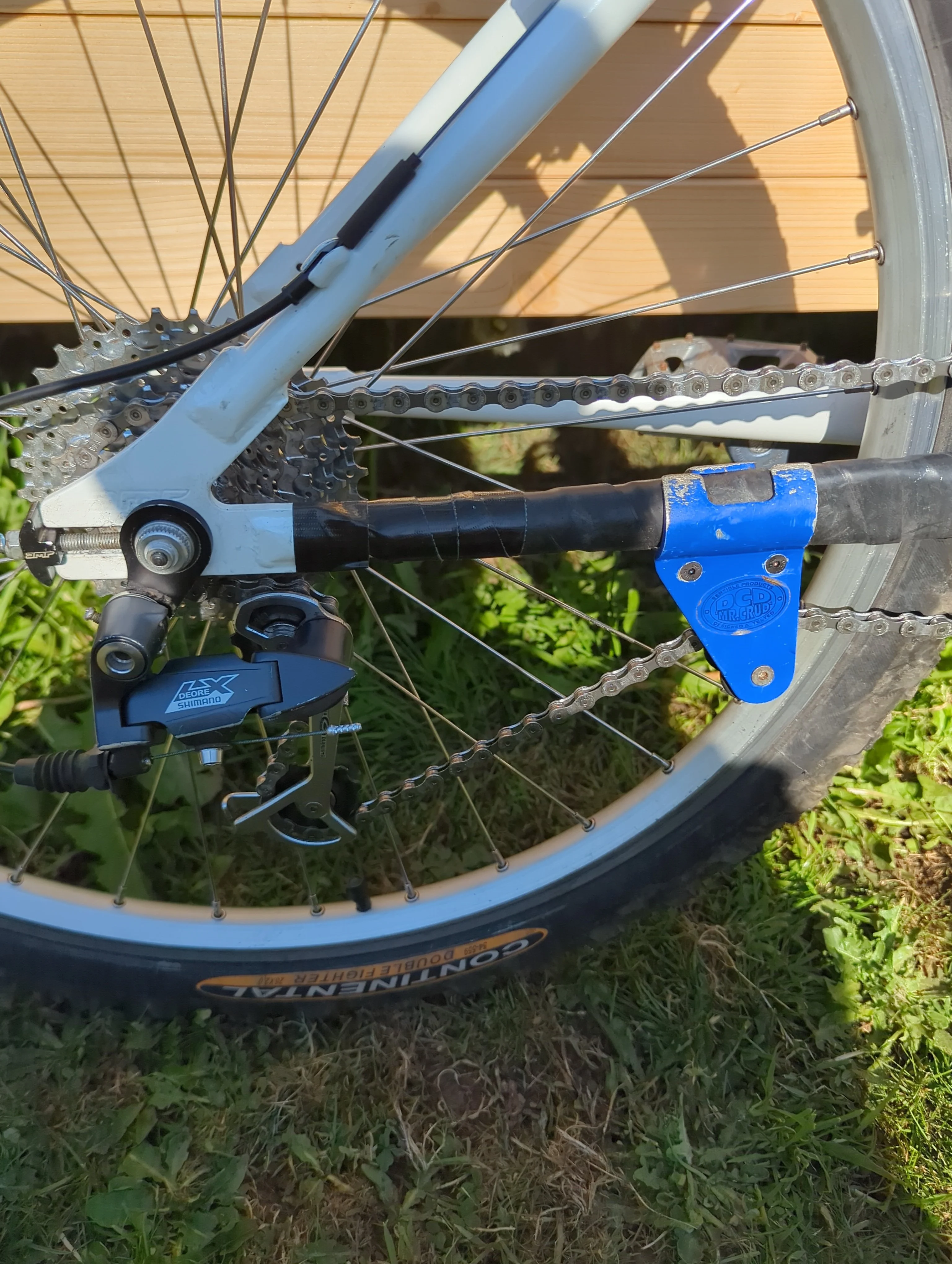

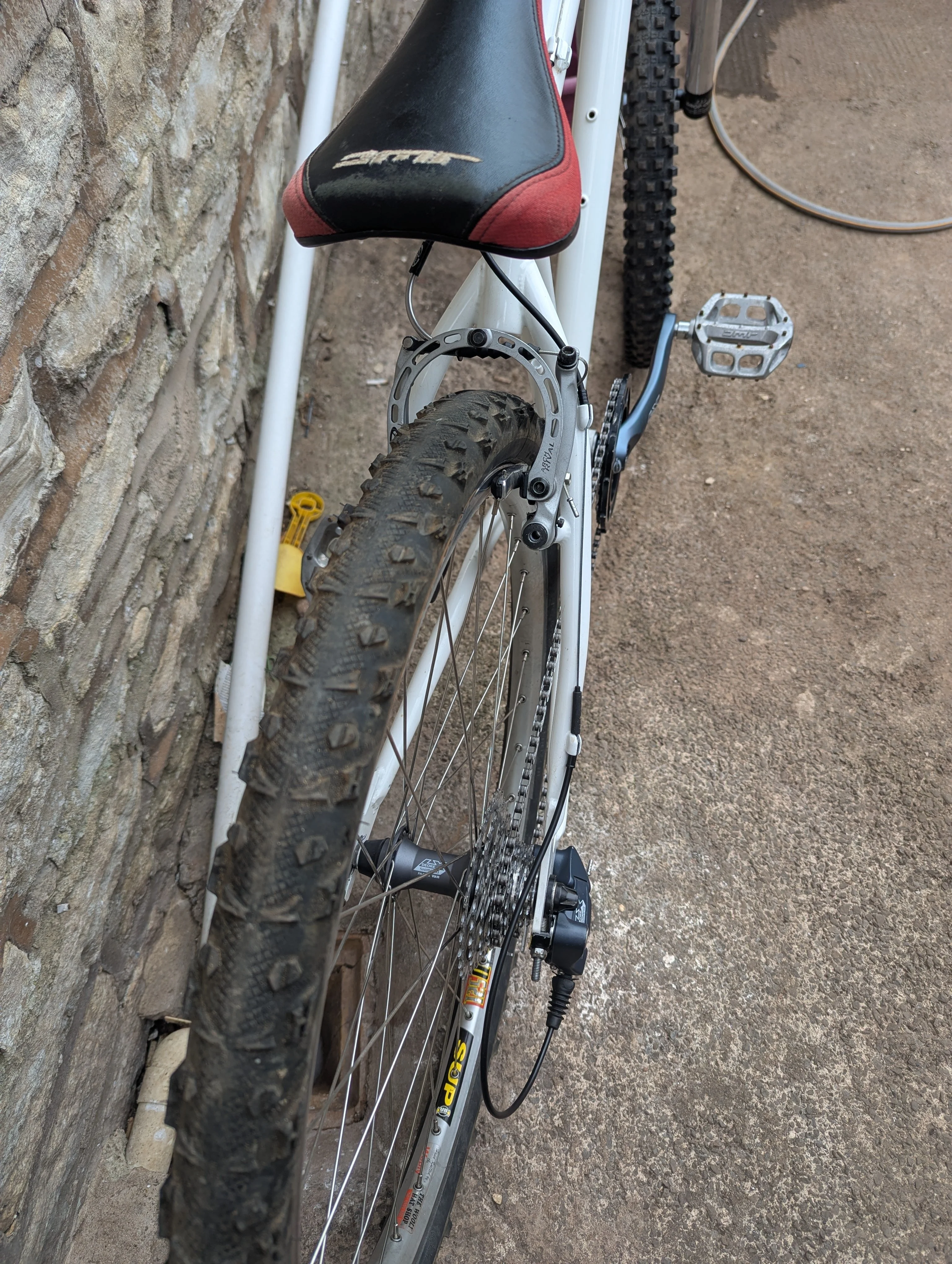

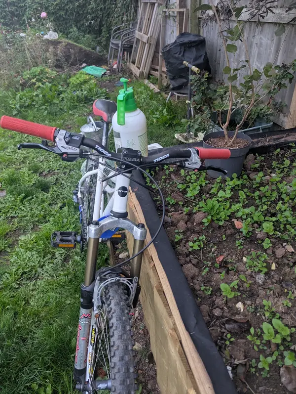

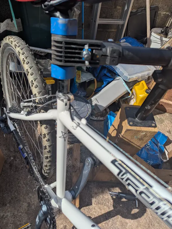

I terms of work done main job was wheel and hub rebuild, full strip down and relace of wheels followed by a rebuild, usual hub overhaul done, along with a free hub rebuild, other than that is a case of clean, service, install
the more I look at this the more I think this is exactly what I'd have built back then. possibly with a few more discount price parts chucked in like a alivio brake or something.
Funnily enough it's mostly bits i either had lying about which had survived from back then or came with the bike. The bike it self has been through 2 friends hands since new and was defiantly a mid range/could afford to replace spec build. Only real upgrade is the fork

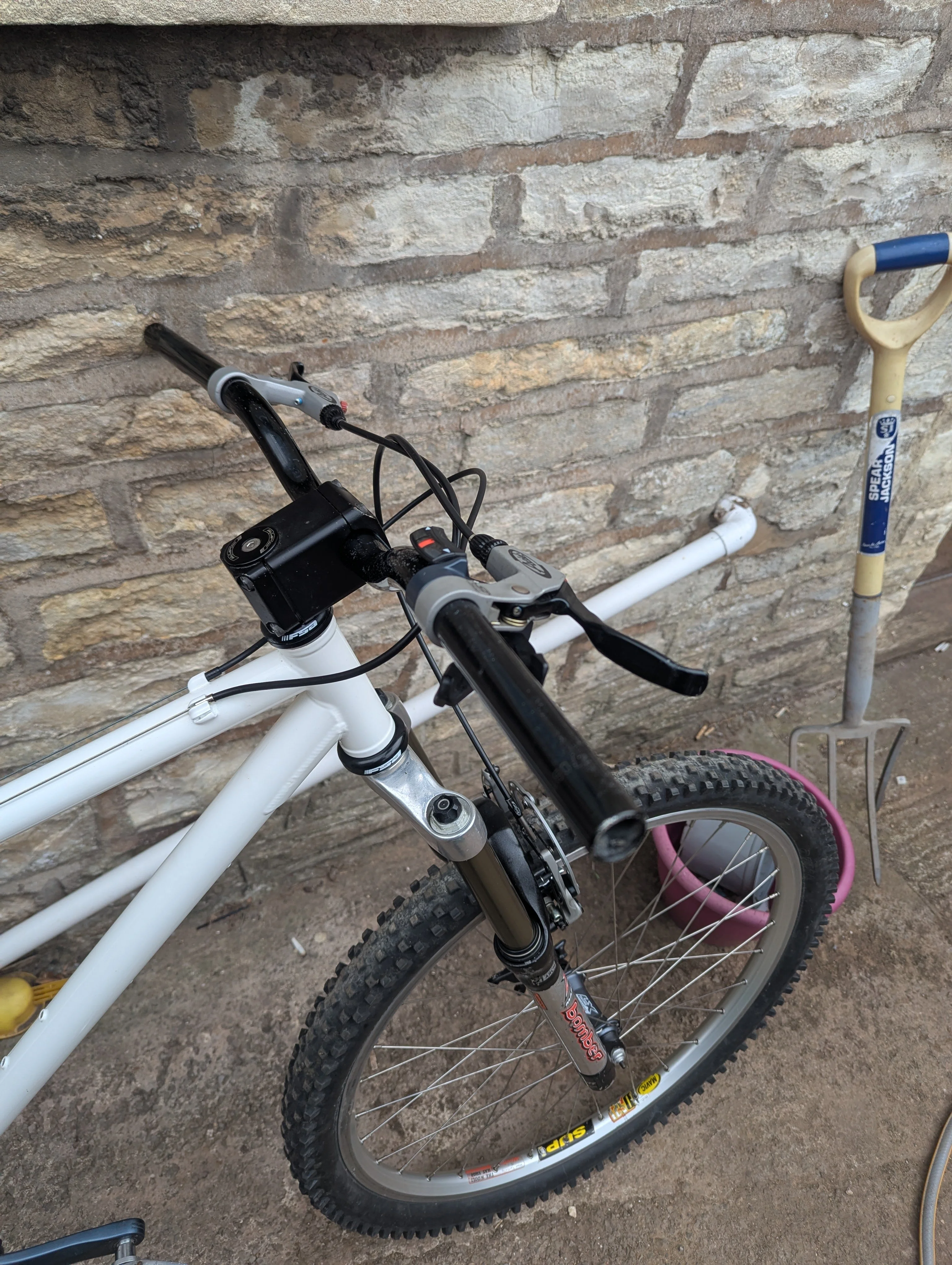

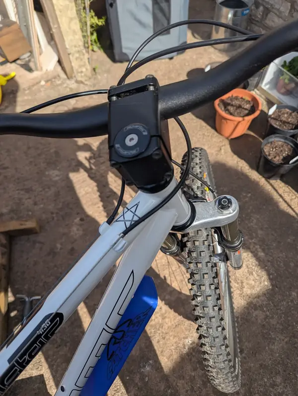

Just have to order decals, only touch of modernity on the bike is the handle bars and grips, the dcd and crud catcher at one point lived on the bike after they came off my nunu, ended up back in my bits collection thought I would throw them on just to use the dedicated crud catcher bolts and to amuse a friend (also accidentally made it VE day colours as one of my kids pointed out)

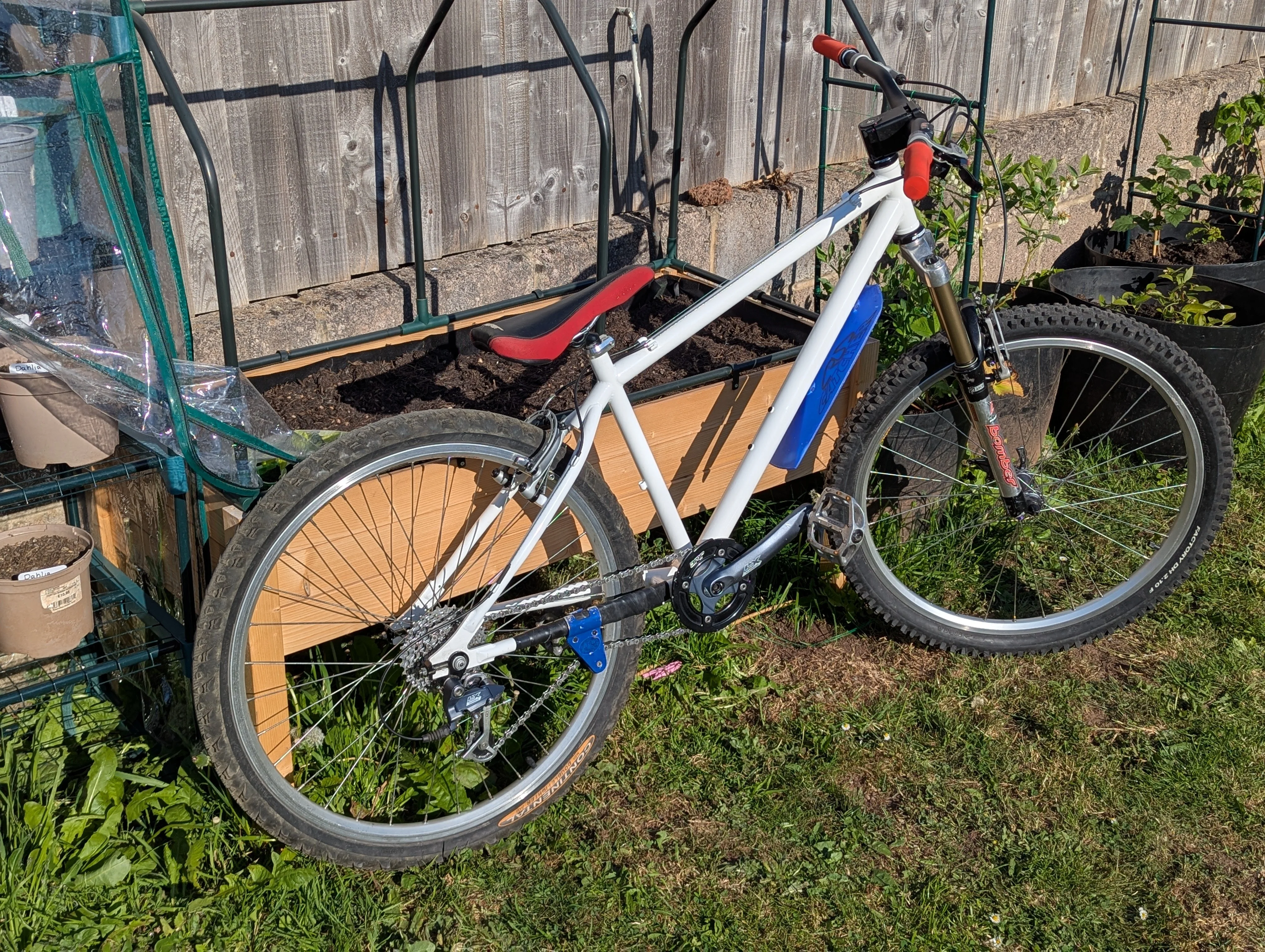

Forgot to update the thread once I made the stickers, found my vinyl cutter in storage thought I'd lost it in a move few years back, never liked the gradients on the stock decals and only had some black vinyl to hand, but quite like the end result!

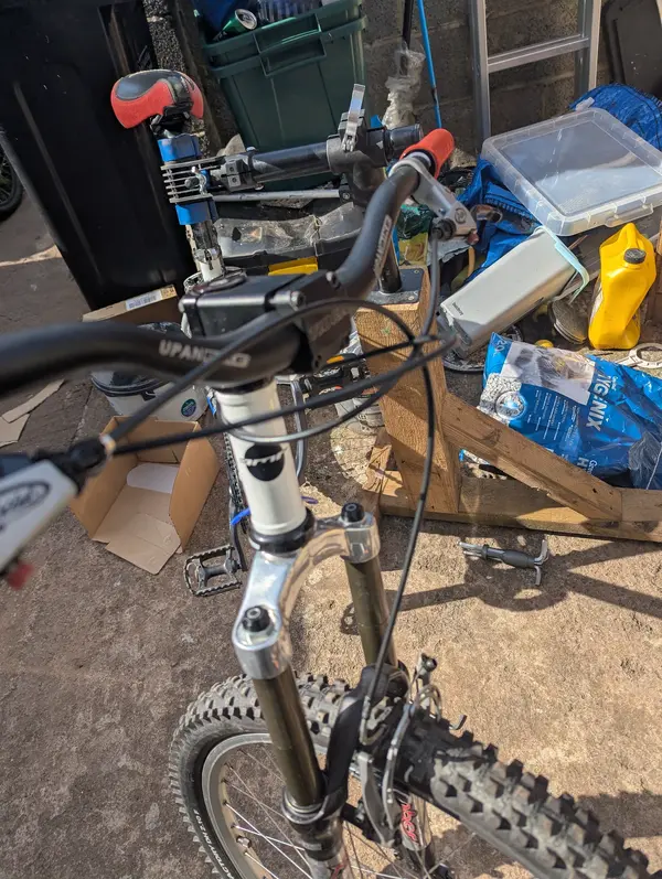

Also swapped the handlebars for something more in keeping, although I see the blueing on the brake bolts leaves a lot to be desired, ah well annother small job to add to the list....
