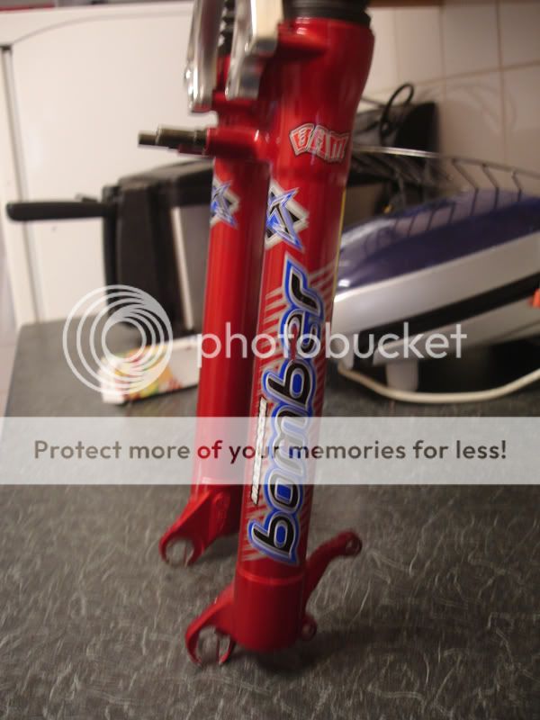

The forks have the bolt holes going in at the back, the disc caliper bolts in through the side.
I need a 'bolts in sideways' type mount similar to this:
Can't get a pic of the actual stuff at the mo...
It's a grimeca one with holes 51mm apart that would bolt into a similar mount to that BAM fork (haven't measured the distance between the holes in the fork - which I no longer have, it's just here for illustration) ..
The fork I have has holes 74mm apart and go in through the back of the fork leg..
But it says 'Post to IS' . . . the forks are post mount (same mount as the SID's in WD Pro's thread) which means the caliper is IS ??
Arse. . . .
