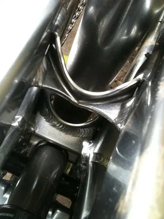

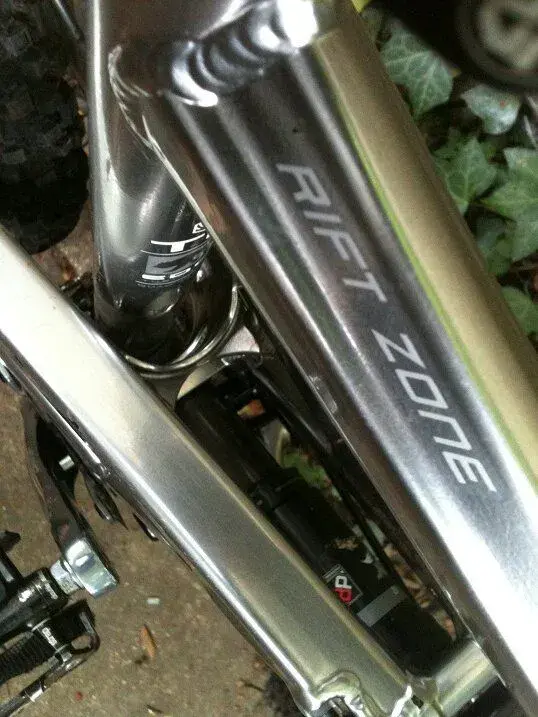

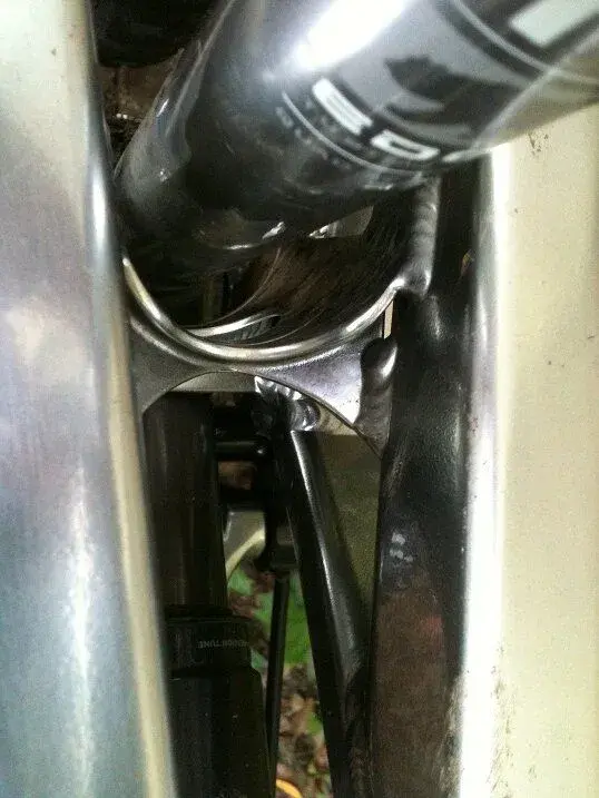

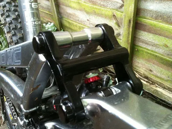

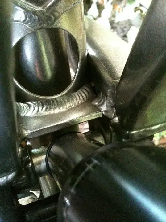

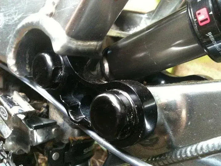

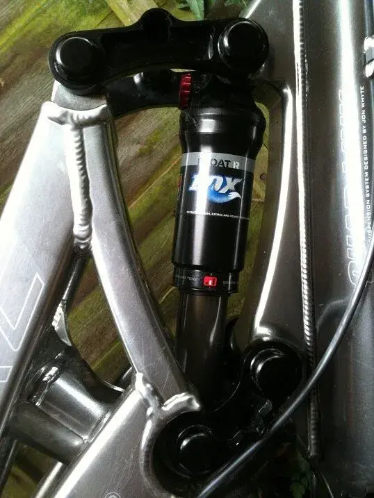

I have a theory, but not enough info to verify it. Can you take some pictures of the swingarm section? More specifically the area where the rear shock connects to the swingarm itself, near the bottom link.
On the internet I don't find pictures from the right angles. Basically I need to see it from the top, as if the camera were a few inches before the seat tube, with the lens right next to the top tube really. As long as I can see the linkage, the shock mount and any other connections between both sides of the swingarm, that'll be fine.
I'm thinking that the connection between both sides of the swingarm simply isn't strong enough there.
Based on what I can tell from pictures and videos of that version of the quad-link, most of the strength in the bottom section of the swingarm appears to come from the bolt that holds the shock. In that case, any wear of the bearings would allow flex.
The top connection between both sides is merely a single tube. A single tube of that size can twist easily under the forces that the swingarm is subjected to under lean. Normally the bottom mount would prevent this from happening, but a little play there will allow quite a bit of movement near the dropouts.
Pics of the linkage/rear shock area...

When looking at the rear wheel it does appear to flex what I would say is quite a lot! When i grab it it moves maybe 5mm each way! Also dispite the wheel running true the spokes seem at differing tensions... The wheels were built then not used for some time before I started to ride on them. Is it worth a re tension of the spokes? How easy is this to do without effecting the dish of the wheell or would I just be better off taking it to the LBS?
If they are evenly un tensioned, just quarter turn each nipple all the way round. May throw it slightly out of true but not always.
