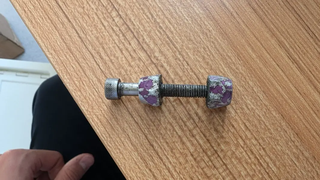

- The only bit of original color I have is this anodisation from the seat tube bolt which seems more to the pink than the purple, which would again indicate 1993 as opposed to 1994.
Now the seat tube could have been changed for an older one, the the fork might have been a Manitou 2 added to a 1994 team issue, and the bolt color might be 1994, I don't know ...

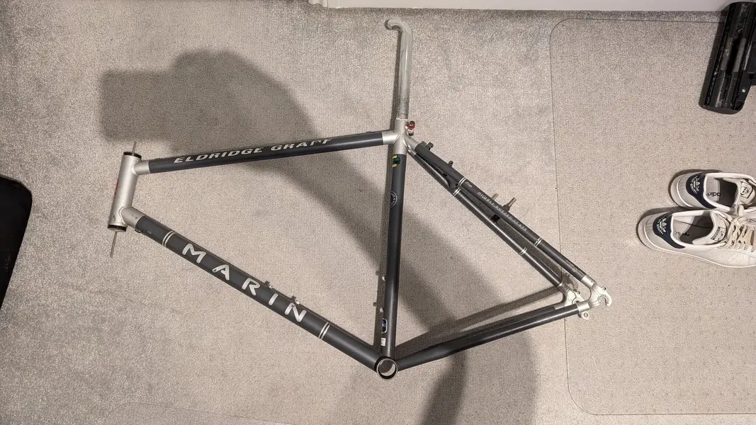

Another contribution of mine (now going through all the Marin frames I bought after getting the retrobike itch on this forum..):
Eldridge grade 1993 (allegedly!) with code M63BAD033

Team Marins and Team Issues were Tange "Superlite" or Ultimate frames / tubes. Models like Eldridge Grade etc. were a completely different (more low end) tube-set.
