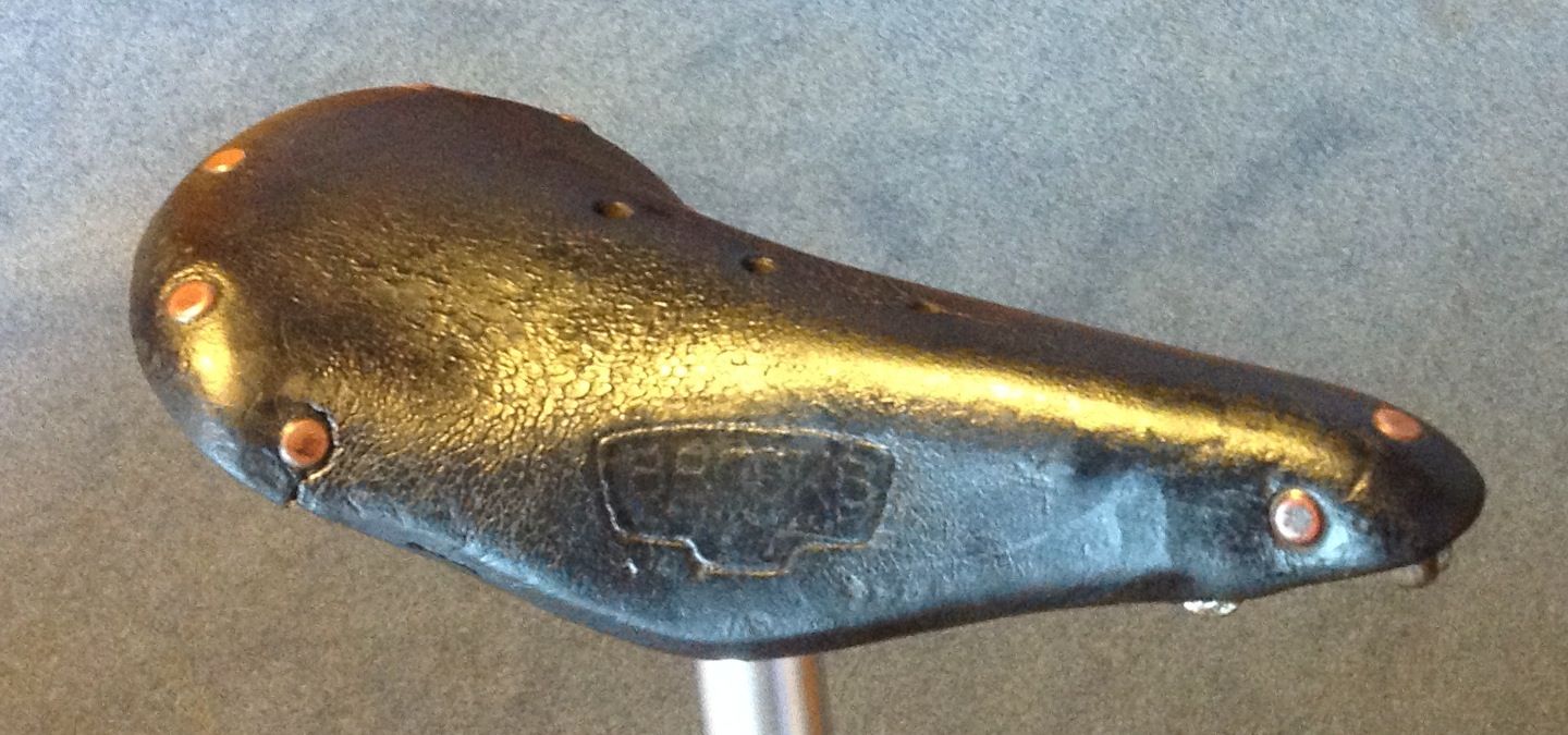

Fully stripped. Brakes are lovely. Springs are very firm. The post bolts each released with a scary 'crack' the sounded like they'd snapped. Bars I was karma'd are fantastic. Will use father in laws 53 brooks saddle. Not sure what tyres will suit. Other than choosing tyres and grips and a lot of part cleaning, I don't anticipate any more issues.

After digging out the saddle, had a bit of a stock take. I think I have just about everything.
