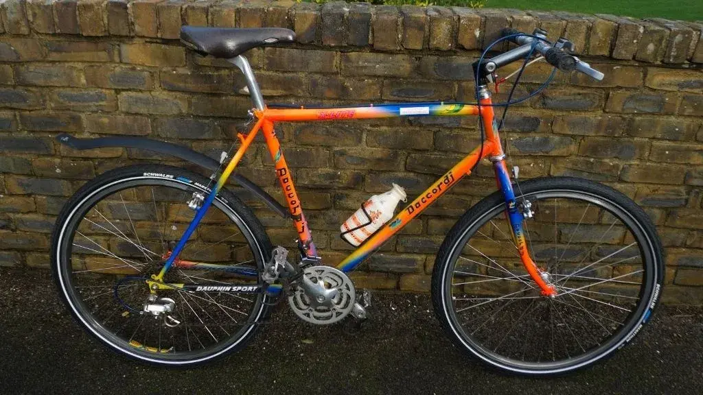

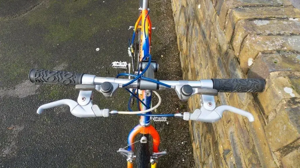

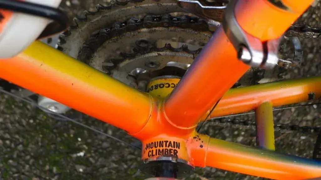

At the moment the frame is still in its bike box so, sadly, no further forward in terms of being built up. However, matters have progressed in other ways and in terms of how to build it.
The “tease” I mentioned, in my last post, was that I had bought another Daccordi mtb, a conventional frame “Mountain Climber”. Fully equipped with Campagnolo Euclid/Centaur it appears to date from 1989.
Having now got a model to work from, being unfamiliar with Campag mtb stuff previously, I decided the Daccordi E frame should have the same. So, various E-bay deals later, I think I have most of the Campag components to build the E bike up. I have had wheels built using a pair of Campag Chorus hubs I had in stock. These are road hubs, but I am sure will be fine for the sort of towpath riding I do. Rims are Mavic X517 CD with a smoked grey appearance.
Interestingly, The Mountain Climber had full Campag except the rims which are Mavic. Why not Campag mtb rims ? They were available. In having the wheels built for the E frame, I was told Campag mtb rims are notoriously difficult to fit tyres to and Mavic’s are recommended.
Well that is it. Come back in another 4 years and perhaps I will have finished it !
Thank you for your interest.

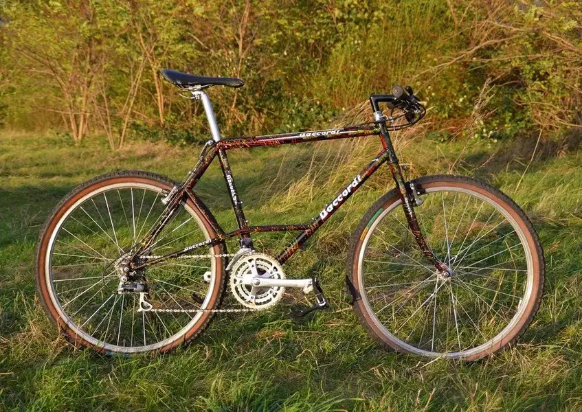

Wow ! Another Daccordi E frame. I wonder how many they made. What does ECS mean ? Thanks for the link to the other website. It translated ok. I see he went with a Shimano build; that was probably quite sensible.
