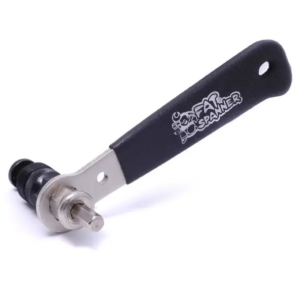

My linked page has gone 404 so just popping a pic of the tool up. Cant go wrong for £12 or so. Owned/own and used many, this is the best i have found :)

Comparing my Park Tool to my Fat Spanner and why i recommend the Fat Spanner is that i prefer the handle on the Fat Spanner to the Park, it fits better in my hand, is soft padded so does not dig in on stubborn cranks like the Park one does, it is also not fixed which makes a huge difference, i can tighten down the inner spindle and then move the handle around to any position to gain maximum leverage, unlike the Park which is fixed in the position it comes to rest in, not useful if that is parallel to the crank or turning it puts it in that position.
Also the CP22 is for square taper cranks, fine but even on some bb's the pin can push into the bolt thread hole, also more importantly it does not do the bigger newer cranks, unless you stick a washer in or something, the CP44 is for those, the Fat Spanner has the removable pin like in cheaper tools that works on newer bb's. also it has an allen key on the other end for the crank bolt, all useful and less faffing imo :)
