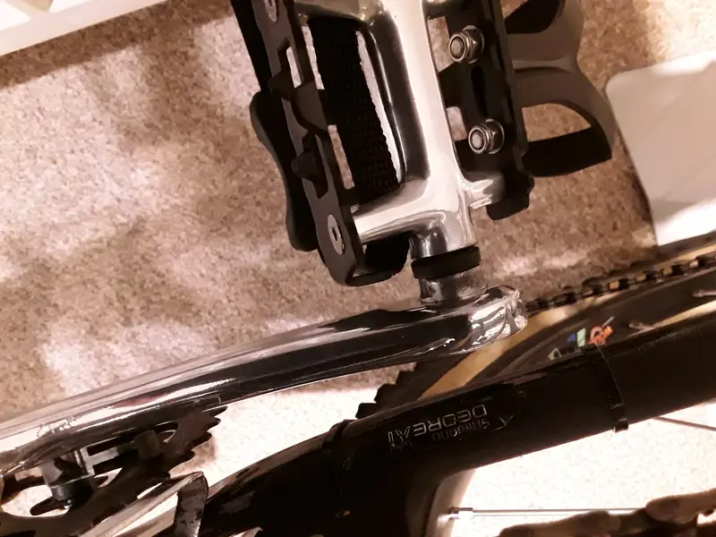

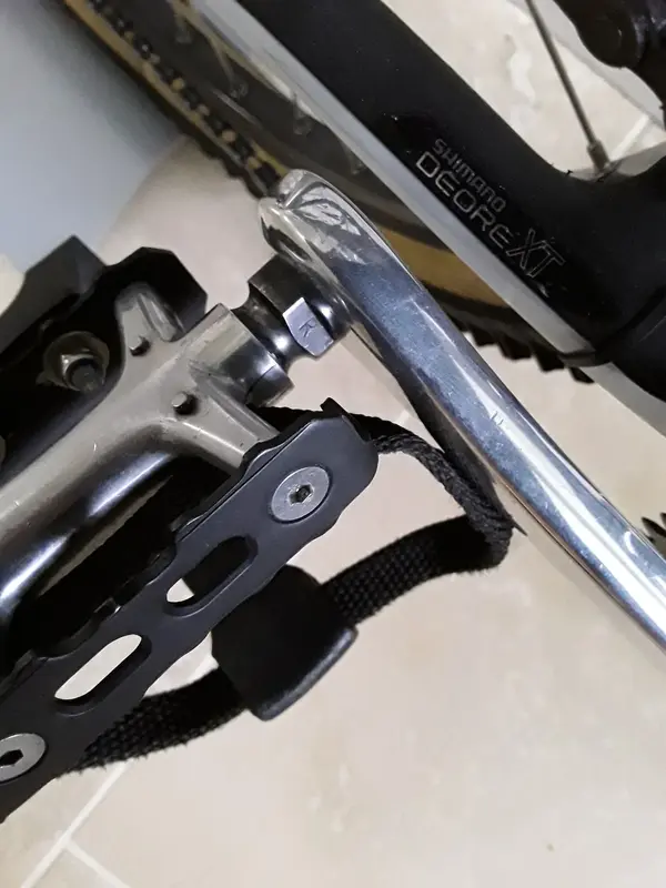

1st pic is m730 chainset on 122.5 asymmetric cup and cone. 2nd is same on 122 symmetric sealed modern bb. Bugger all difference in reality.
