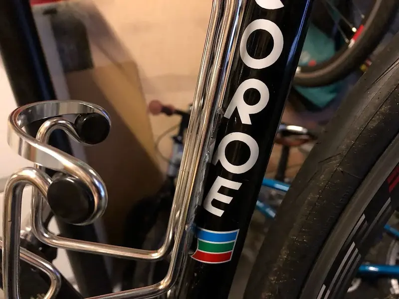

The frame only had one bottle cage so I added another. I did this after decaling otherwise I would’ve needed to cut the decal around the new bosses. These were added with a nutsert tool. Alloy nutserts because I don’t have an air-powered tool (stainless are also available but can’t be installed well with the hand tool. They will feel firm at first but quickly start to spin). I used a good blob of copper grease around each one, I do this on all my bikes when putting dissimilar metals together.

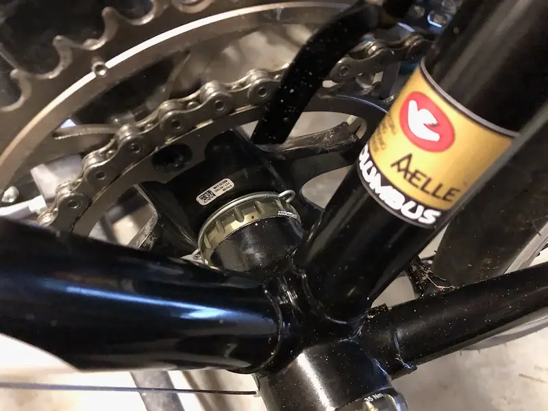

Ultatorque shells installed, actually go quite nicely with the Aelle label. Italian thread so I’ve marked the drive side to spot if it moves through precession. Again, using my wife’s ceramic pens.
Excuse the dirt, took it for a shakedown spin.
