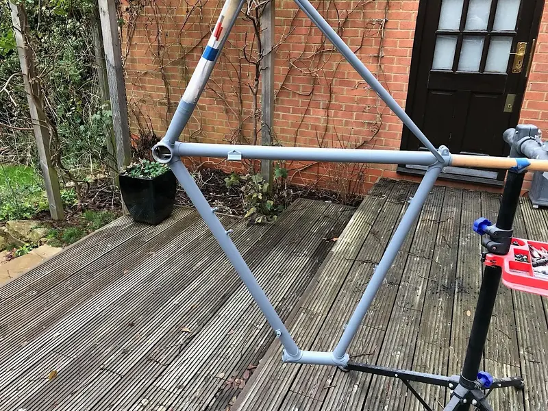

On its way to a full coat of primer, standard broomstick method to give 360 degree access.
One benefit of pandemic-enforced working from home, I was able to pop outside every half hour to add another coat.

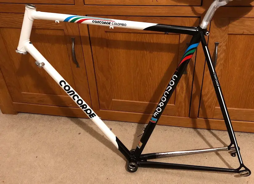

Now I got a bit excited with the painting and forgot to take any in-progress photos, so here’s the finished result. I bit boring I’m afraid, the inevitable PDM scheme.
Paint was Halfords enamel paint, so much tougher than their regular car paint, each colour applied in a morning and left to bake in front of the radiator for the rest of the day. Another benefit of the enamel, it doesn’t smell once touch-dry.
The Columbus and seatstay decals were added before the clear coat (not UV stable) and this was given a good fortnight in front of the radiator. Then it was sanded flat with progressive grades of micro mesh, rubbing compound then t-cut. Probably the best rattle can job I’ve ever done and I’ve done a lot!
By chance the other decals arrived from Cyclomondo in Australia the day after this process was finished. Lucky because I might have been tempted to fit them straight away otherwise. They went on a treat and I understand they don’t need a sealing coat. The seatstay stripes were made with 3mm vinyl pinstriping, Amazon special. I’ve still got 9m of this left for emergencies!

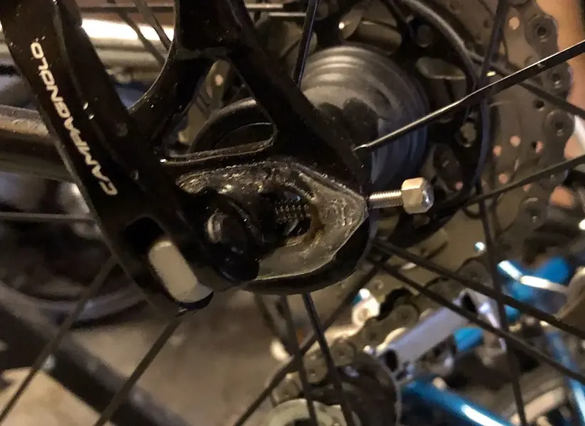

Some notes on the previous photo:
Headset cups reinstalled. I’ve got a bearing press but a squeeze-clamp is so much easier, I always fit cups with this.
BB cups installed, Campy Ultra Torque. I’ve fit a few of these and never failed to mark them, despite using Campy’s own tool. And why are they gold? They must be the only gold component on 99% of bikes they’re on!
The eagle eyed will notice that, a) I did a better job masking the dropouts than Concorde’s painter did and b), the adjusters are missing. After the paint job they just looked messy. One came out fine with a bit of WD40, the other snapped off at both ends. Out came the drill - it must’ve been totally rotten because the drill stayed on track easily and I just had to run an M3 tap to clean it up. So satisfying to see the tap push a load of brown muck out of the end leaving gleaming threads. It now sports some nice new stainless versions and a bit of scalpel work tidied the paintwork.
