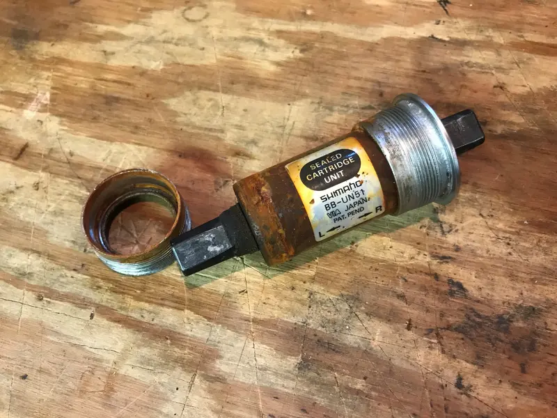

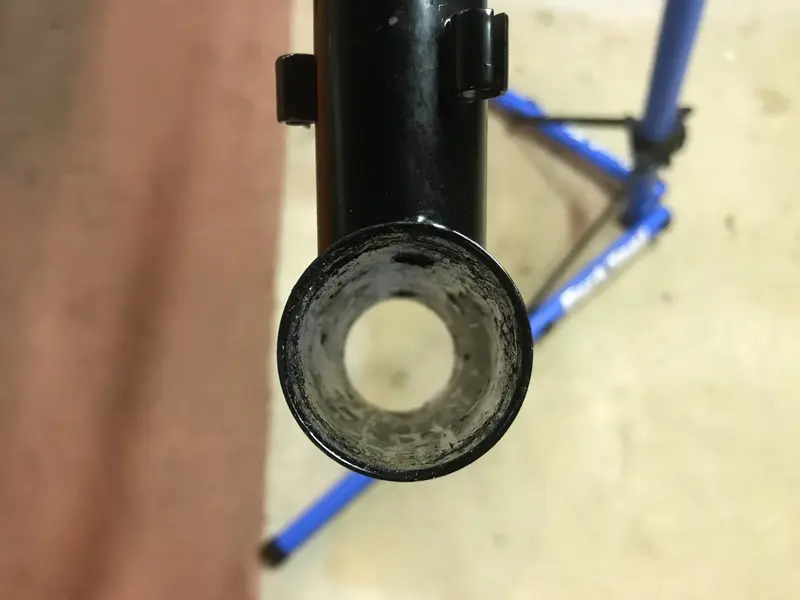

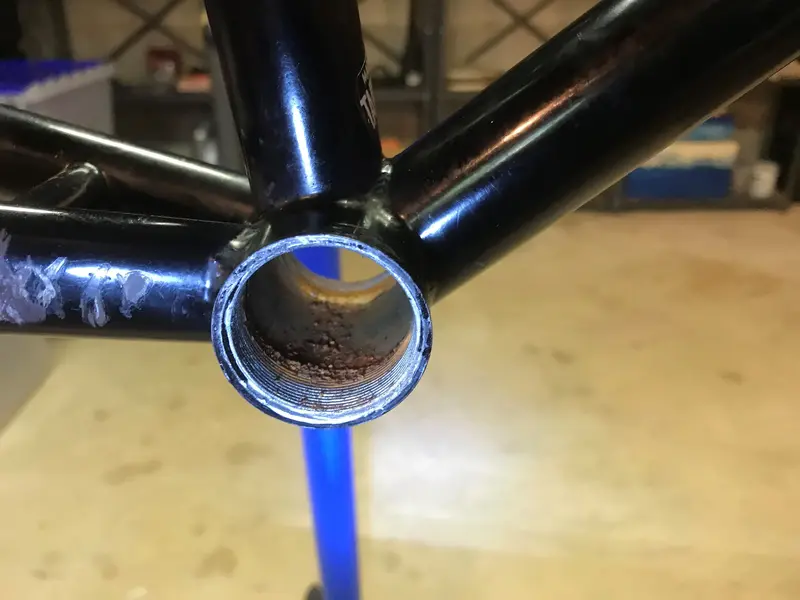

Hi, starting to go through this Axis Pro frame, amazed how LITTLE ruse is inside. Seat tube (no pic, sorry) is nearly spotless. Bottom bracket has a bit. Head tube is mostly rust free, just some grease. Clearly this bike was taken care of and stored indoors. What I should be doing to remove what rust there is and treat / preserve the innards. Thanks!
EDIT: the BB cartridge cleaned up nicely and the bearings feel great.

Once I've given the open accessible areas a good tinfoiling on an old coat hanger in a drill, blow out frame with airline, tip in bottle of "crust" or other proprietary rust killer ( having plugged all but entry hole), tip it about for 10 mins, empty out through button bracket, leave to dry for 2 days, spray inside through any holes with ACF50 and straw, give good soak, leave for another couple of days for excess to run out bottom bracket ( stand it in an old baking tray).
Its the same method we used with classic motorcycles. Sees to work a treat at killing any rust and protecting for the future as best you can.
Same process as above apart from I used cheap engine oil. I blocked up all the holes apart from the seat tube and poured some in. Stuck a rag in to seal it and spun the frame back and forth to coat as much of the innards as I could.
Now I squirt WD40 in instead as it doesn't take as long to 'dry up' and stop seeping out but it seems to have been effective.
